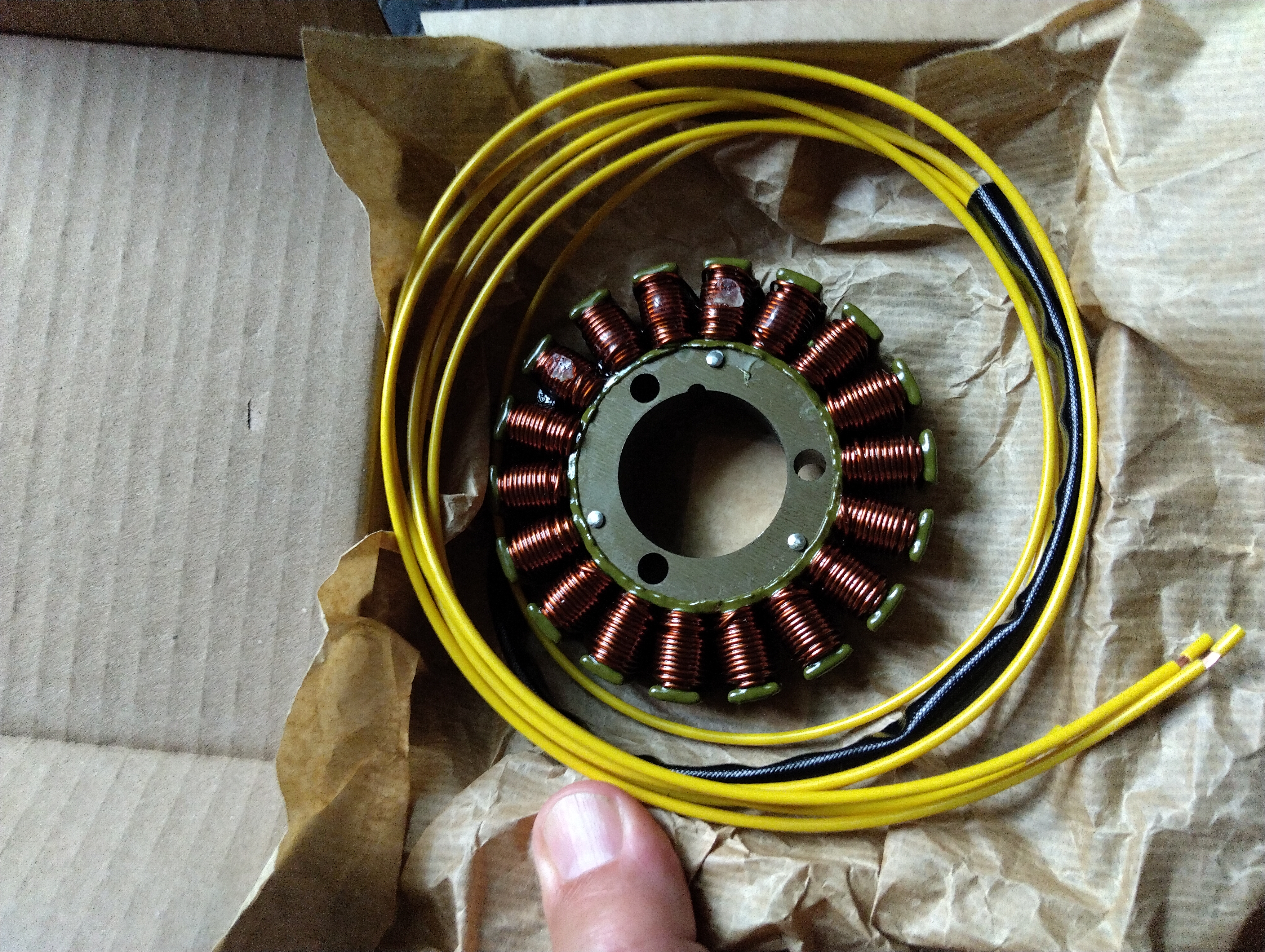

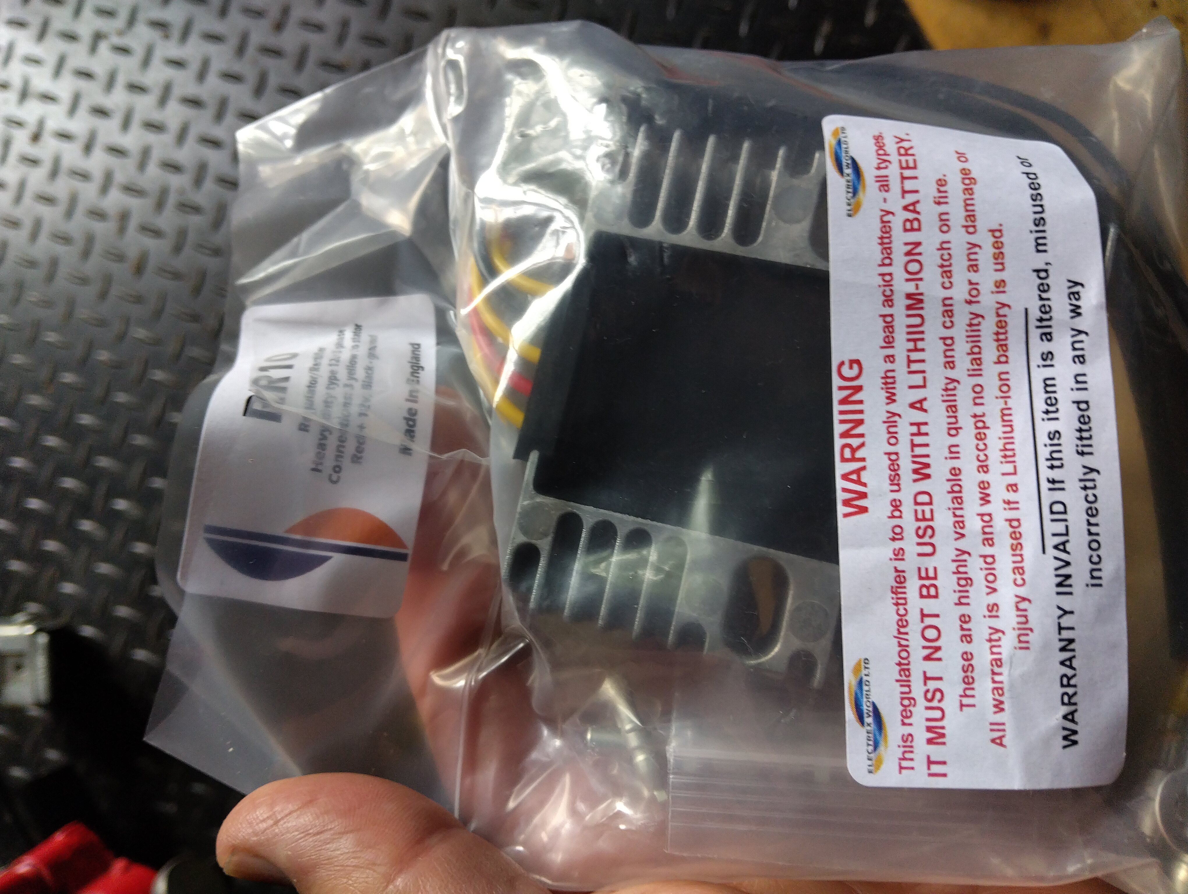

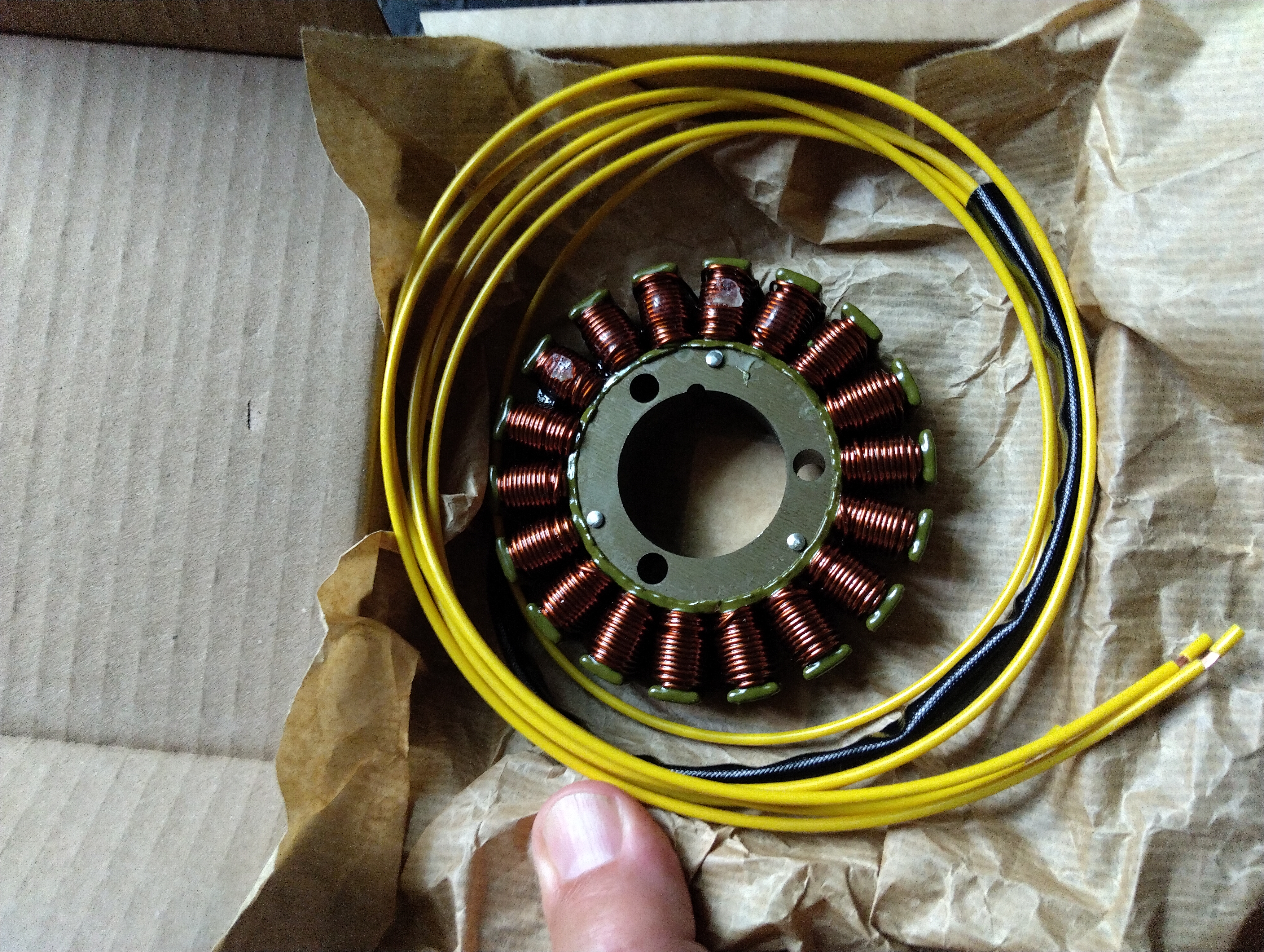

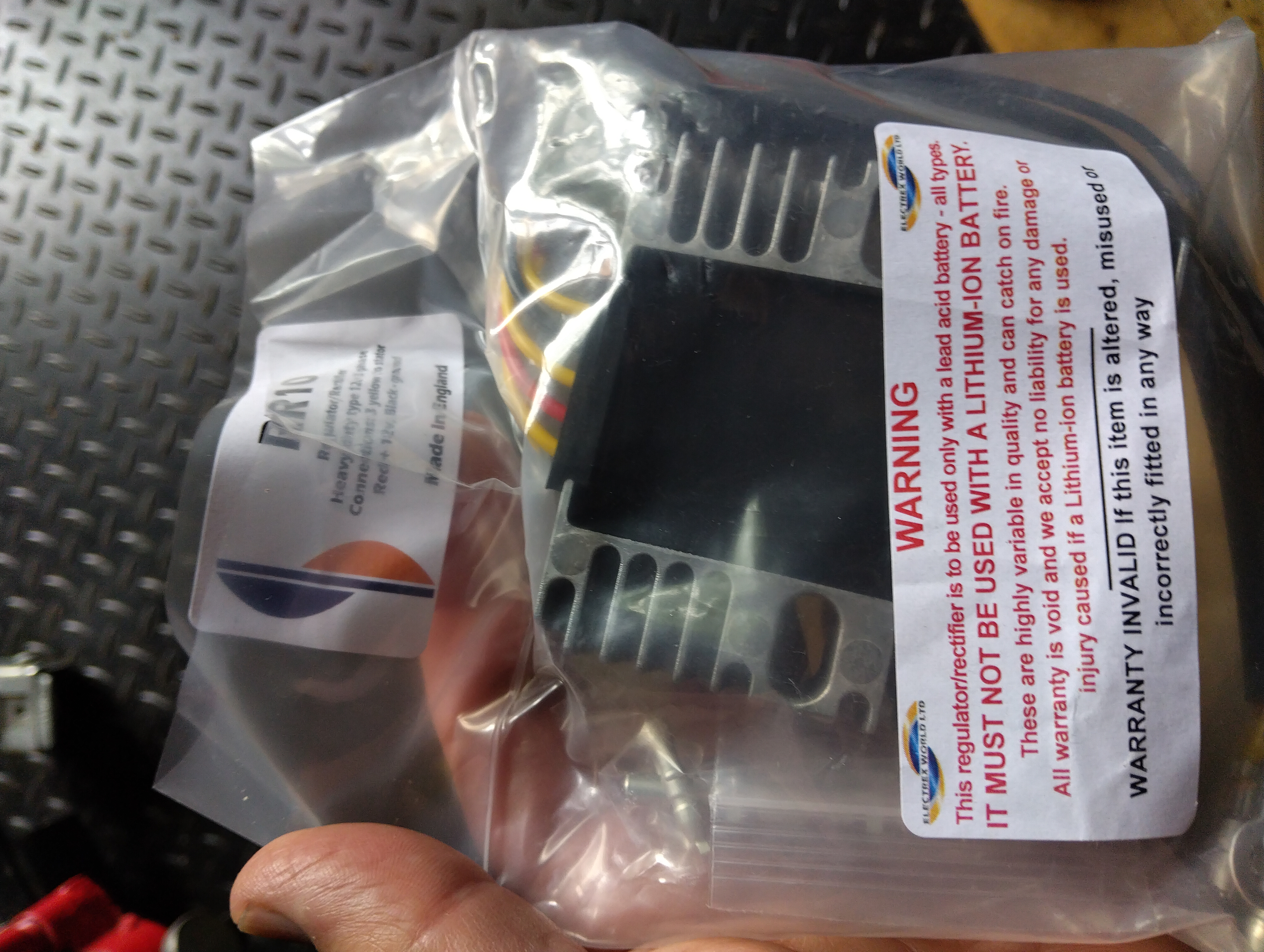

With a number of other things going on, only last week did I get to have a proper look at Scruffy.
First check on the alternator showed coil resistance mostly the same value but coil insulation to ground near enough shorted
Testing the reg/rec showed half of the input diodes have gone pop as well.
So this is my entertainment for next week.....
