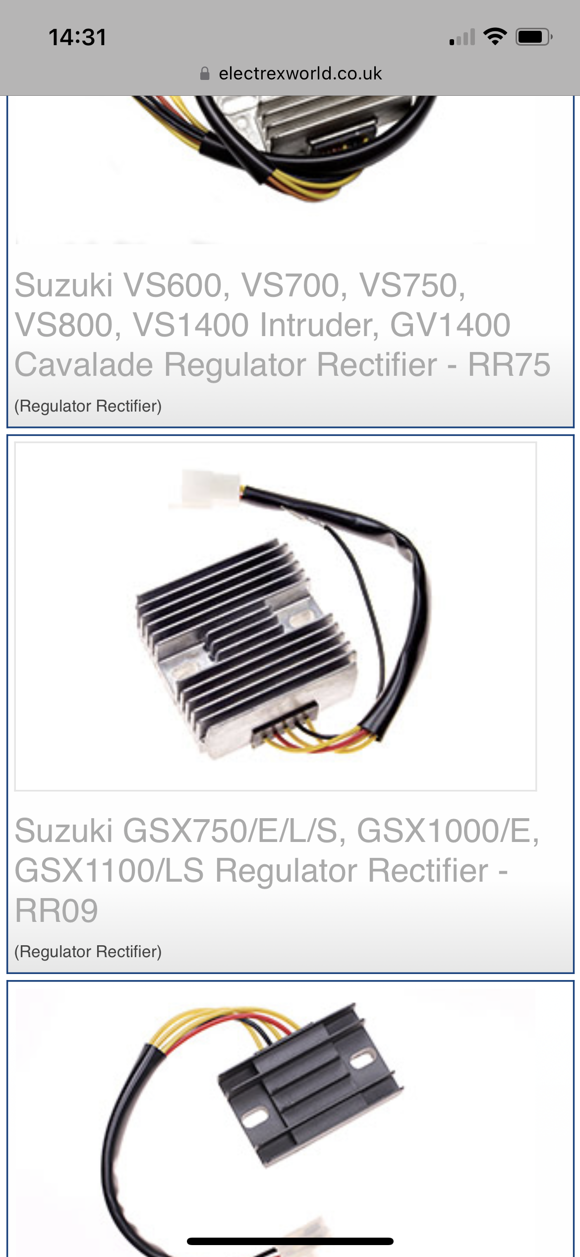

Now the rectifier, electrex RR is the one I need like this photo? Also I’m guessing I just connect wires like for like on the RR?

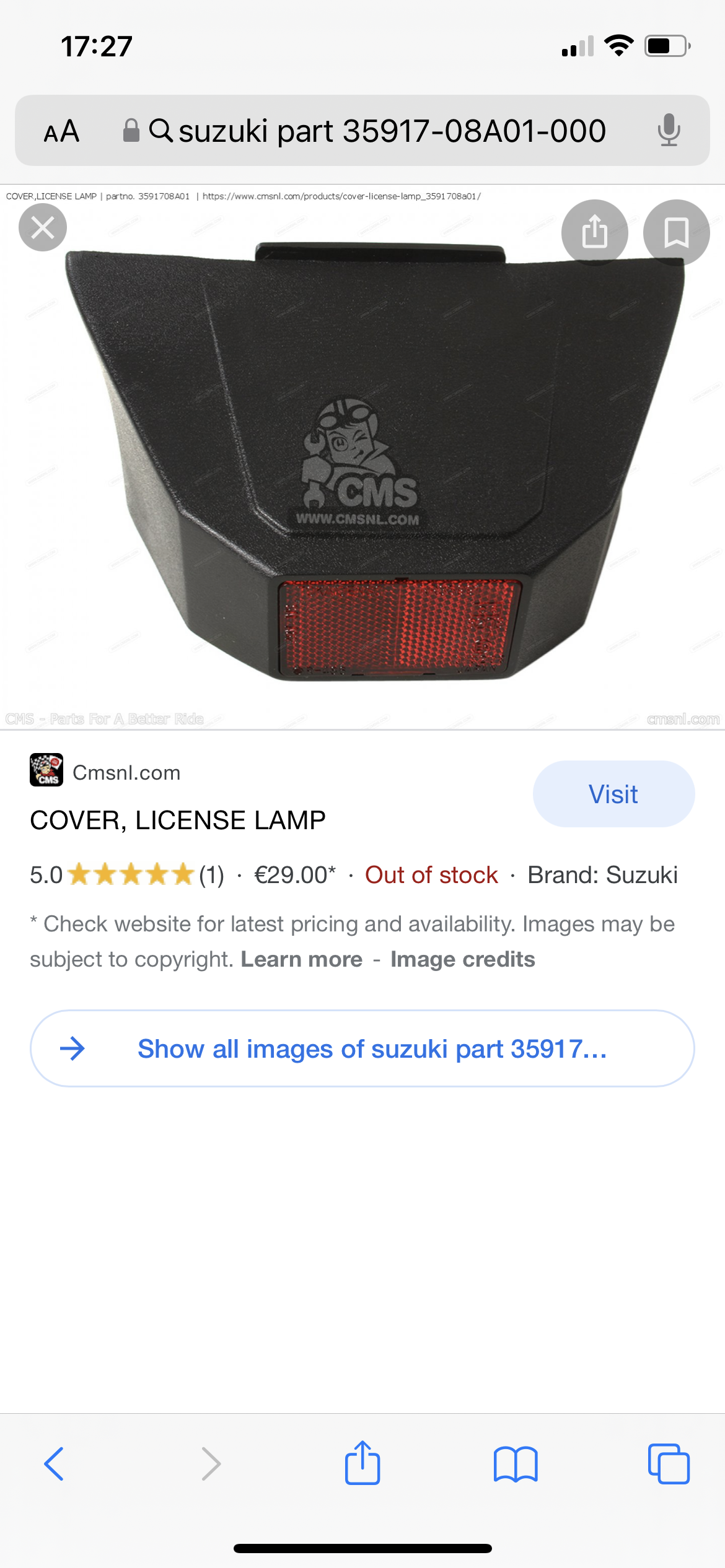

Whilst on parts sourcing I’m after the ducks arse on over the tail lights so if you know where I can get one let me know.
Cheers 🍻

2ndly the ducks arse ...is a hens tooth :lol: :mrgreen: ;) pretty rare. Best search yahoo Japan or either Australia ...where they will spank you ar*e on prices ...or Canada where there seems to be lot left in barns.
As for reg / reg firstly your loom is complete with factory connections see if electrix do one for the 750 Es ...if so its plug n play... You said you wouldn't be touring many miles , so the gremlin shouldn't appear unless you run with th headlamp off.
If the loom has been "modified " any Suzuki reg rec from GS 650 to 1100 cc one will fit .
But as per the 2 at the rally join the 3 yellow direct to alternator wires . Take the black direct to earth of battery and join the red to the red that fed the original reg rec. sorted.
