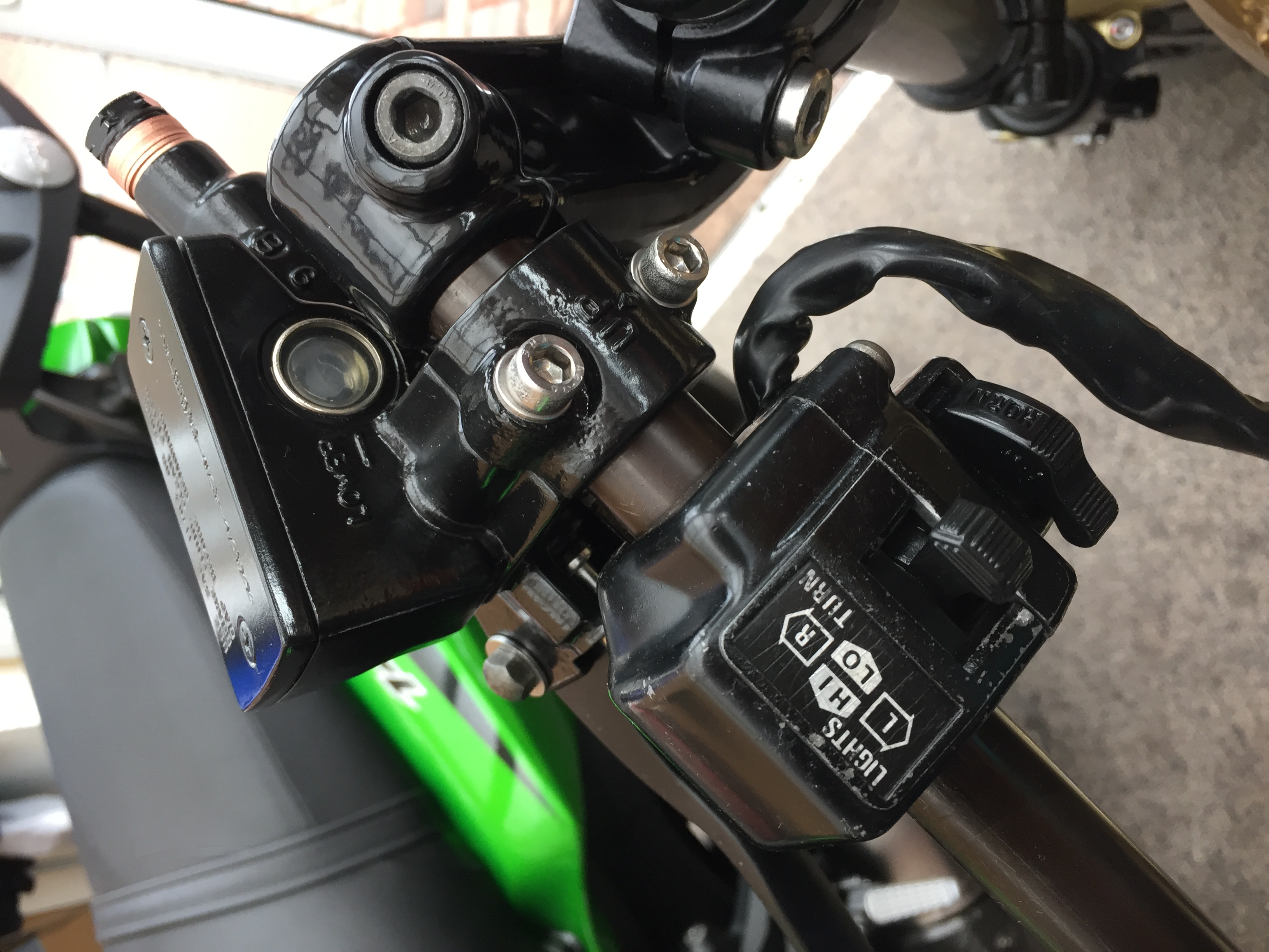

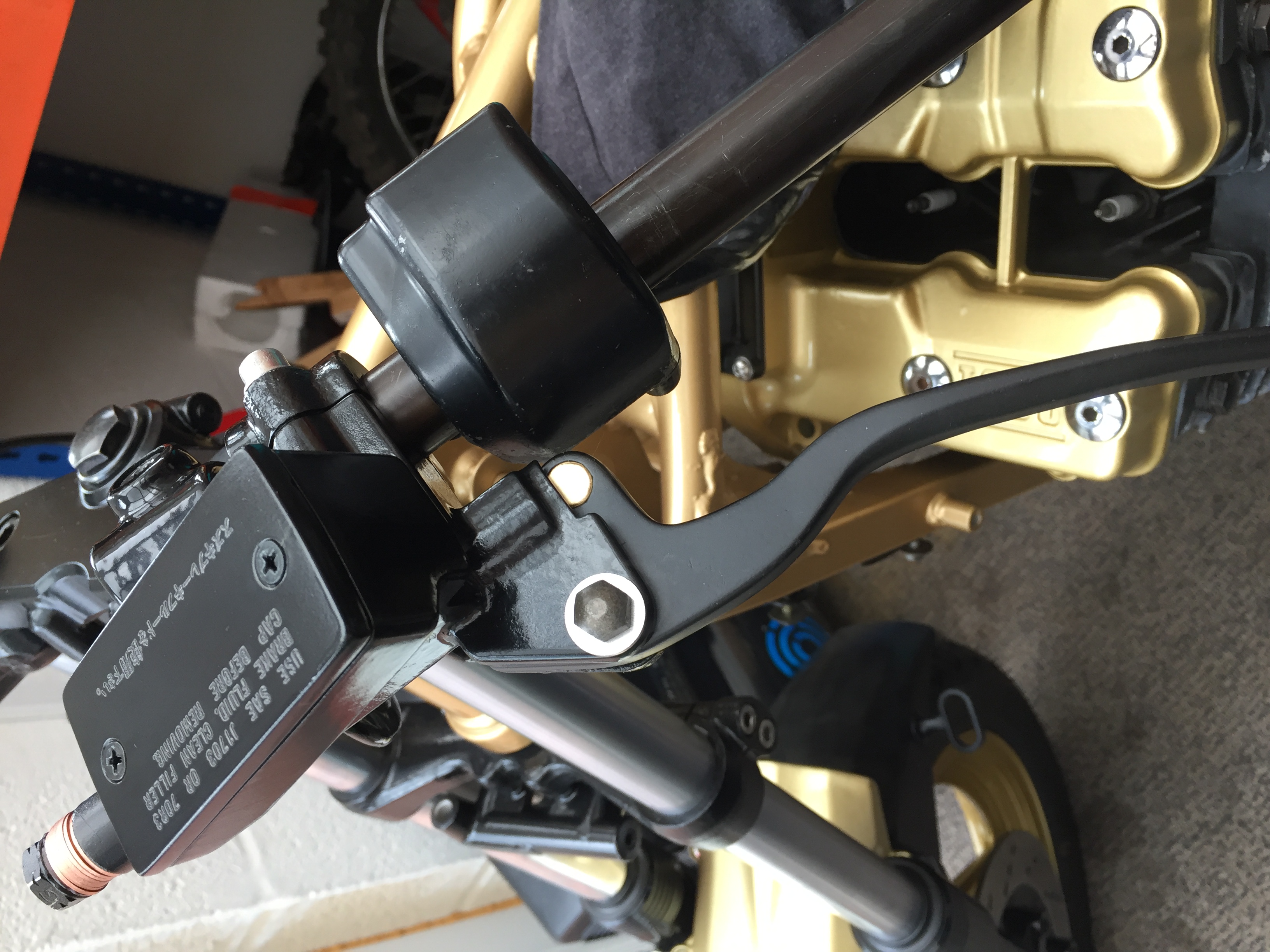

You can repair it yourself. You can buy the sight glass off evil bay. Bought several from China and managed to find one decent one out the lot. They come with an O ring that sits at the back of the glass (plastic).
Bought one off a chap on evil bay too who assured me it was good quality and it was satisfactory. Better than Chinese items which had tiny black dots in the plastic. If your interested I’ll dig out his contact details.
There are videos on YouTube of how to replace one: break and remove old one. Place o ring in the cylinder window then place sight glass in the hole so it just bites. Make sure it’s sitting squarely! I used a piece of wood at the back of the master cylinder and a piece of Aluminium resting on the sight glass. Place a G clamp across the two then tighten and you’ll see the glass start to seat. It is a bit of a fiddle but once you’ve done one successfully it’s not a problem doing more.

FED1F268-6693-404A-B169-3FE8FB594986.jpegYou can repair it yourself. You can buy the sight glass off evil bay. Bought several from China and managed to find one decent one out the lot. They come with an O ring that sits at the back of the glass (plastic).
There are videos on YouTube of how to replace one: break and remove old one. Place o ring in the cylinder window then place sight glass in the hole so it just bites. Make sure it’s sitting squarely! I used a piece of wood at the back of the master cylinder and a piece of Aluminium resting on the sight glass. Place a G clamp across the two then tighten and you’ll see the glass start to seat. It is a bit of a fiddle but once you’ve done one successfully it’s not a problem doing more. E12128B9-3195-4915-A235-B097CCD586F4.jpeg
