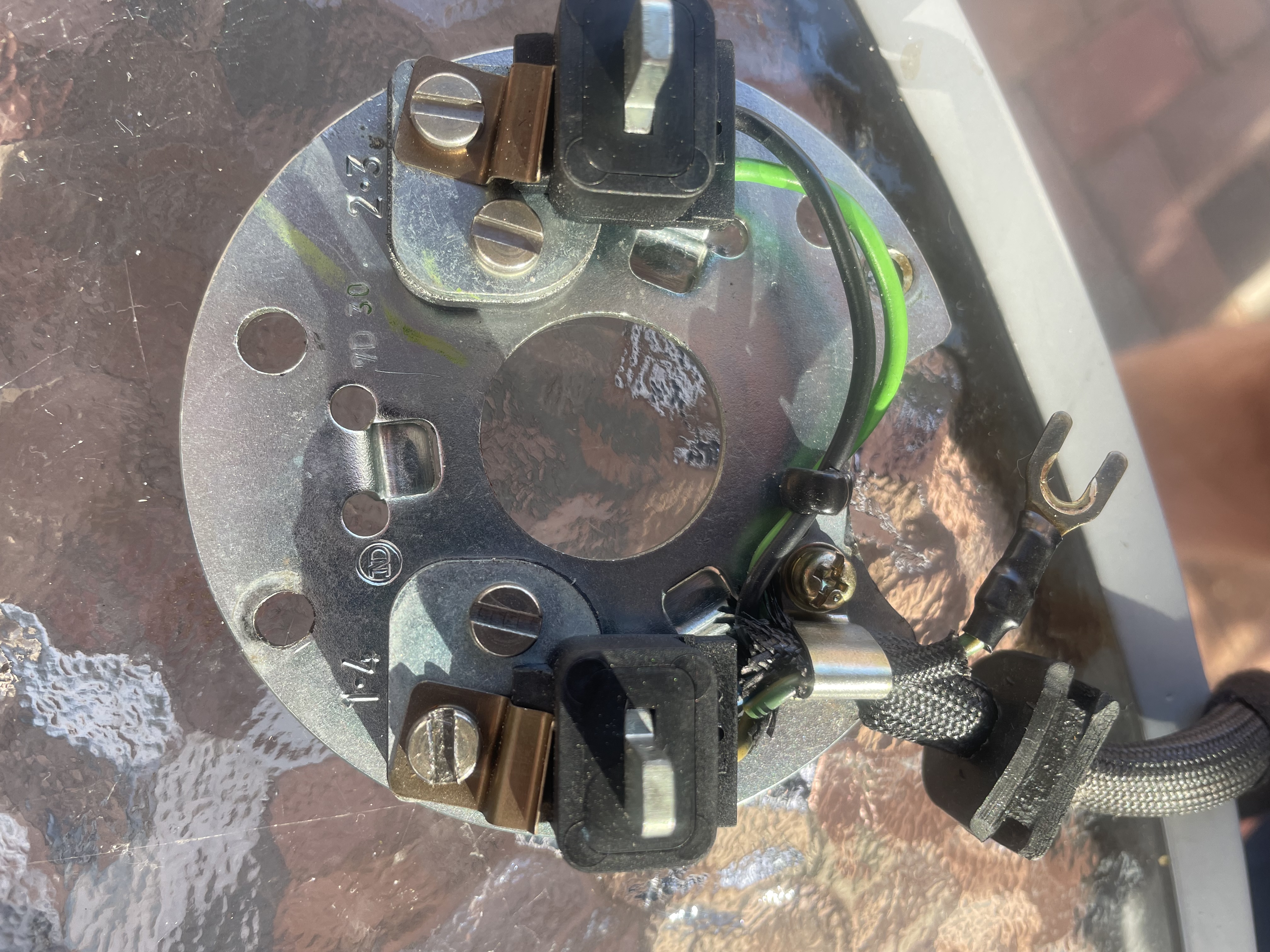

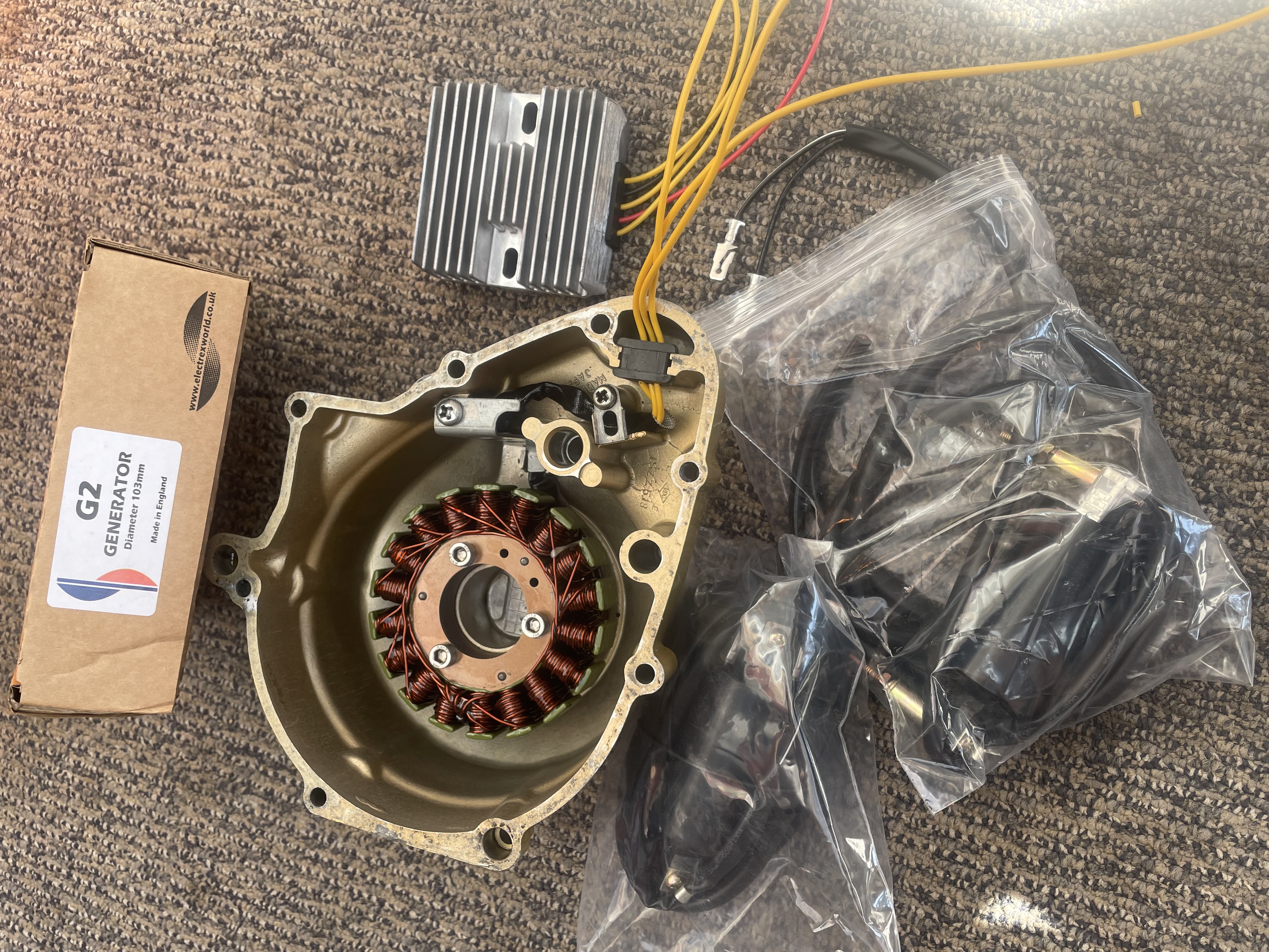

Rectifier fried and stator too so new ones ordered from electrexworld. Just tested pick ups and dead too. There was a horrible kink in the wires so was hoping they had cracked and split and this was the case 👍 just need to splice some new wire to it. My question is when I’ve got the tester on the diode resistance setting 2k I’m getting .160 on both green/black and blue/yellow. But manual states 130-200 perhaps I’ve not got meter on the right setting 🤞
Also what does the 1.4 LHS and 2.3 RHS represent?
Gaps between pick up and rotor measures .014mm and 0.018 mm.

1.4 and 2.3 is easy! That's the cylinders triggered/fired by the pick up that is below the numbers.

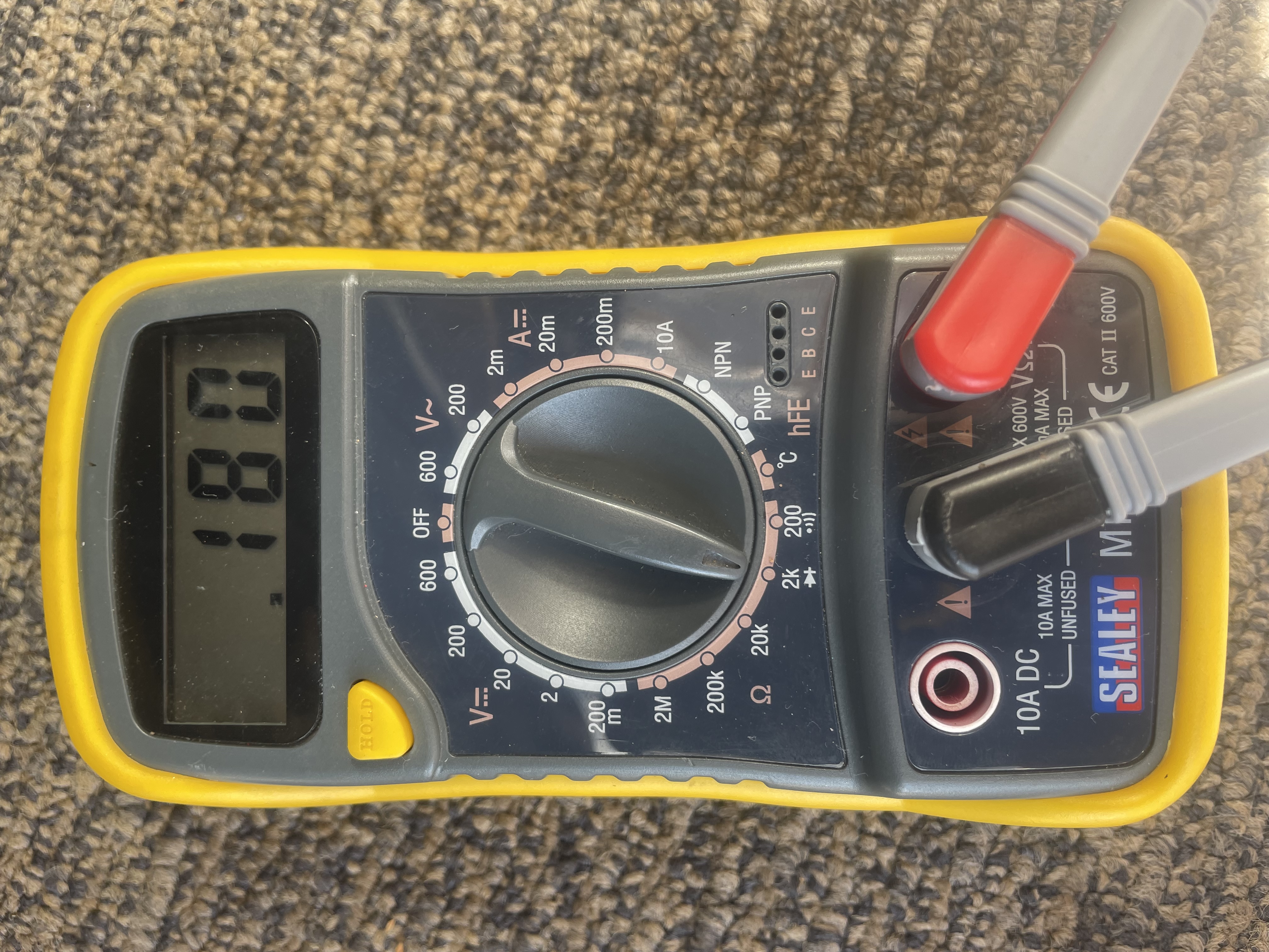

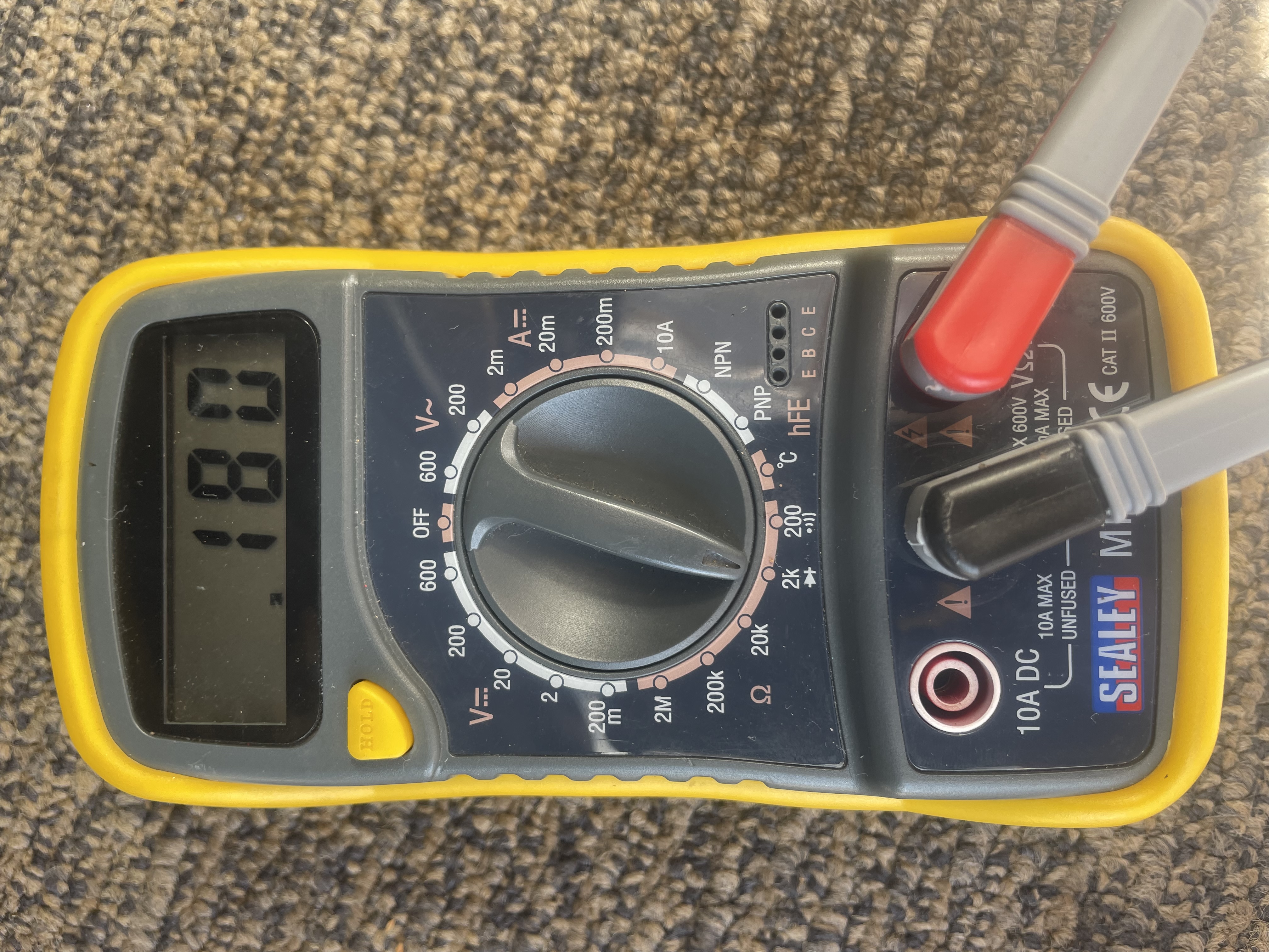

Now back to pick ups: manual states 130 to 200 ohms green to black then blue to yellow standard resistance. I’m getting
Green to Black .174
Blue to yellow .180
See photo of my setting on MM

You could try going down to the 200ohm range and testing again.
The display on your meter does not indicate that you are on the diode test (does pushing the "Hold" button switch to the alternate function?).
Some times testing an item like that is awkward and if you hold the probes onto the tags, you end up measuring your own resistance. I have a collection of test clips and wires that I have accrued over the years :roll:
