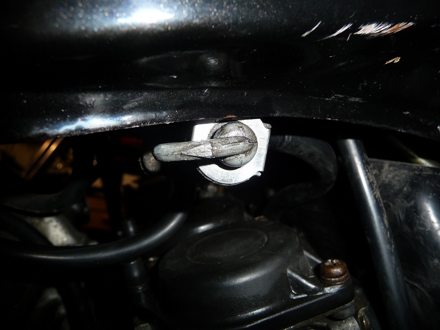

Also, should the fuel tap be so close to the tank?
[image] [/image]
The lever is jammed and I don't want to force it, so I will probably have to get a new tap anyway.
[image] [/image]

The tap looks the same as the one on my 1,000. That is also very close to the tank and difficult to get off reserve with thick winter gloves on. To get around this problem I try to fill up before going onto reserve.
It also gets quite tight once in a while, but it's easy to take apart, clean up and put back together. I use a very thin smear of silicone grease on the tapered central part. This seems to keep it free for a while, until it needs doing again: perhaps once a year. I don't think the silicone contaminates the petrol.
