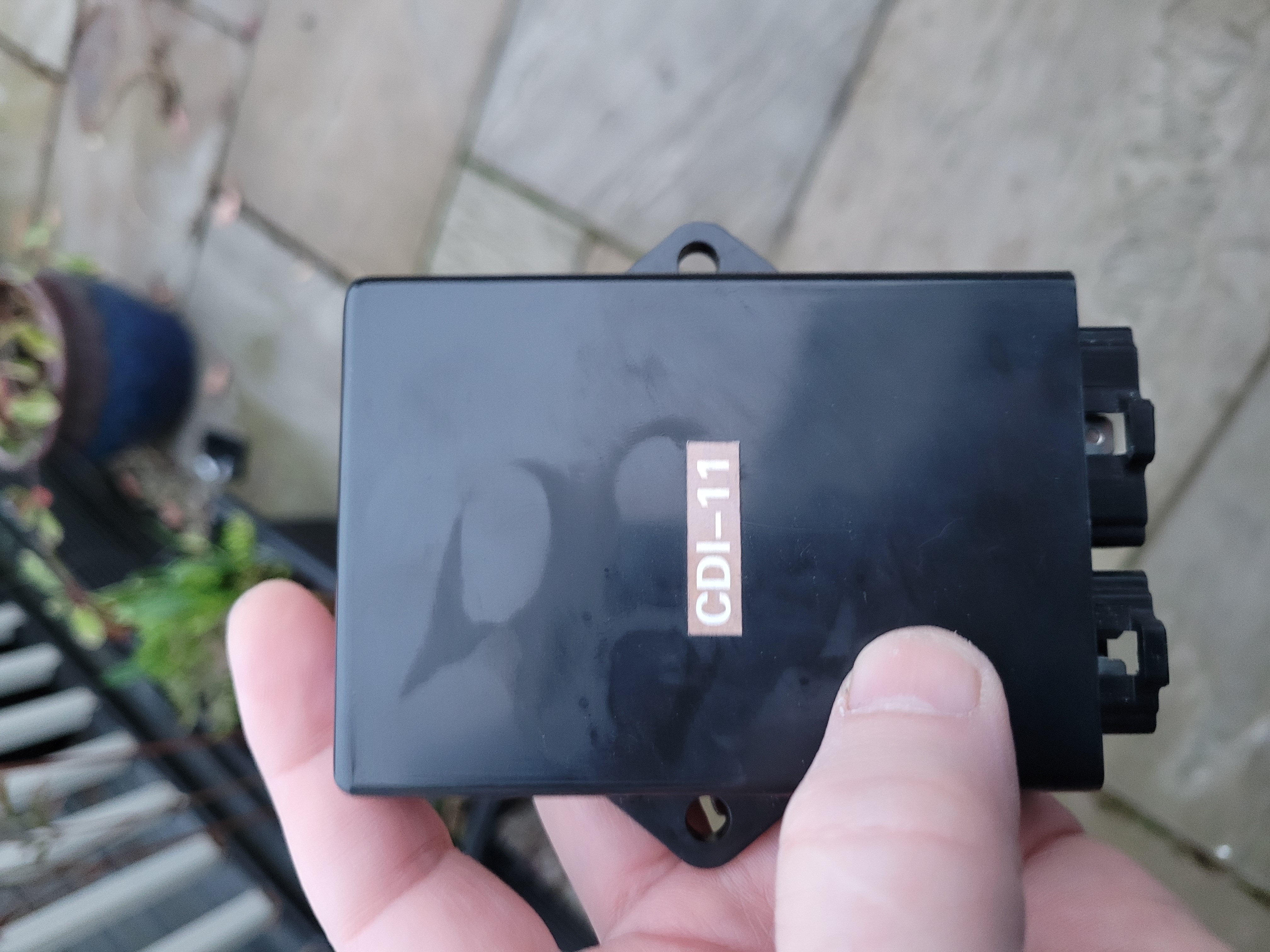

Would anybody have a photo of the original cdi they could share,I believe my current one is a aftermarket ?

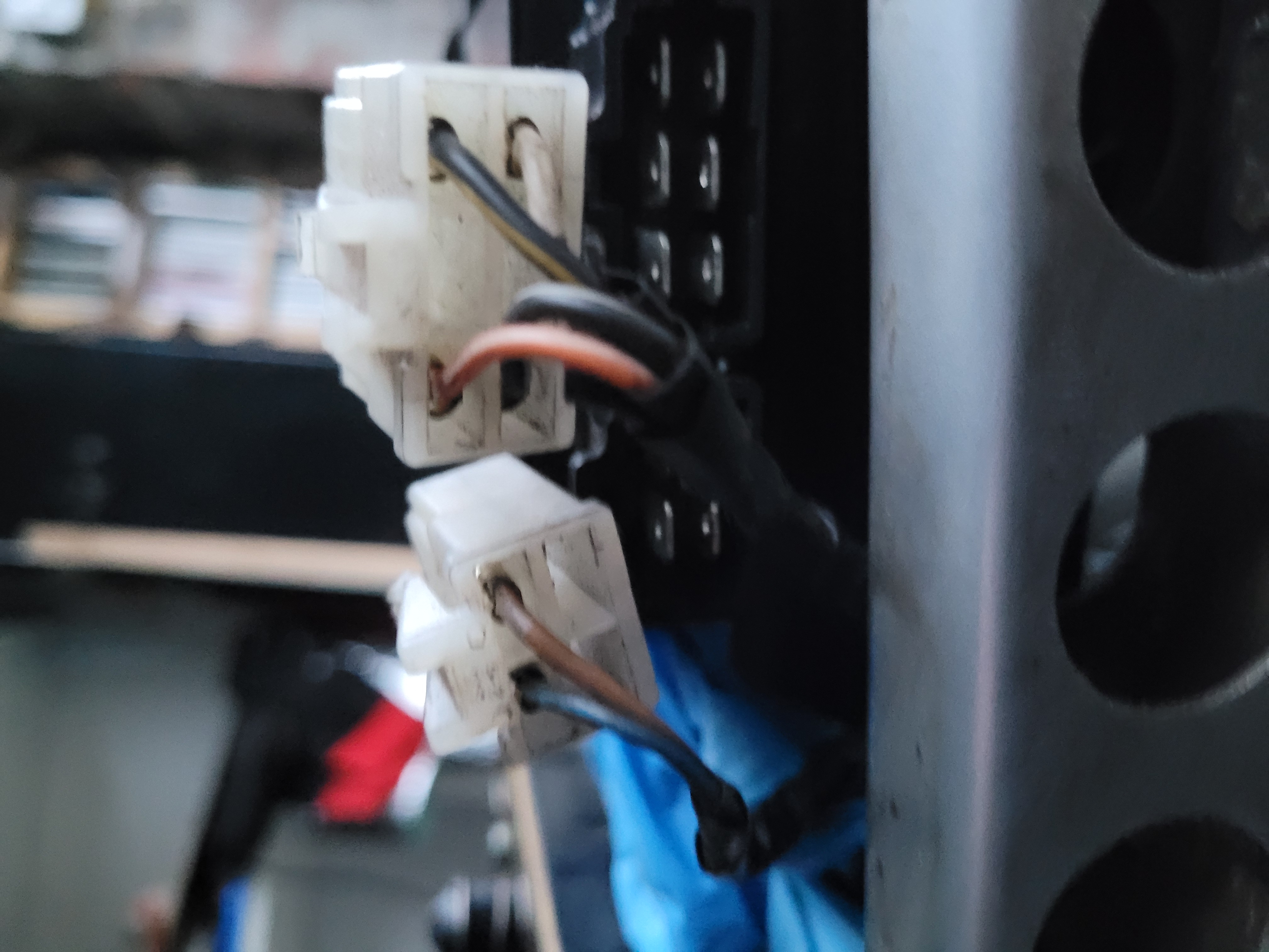

Posted: Sat Apr 23, 2022 2:49 am

Re: 400
Posted: Sat Apr 23, 2022 2:52 am
by William.sn032
This is my current suspect cdi ?
