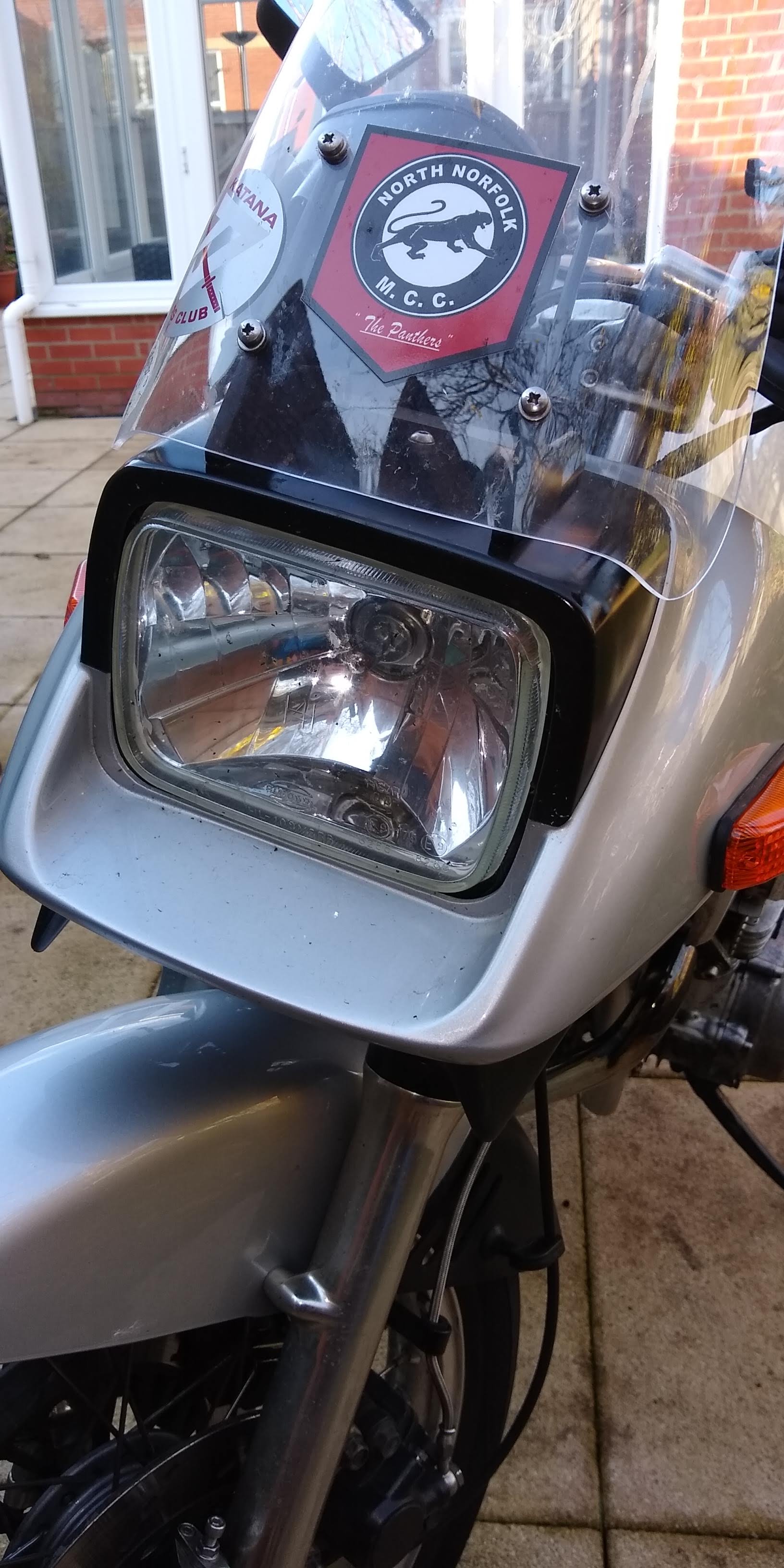

Upgraded lighting is as UB says; MR2 Crystal aftermarket lamp unit, I run a Phillips Nightbreaker H4 lamp in mine and it is well up to the job. If you add a decent LED H4 replacement then you will end up with a headlight that’s fantastic but might get you angry flashes from car drivers. Especially if the spread is not well defined.

No MR2 headlight conversion needs the MR2 headlight modified slightly (removal of some of the plastic around the corners I believe from memory so it fits the frame), but then it's a straight swap for the Kat headlight.

I have been reading the testimony about using a Toyota car heeadlamp in a Katana. I replaved my standard headlamp with a Candlepower unit that fit right in ans is a really good headlamp -- and myy experience with car headlamps on motorcycles is that their spread was wrong, didn't properly light corners, etc. As a matter of fact, back when cars used real headlamps I used to replace the CAR headlamps....with similar sized motorcycle ones. So what's the real story on these car headlamps?
