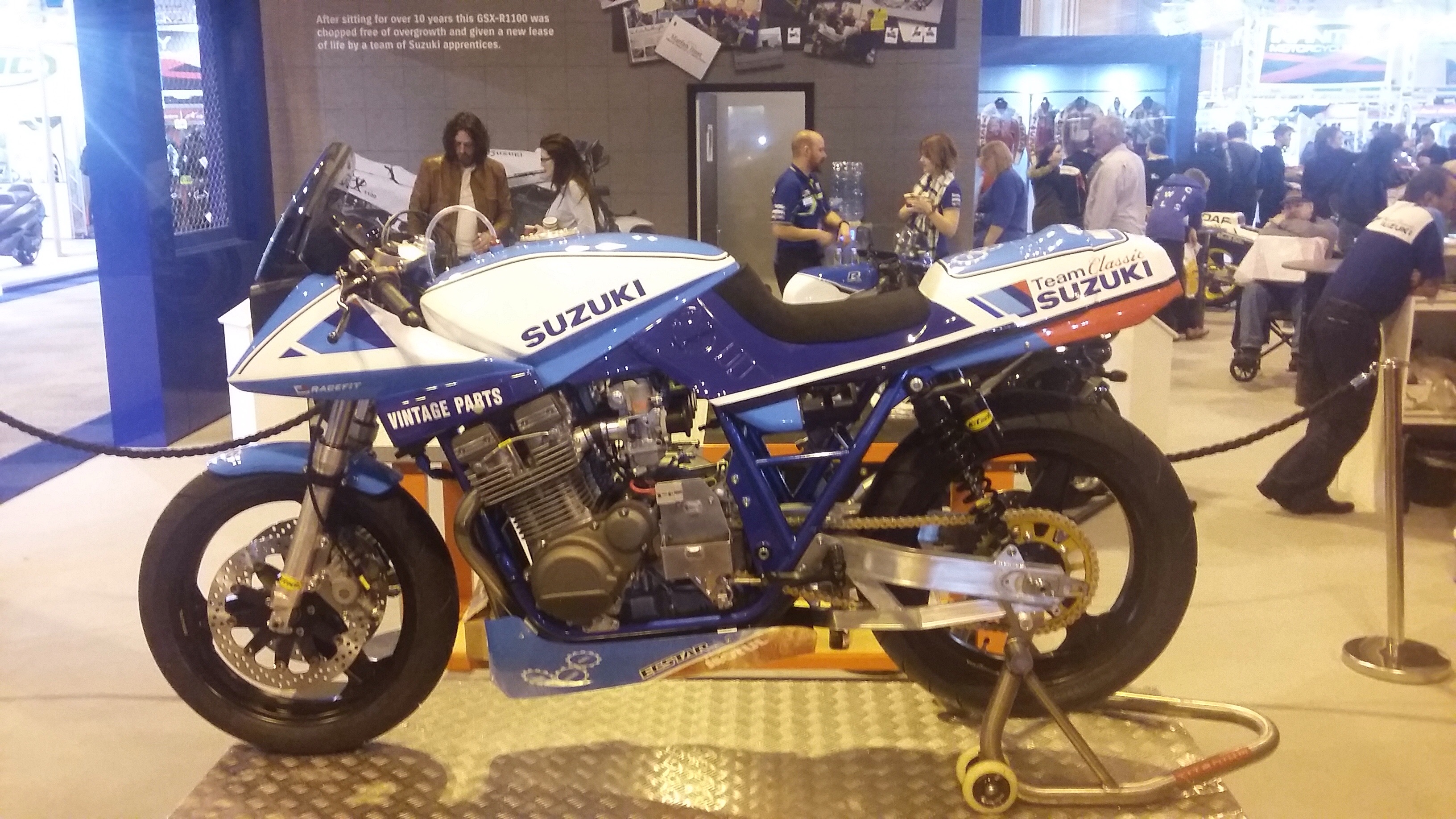

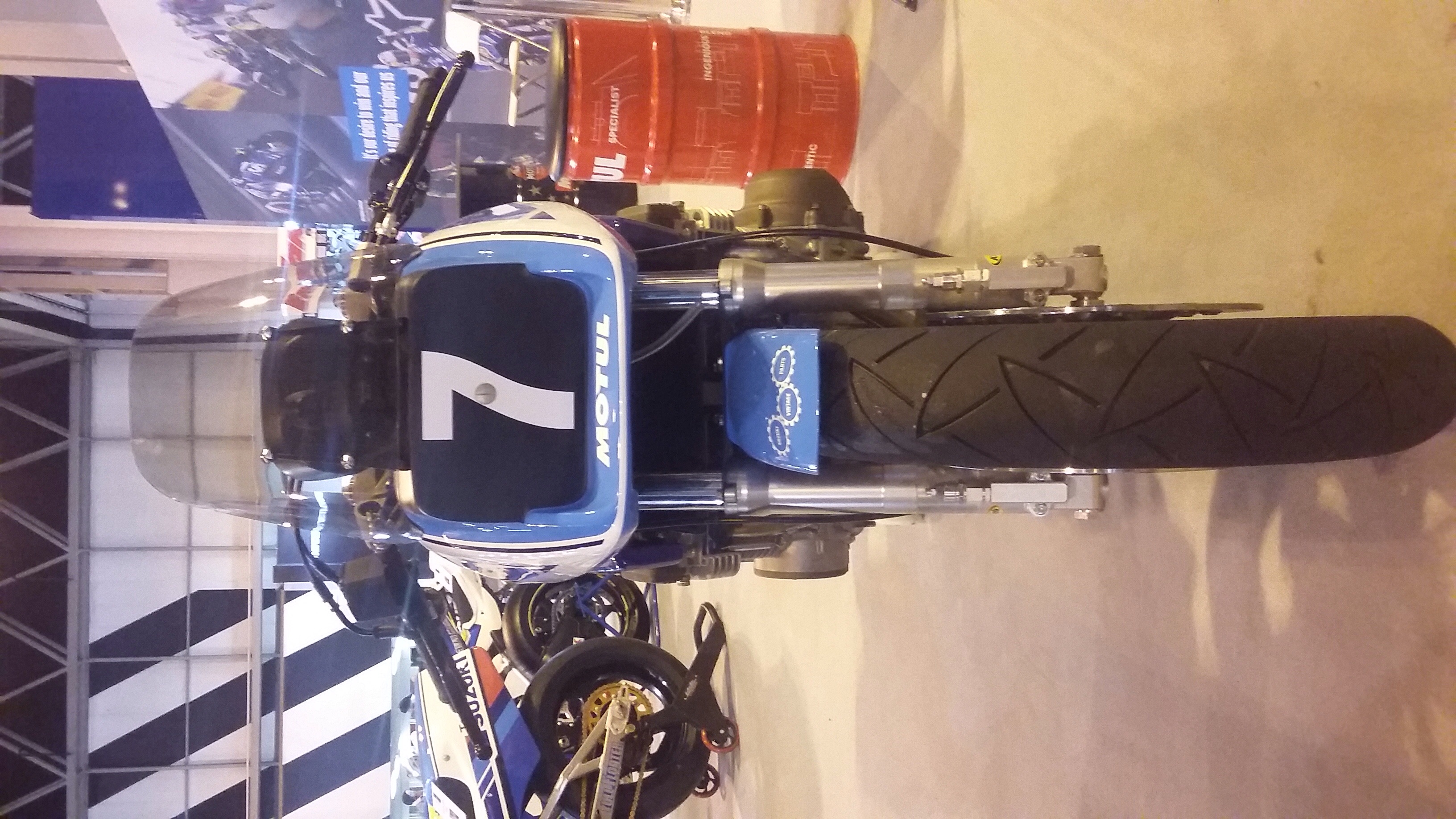

Quite pretty...

wonder where they got that tail piece / side cover combo from?

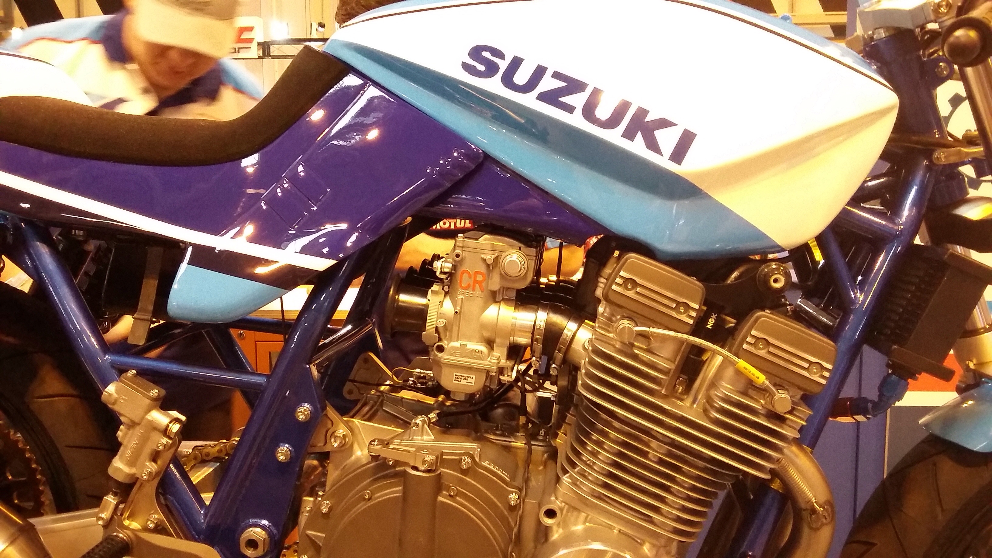

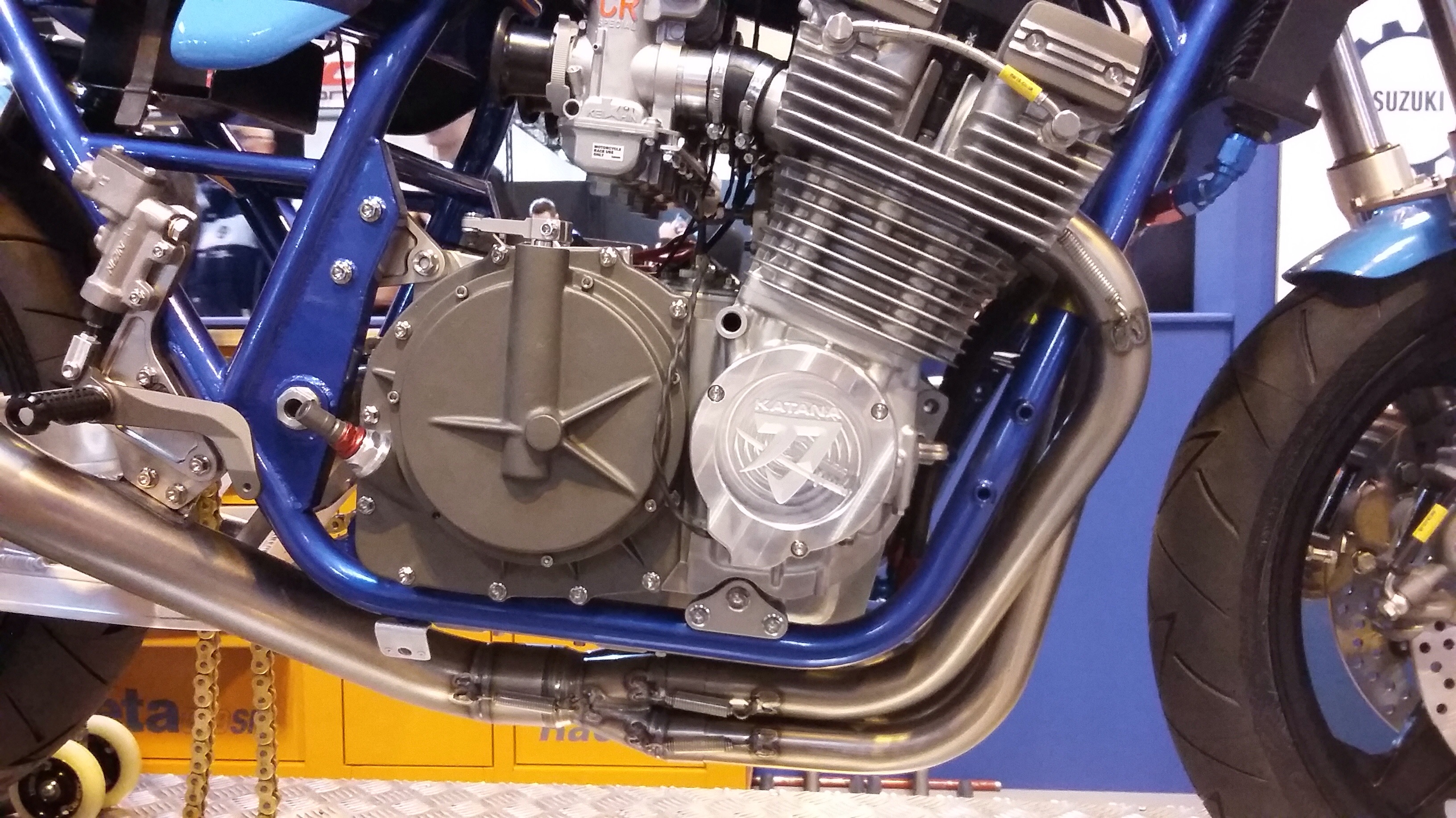

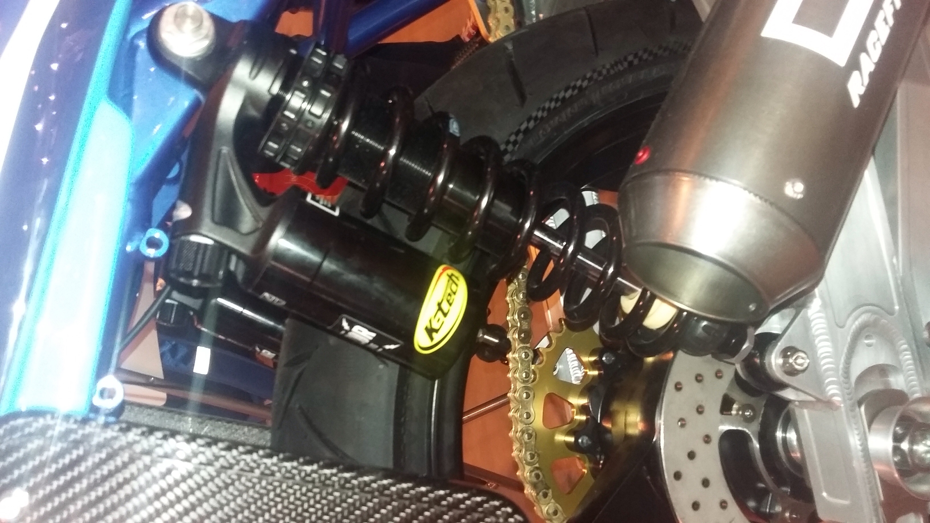

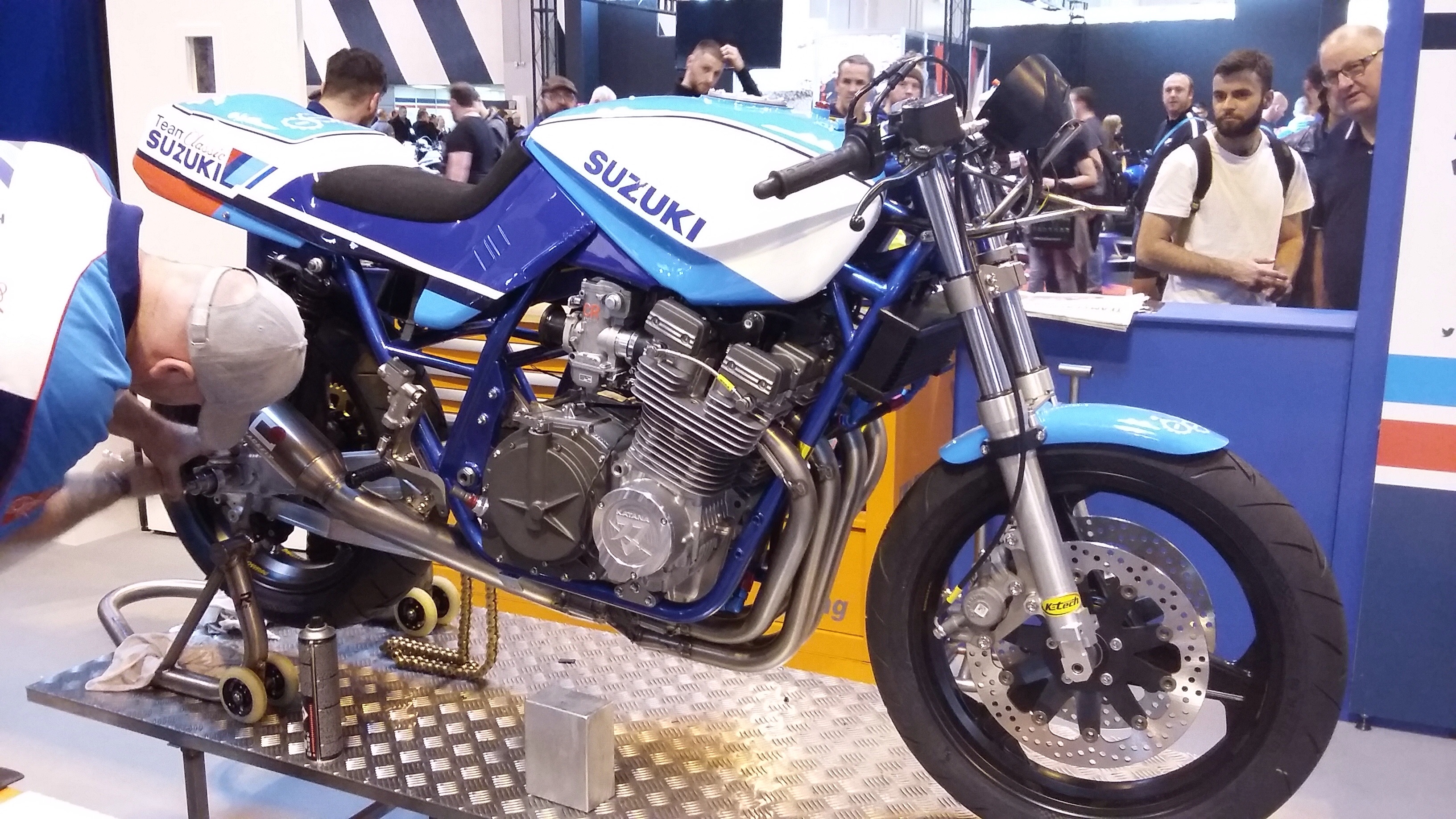

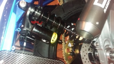

Frame is made from scratch so not an original...same with swingarm.
Fork tubes are 600 bandit with custom made legs complete with non-working anti-dive in keeping with the original look.
Nice looking dymag wheels and you can literally lift that racefit pipe with two fingers.
I went on the final day and they had one bike on display and another on the bench.
Maybe not evident from these crap photos but it had a fair bit of frame bracing behind the headstock.

no idea why they stuck on that bit of braided line between the inlet and exhaust cam...
