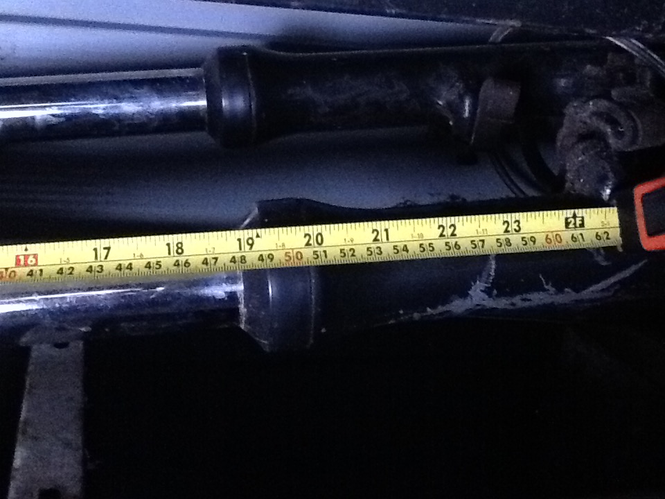

Sorry but my measurement was with the dust boots still on but hopefully the photo below will give you an idea.
Image2019-04-07_05-27-32 by jeznewsome, on Flickr

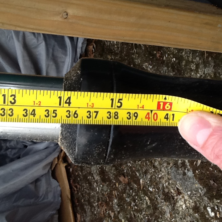

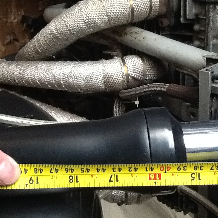

Not sure if this will help, but my readings are :-
Spare front end, guess these are ET's
Mine, believe they are ESD, adjustable damping at bottom of leg
And my short ass set
All measured from the top of the leg
