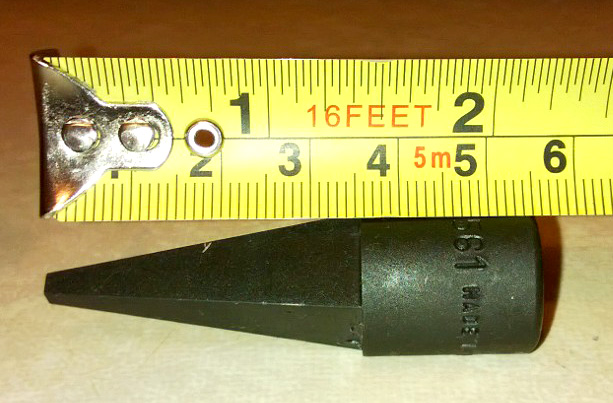

I did buy the proper Suzuki tool which you could probably make. I have pictured the end and that has a 3/8ths square drive in it for a long T handle. If you can't make something I can supply the parts numbers I had to use an impact driver and largish hammer to remove them (but the special tool and a torque wrench for putting back together).

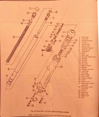

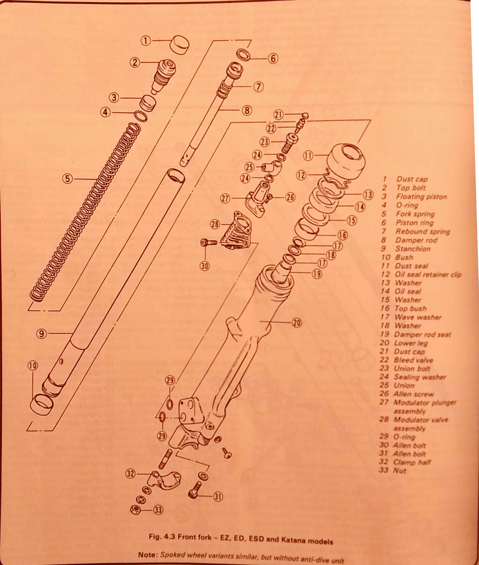

Robinson's info definitely seems a bit sketchy, the Haynes book shows more parts, I think I've attached it at the bottom...but that might not have worked

That Haynes manual shows some GSX1100(ESD?) forks that have the extra adjustment at the bottom (rebound or compression can't remember!). It shows 2 extra washers each side of the fork seal that the Katana doesn't have, it you look at the Robinsons link above. As Blix says the "piston, part number 51121-49200" are £17 each but don't forget the 10% discount at Robinsons (PM me if you need deals as haven't added to the members section of the website).
