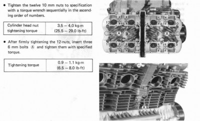

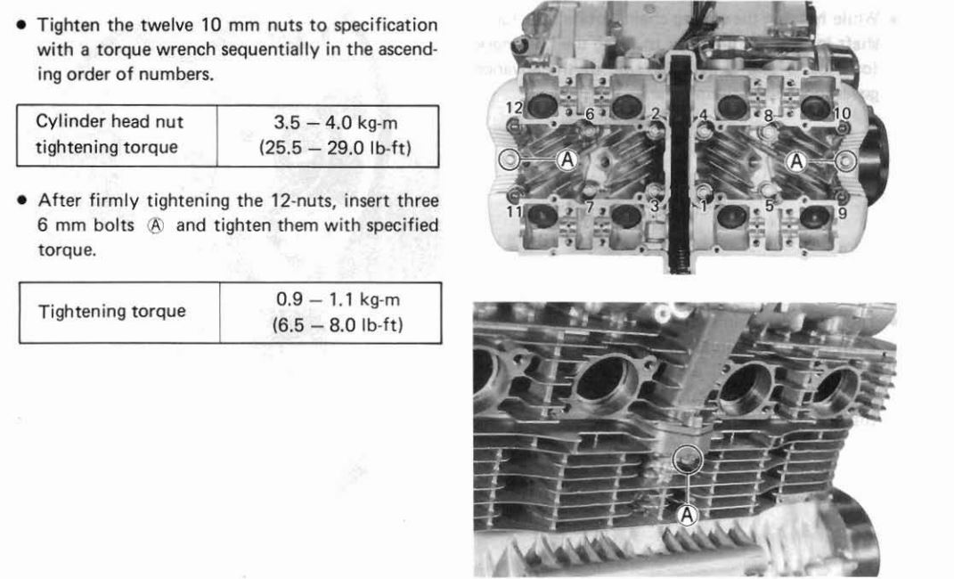

I found a GS1100 manual, will that be the same - check the bolt layout and if so then it should be OK.
That was from p107 here http://gsarchive.bwringer.com/mtsac/~cl ... Manual.pdf
The Haynes manual says there are numbers cast onto the head for the sequence. I guess you start at 1 and work up if you can see them.
Re: Cylinder Head Nuts
Post by PaulD » Thu Jun 27, 2019 4:47 pm
If you look carefully the sequence is cast into the head ;)
