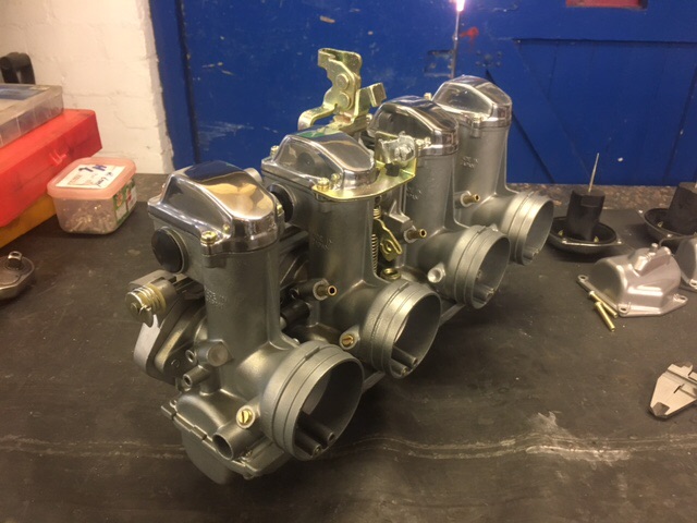

Well they are Kat Thou so what are they classed as??
Either way I need some further info please

theyre just called vm32's, folks call them flat slides, but theyre not, others call them smooth bores, which theyre not either. theyre just ordinary slide carbs, albeit larger than the usual sets of slide carbs and pretty rare.

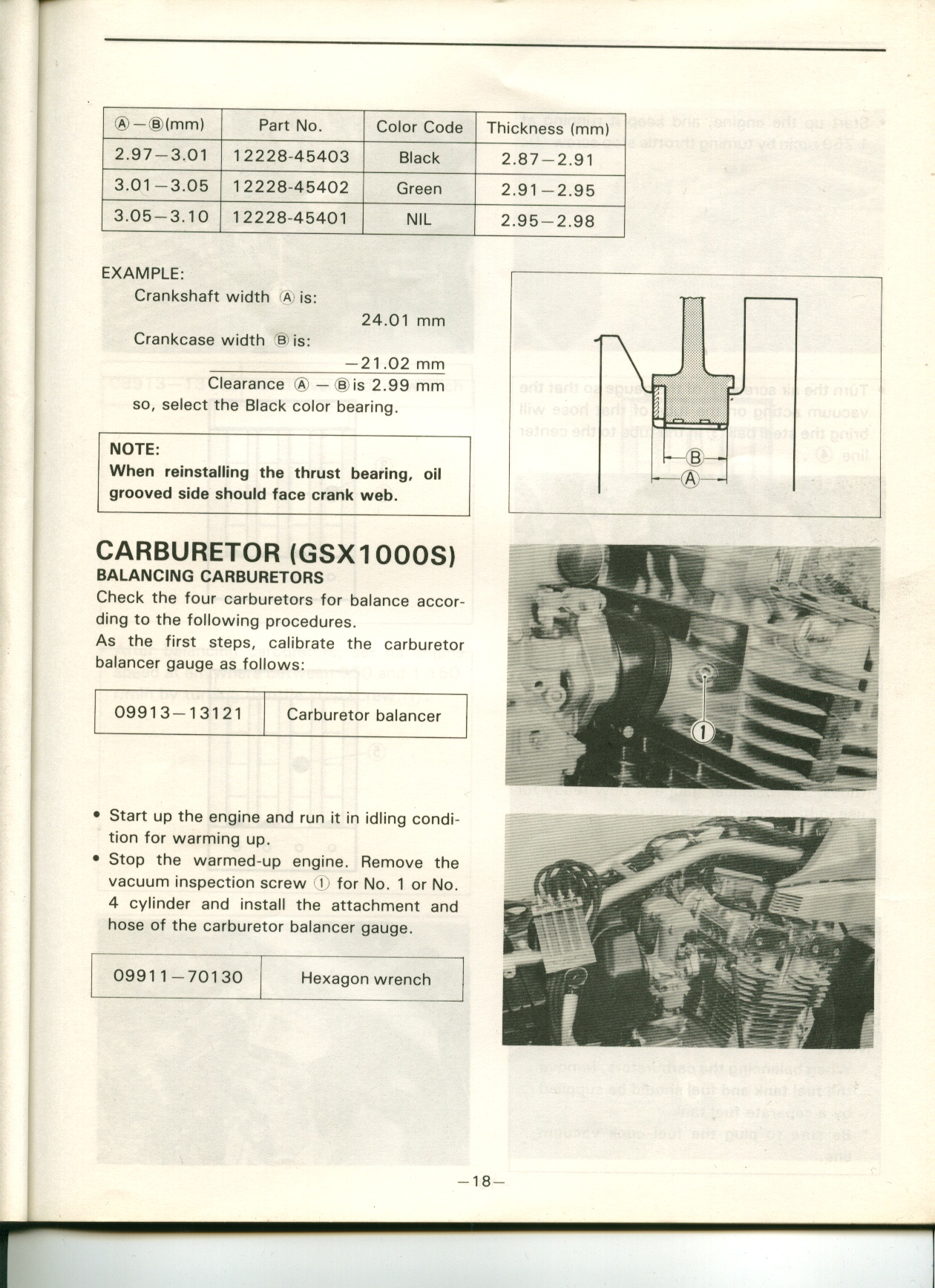

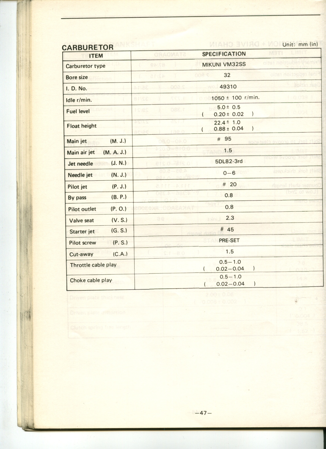

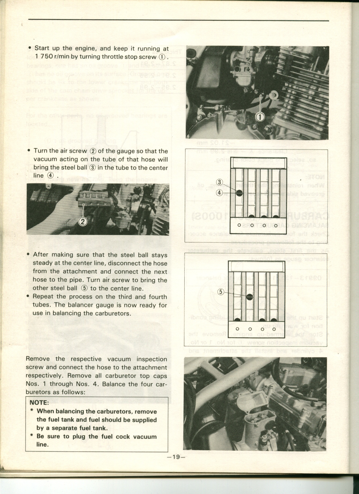

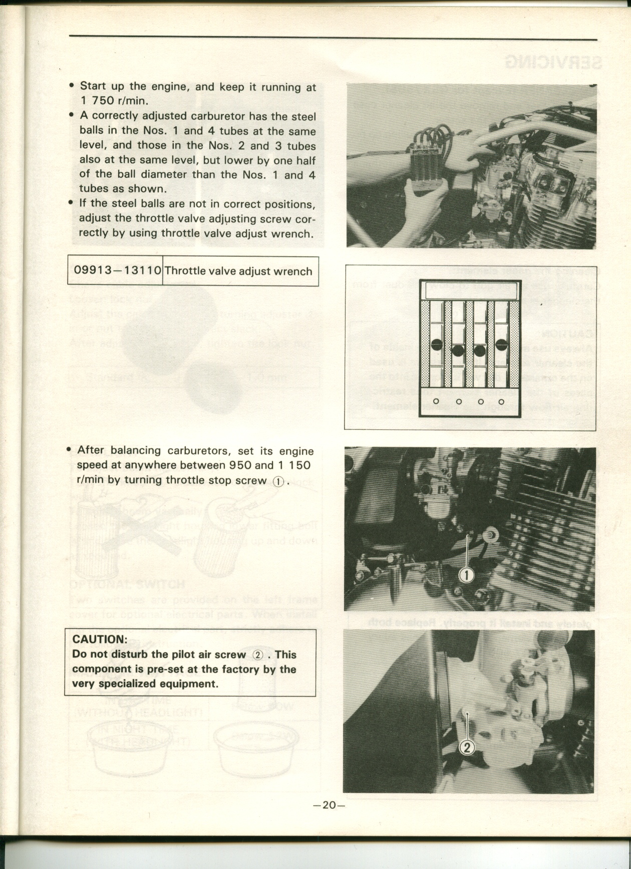

Here is the specs from the manual.

Cheers, are those (3x) brass nipples supposed to have a pipe leading somewhere vac wise or are they simply overflows??

One goes to the vacuum fuel tap the other two just flop about doing nothing.
