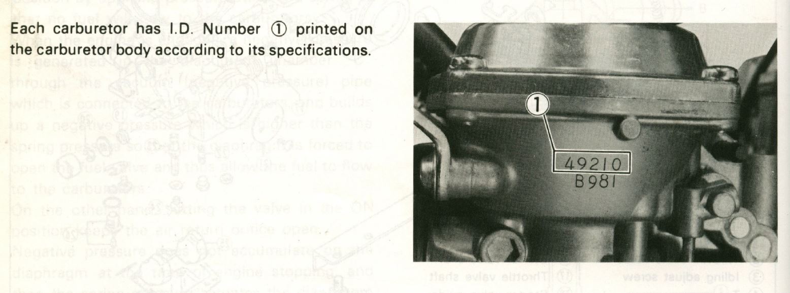

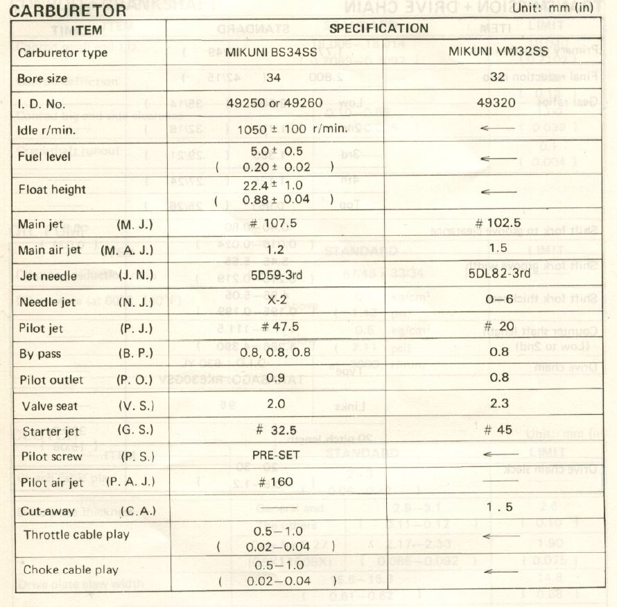

Guys I need seal and piston kits for the front and rear brake master cylinders and wondered if you could advise where to source them from in the uk? The bike is an SAE 1100 which is similar to the SZ 1100. I also need some carb bits and would welcome suggestions where to source. Can you also tell me the most conclusive way to ID the carbs I have, I know they are 34mm Mikuni CV’s. Also looking for the standard carb settings please for reference.
Left hand column for GSX1100sz

I've had a look at my carbs and the numbers on them don't seem to relate to the SZ carbs, so perhaps the 1987 SAE had different CV's fitted. The bike is really original so I'd be surprised if they had been changed but I've been wrong many times before. I'll try and upload some pictures of the bike and carbs.
