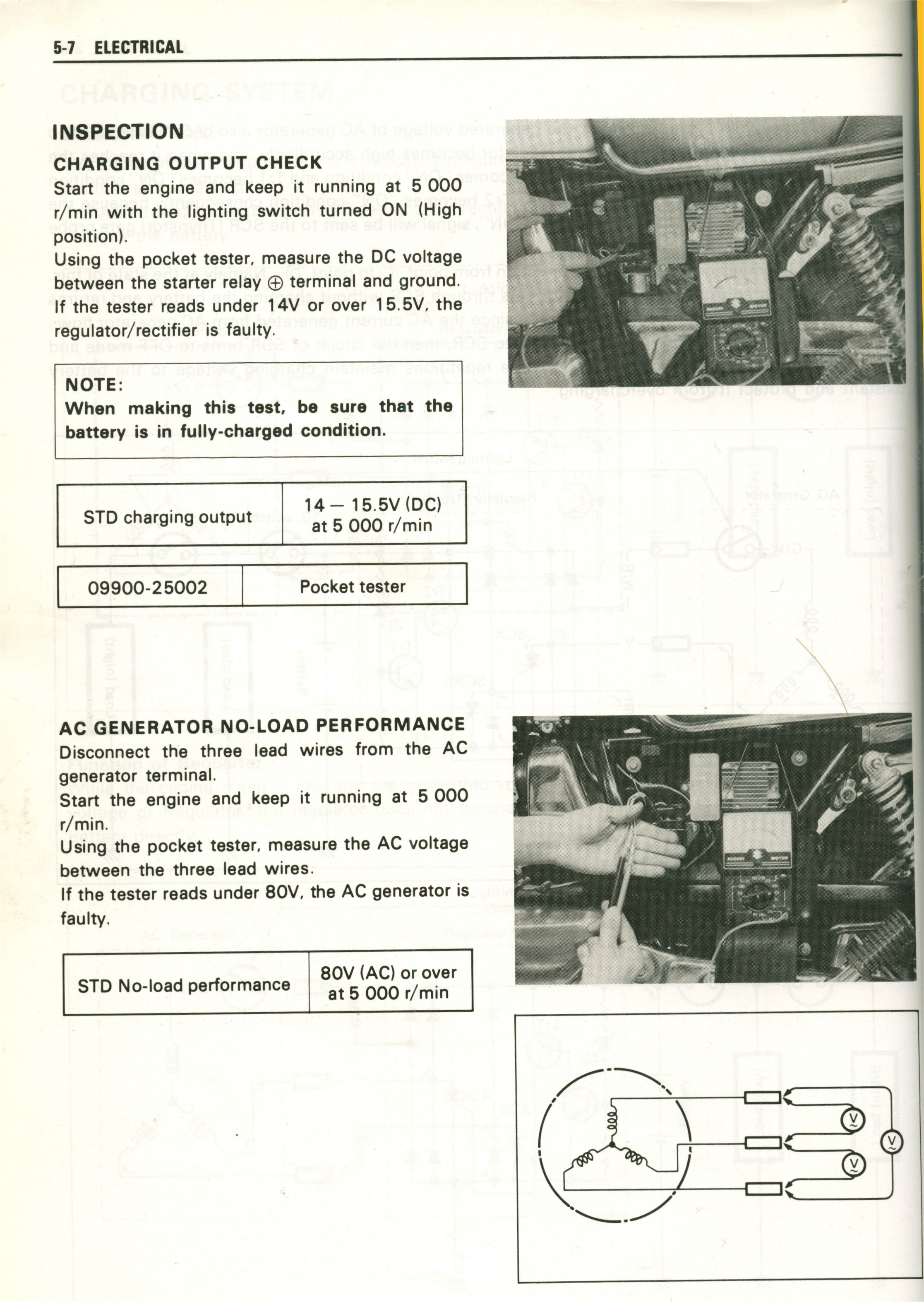

The first thing to check would be the battery voltage when the engine is running to confirm that the Reg/Rec is working correctly.
According to Suzook these are the figures:
The indicators are going to flash faster as the voltage rises causing the relay to operate quicker.
