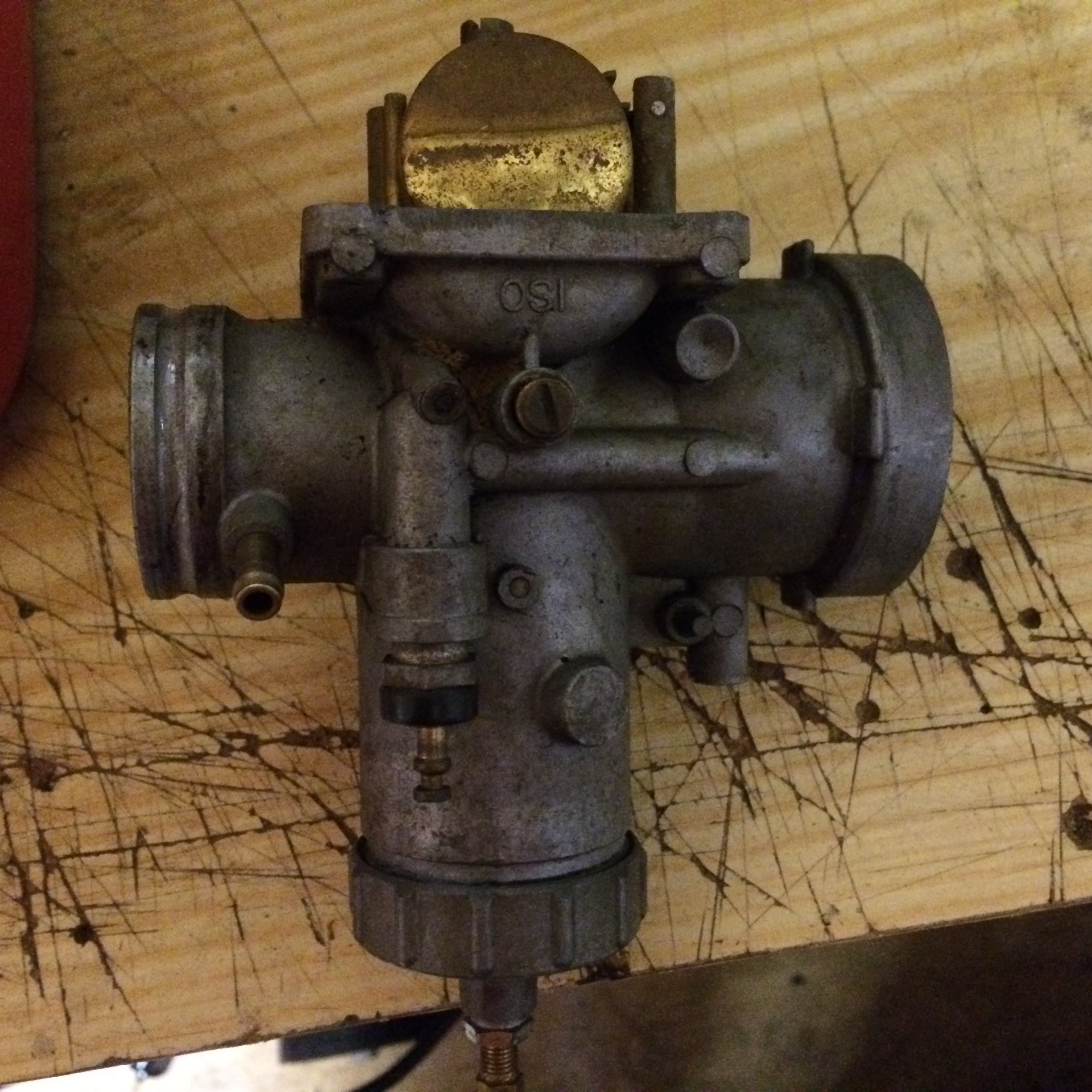

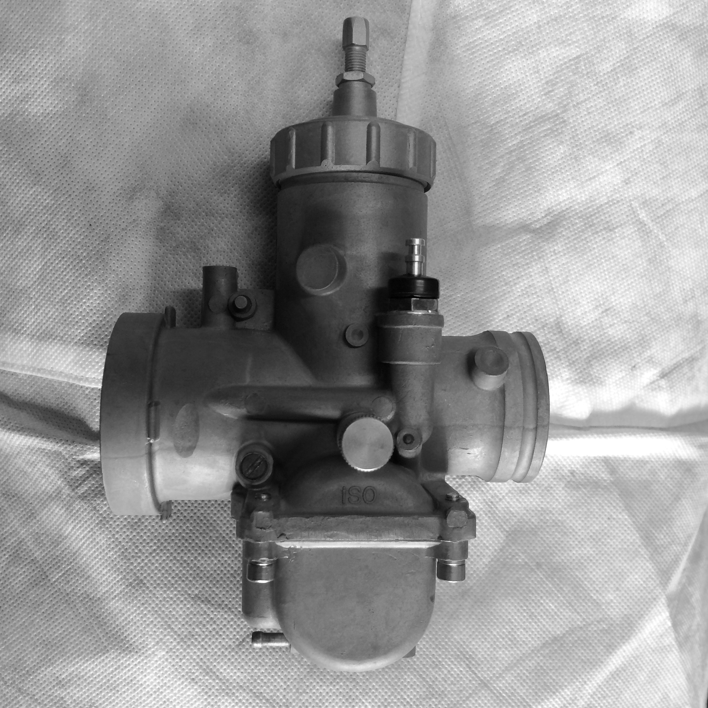

I soda blasted the carbs on my T500 and they come up well. The added bonus of soda is the medium melts when you ultrasonic them. See below for before & after.
