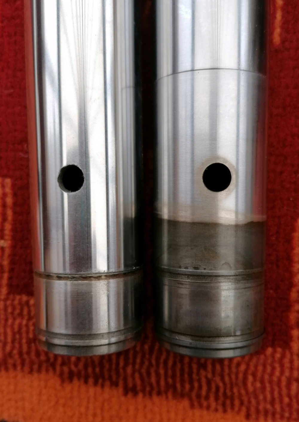

The 1100 tubes however are 37mm apart from the (approx) 99mm above the bottom bush, where they are about 36.6mm. Philpot just made them 37mm all the way down. I emailed them about this but they ignored me. I wasn't that happy about it as I assume Suzuki made them that way for a reason, but used them as no other choice and they do seem OK, but then I don't ride it on the twisties like I do my TZR!

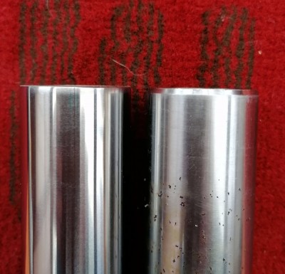

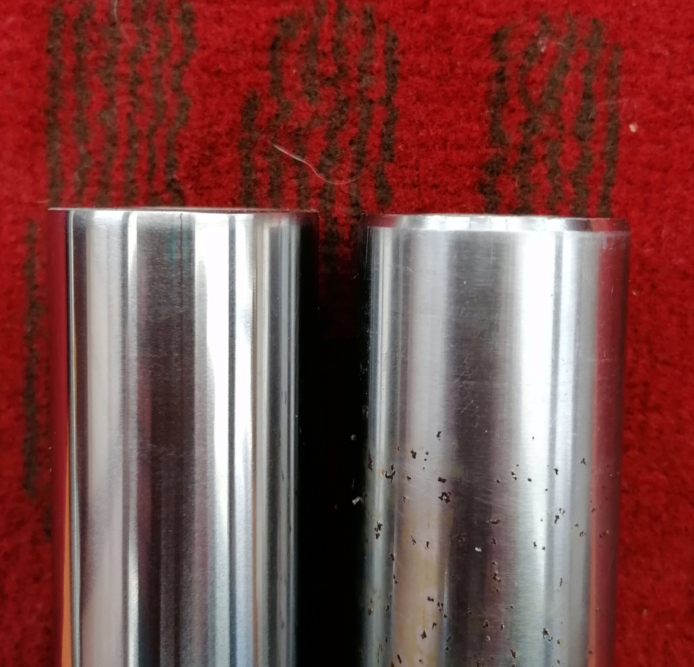

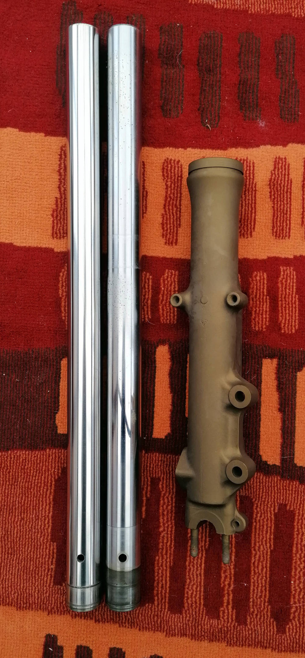

I just thought I'd close this post with some feedback. I ended up sending my fork tubes to Philpots rather than Hard Chrome Plating Ltd on the basis the forum comments suggested they were lower risk. They sent their courier to collect, promised max 6 weeks turnaround and had them back with me in two. I don't know if I was just lucky or if they have listened to feedback but they were properly cleaned and stripped of masking. As you can see from the pics, there are some differences to the standard plating - I've taken a pic against another old ESD tube. Diameter is 37mm and quality very good. The top has not been beveled and like Uncle Bob's, they did not grind back the lower area above the bush. Still, I think they charged me £200 and as replacements are now about £240 they do work out good value and the steel may be a better grade that the Chinese alternative although I have nothing to support this.
If you are interested, the fork lower in the first pic has been painted with Cerakote burnished bronze. I may put some details of the rebuild in the projects section as the whole bike will be done in this paint as a bit of an experiment.
