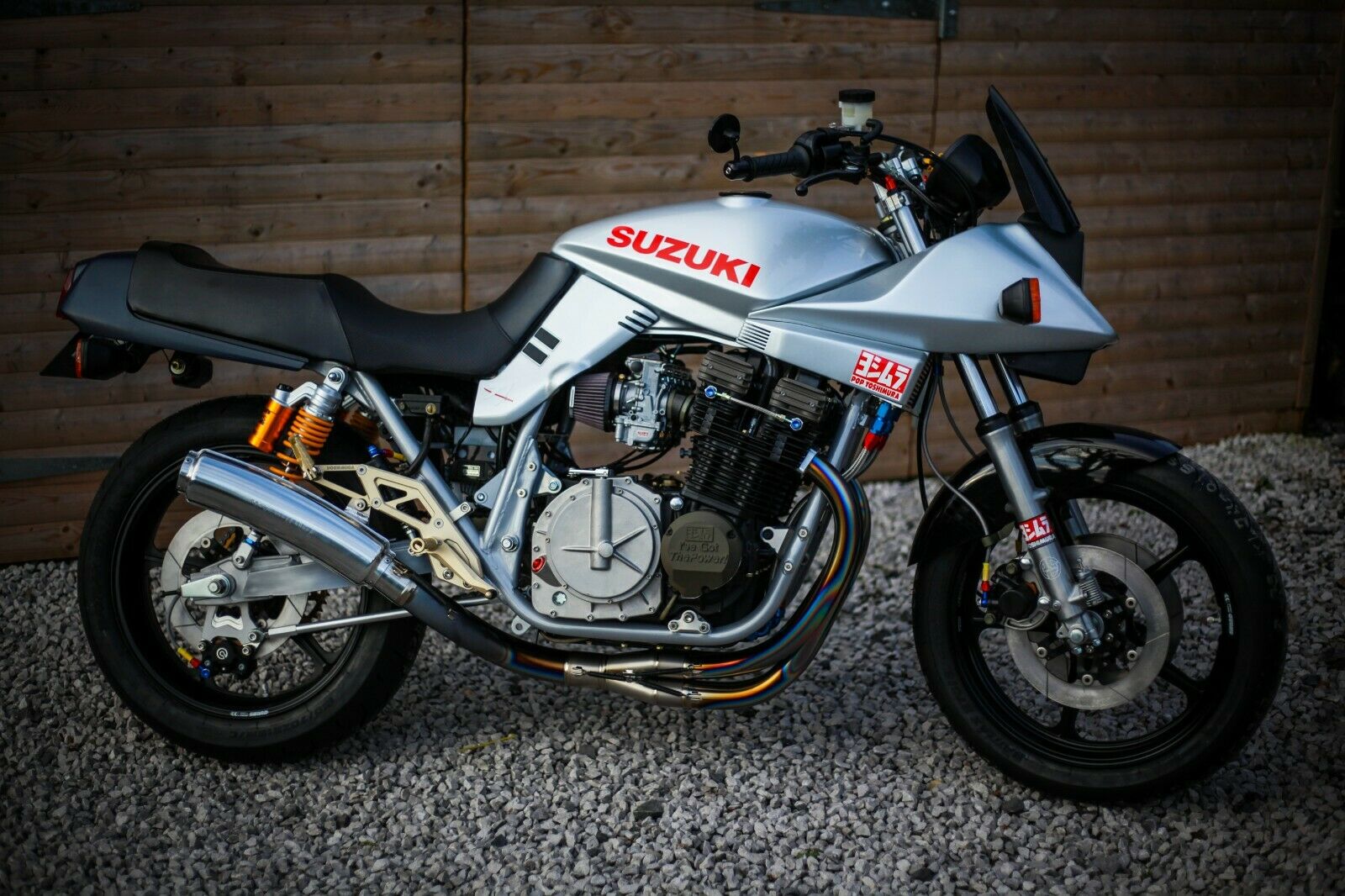

I've just had a problem with my 83 GSX1100 Kat. It looks like the cam chain tensioner nut had worked loose, the chain slackened way off and then she just stopped. Sounds like its dropped a valve or 2 (i hope) but it's in the process of being striped to check. Whilst its apart I'm thinking of some upgrades to get the engine performance a little closer to modern bikes. I reckon I'll be happy with around 120hp, more would always be better but I'm not a racer so needs to be usable around town, I like the way the way the power is delivered at the moment so I'd like to keep that aspect as much as possible.
I'm considering a re-bore, fast cams and some over sized valves, but I've no experience of this kind of work. It's already got 34mm rs mikuni carbs and a yoshi racing exhaust but the engine is completely standard at present.
Any tips or suggestions would be very much appreciated.

Guys thanks for the tips. I'm budgeting around £1500, keeping the carbs and exhaust. Ignition is already upgraded, as is the clutch and it's got got an over sized oil cooler fitted. I've been told about a complete Yoshi kit you can get with big bore pistons and fast cams which is what i'm leaning towards. Sounds the simplest option. Any one just done those mods? If so I'd be interested to know what kid of gains are seen.
Here's the bike.
