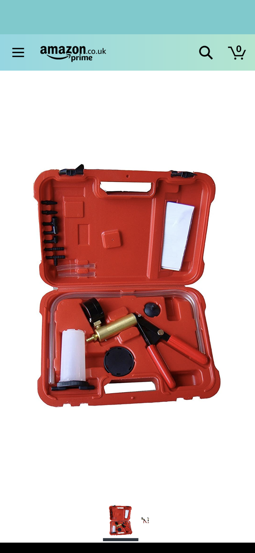

I use one of these. I makes bleeding brakes so easy.
£15 from Amazon.

Re: Leaky brake caliper
Yup I've got that exact one but even using that and lifting the calipers as high as possible I still struggled last time. I thought there might be a trick I'm missing somewhere?
I've not started the job yet so I'll let you know how I get on
