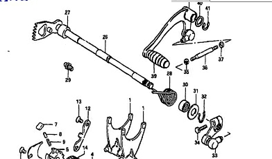

Post by Pedda » Sun Aug 22, 2021 12:57 pm
Have a look at the circlip part no. 32. If you lost it or it just found its way out of the notch, the gear change shaft might have moved a few mm to the rhs, pushing that little actuator gear at the right end out of action. Just a bit playin around with the gear shaft pulling it back home and securing the circlip again might do the trick.
Posts: 1519
Has thanked: 55 times
Been thanked: 201 times
Re: gearbox problem help please.
Post by Pedda » Sun Aug 22, 2021 5:45 pm
Errm... when I say rhs I mean riding direction wise obviously, not plain looking at the pic. But I bet you knew anyhow...
