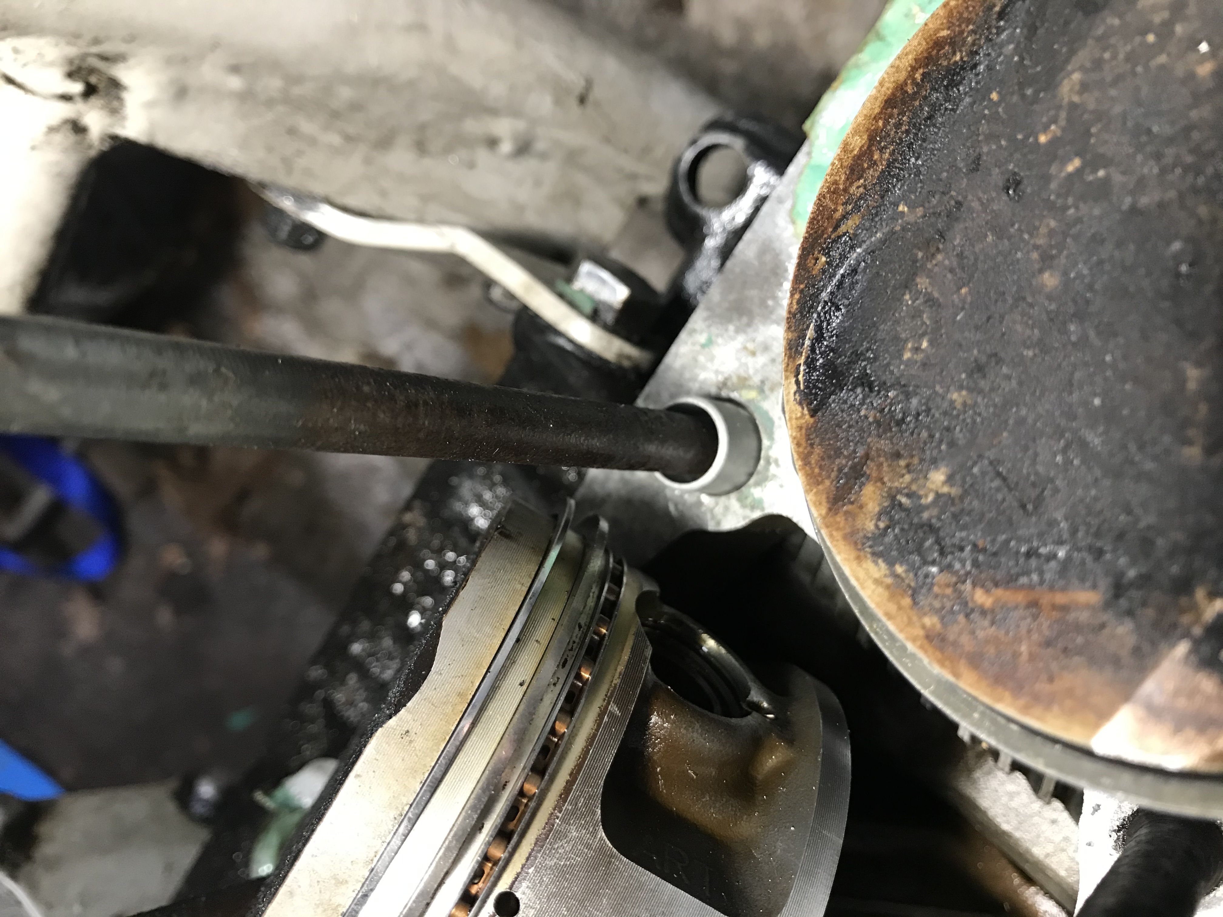

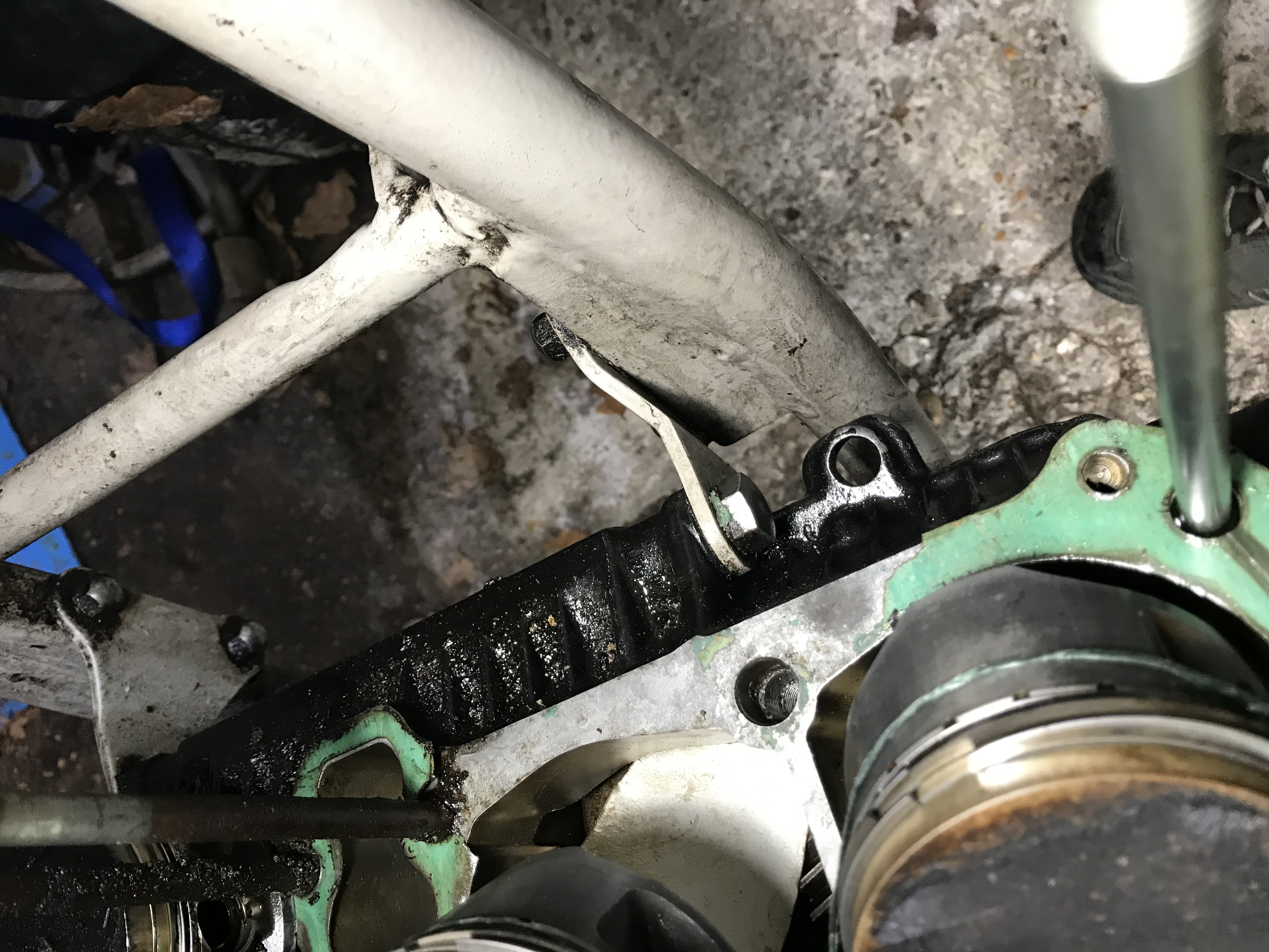

Post by katmarch » Sun May 01, 2022 11:32 am
Now I know why head was leaking, had to be one with the steel locating pin in the way :roll:

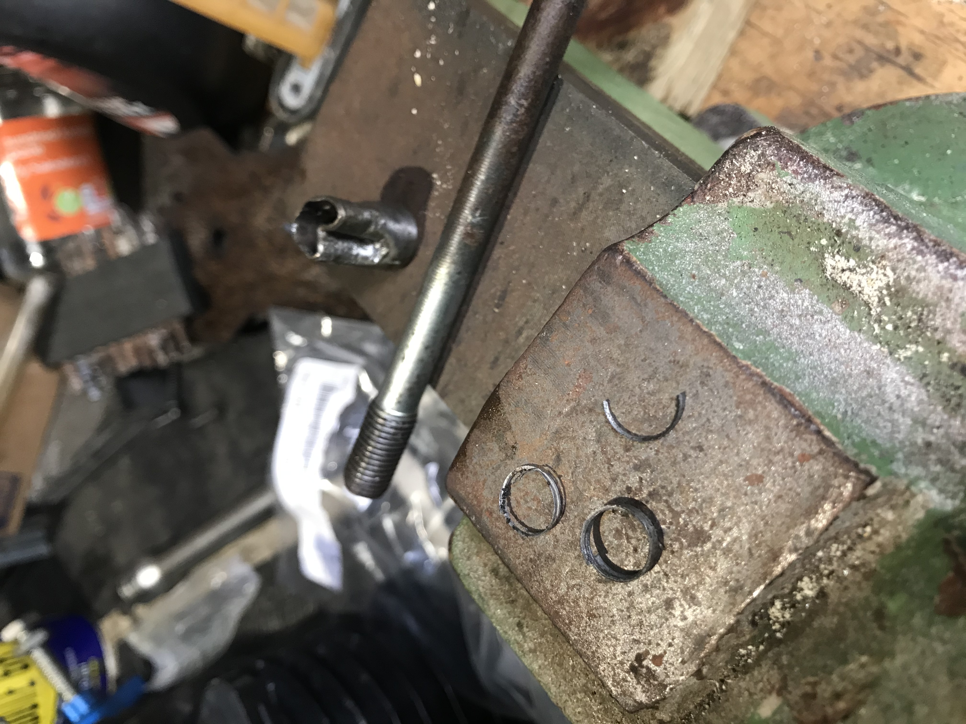

Post by katmarch » Sun May 01, 2022 3:08 pm
Better than new, just need to clean everything & put it back together

Post by Uncle Bob » Sun May 01, 2022 9:40 pm
Well done. Did you heli-coil it then fit a new locating pin or do another way? Always handy to know.

Post by katmarch » Mon May 02, 2022 8:33 am
Yep, very carefully, worst bit was removing the insertion tang from the recoil insert, without dropping it into the gearbox.
