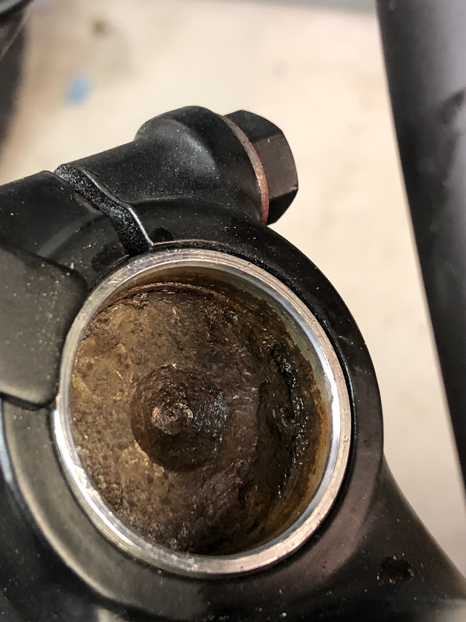

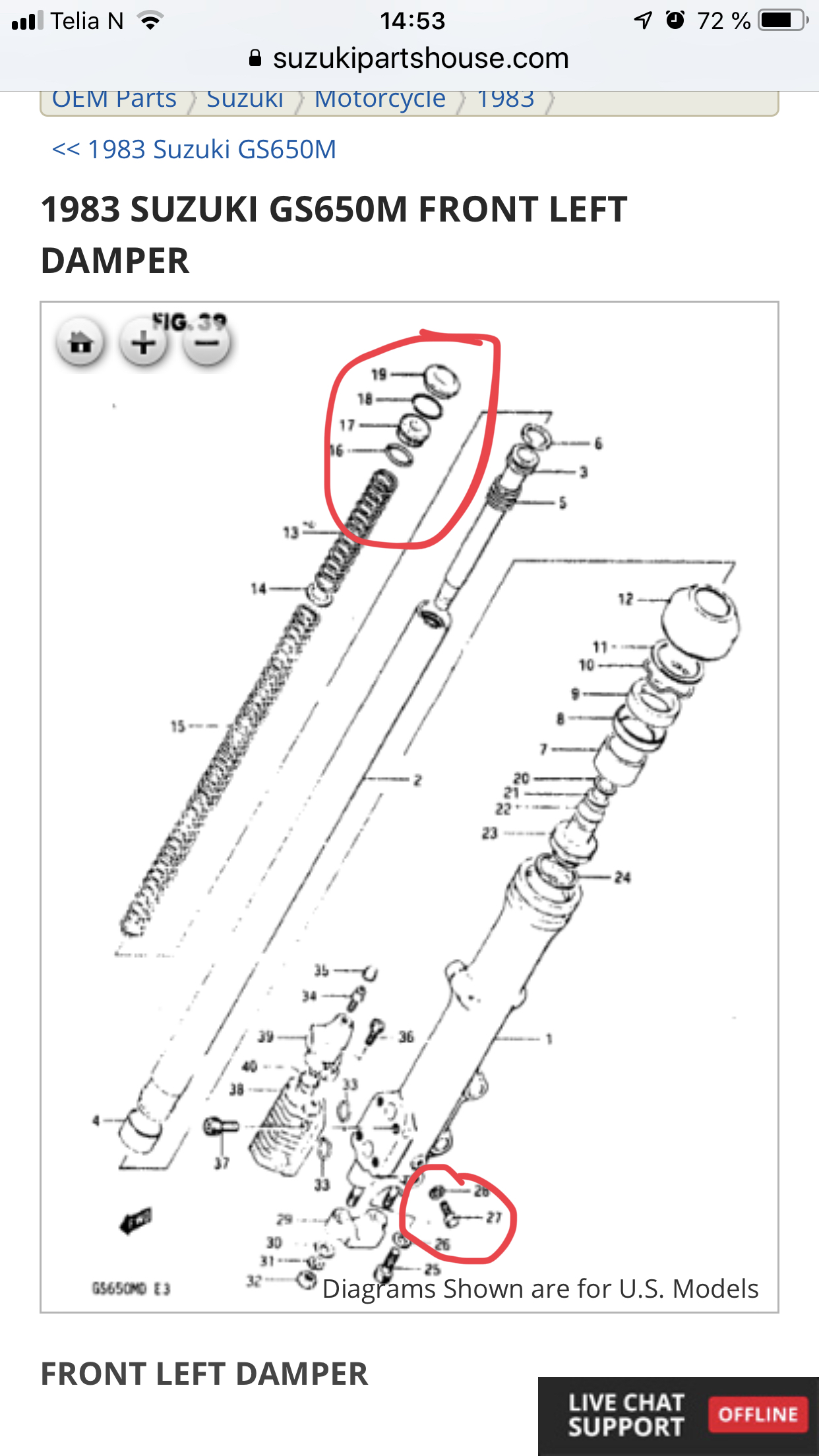

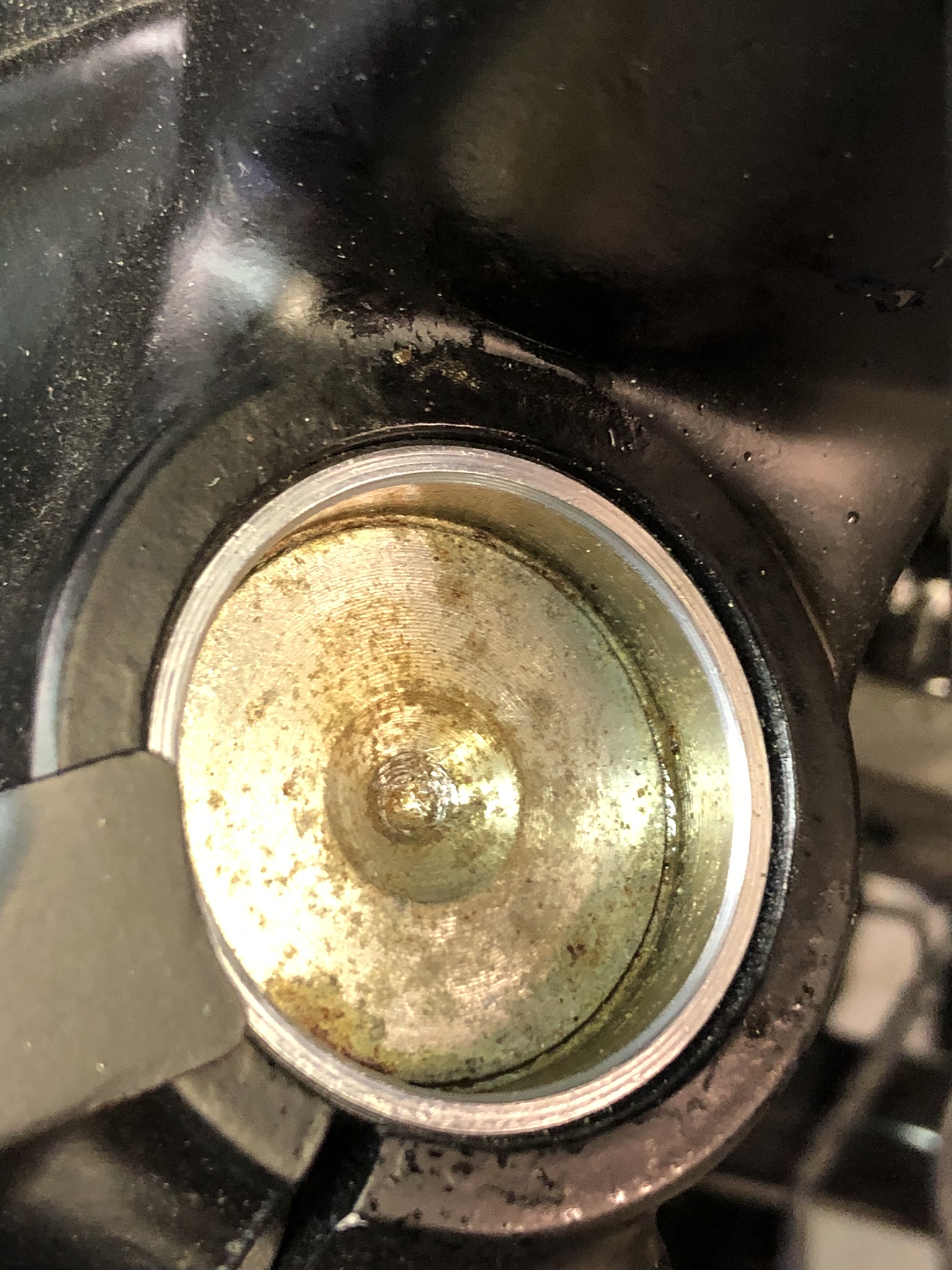

Thanks a lot. I just got home from vacation. I have taken some pictures and it is just as Blix showes in pictures from cms.
The only way to take the spring seat off is to dismantle the hole fork i think.
It look like I have to do the work.
I was hoping to drive 1.may. But think i have to delay it some weeks.

It will come out ,if you push down loosen clamp and dislodge the spring. But as said if that is what you intend .....don't bother you won't get the same amount in each fork, leaving you with what you have already.
If you have already drained out the oil , well you have no option but for future its best to ensure you have the means to refill before draining.
The best way to get the best handling is get the air gap the same in each fork. But again best with forks out.

yes, ok, you spray it liberally with wd40,pop it on the centre stand then you put a socket on top of the cap and whack it with a hammer to break any rust seal. when you feel that its moving as it is hit, get a socket extension bar, and a small flat screwdriver, press the cap down, then whilst its held down, use the screwdriver to pop the spring clip out, when its out, lift slowly off and the spring will push the cap out of the fork top. done this before on a gs1000 so im guessing theyre similar forks.
