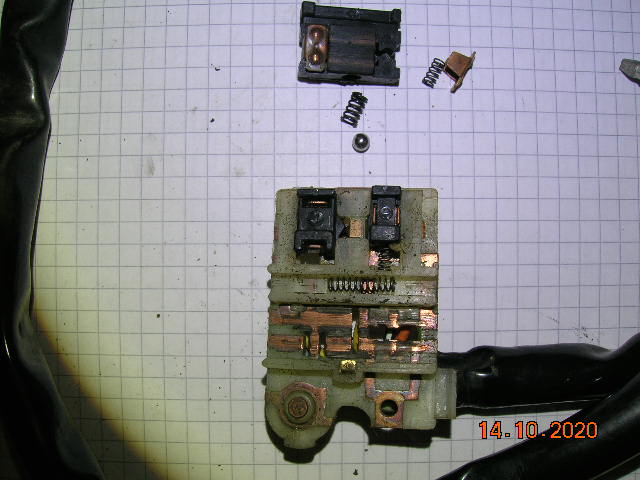

I had a bit of time this evening to strip the switch a bit further. I even managed to get it back together!
I have turned the centre sliding part over to show the underneath. There are two equal length springs under the copper contacts. The spring for the ball bearing detent is slightly fatter and longer. There is an even longer skinny spring for the left/right slider, and finally the up and down one, which is not shown in this photo.
You need about six hands to put it all back together. I had to tie the slider and up/down spring with its cover all up in one, with lots of turns of cotton, which I then could cut once the switch assembly was back in its housing. I don't know how reassembly will work with the thumb knob in place.
Good luck!
David.

That's brilliant...thanks David. Can see from that how it all fits. Thankyou for taking the time to strip down yours. Cheers mate :D :D
Jerry
