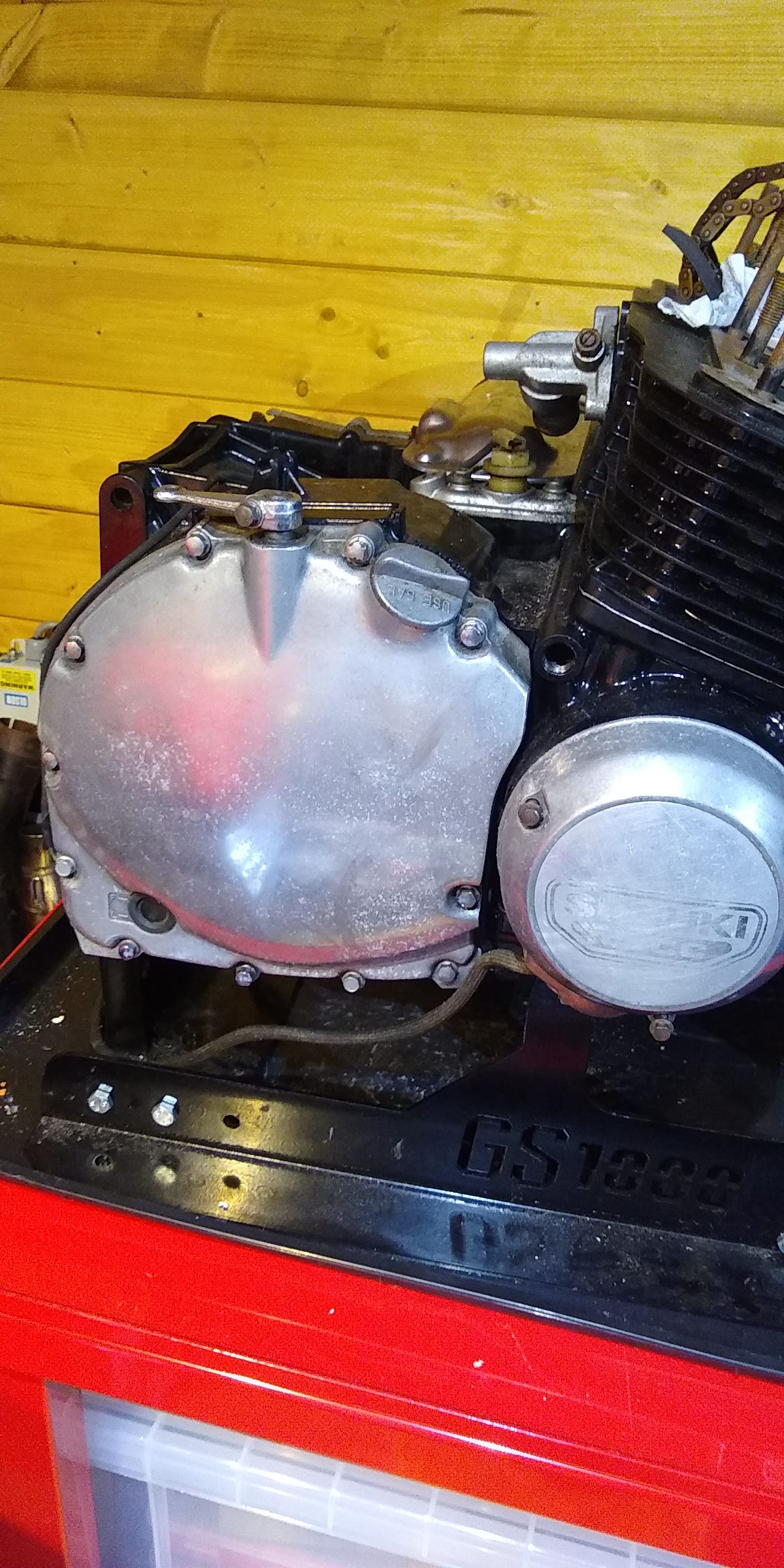

However I did have a look at the Thou motor on the bench. And took some photos.
The Thou motor looking like it needs some TLC

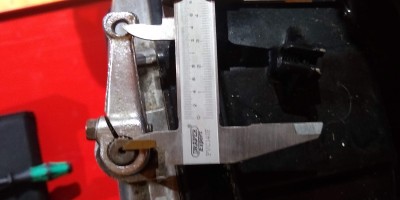

Centre to centre on the clutch arm 50mm. A shorter arm would give more lift on the clutch but would need more effort. A longer arm would give less lift but be lighter.

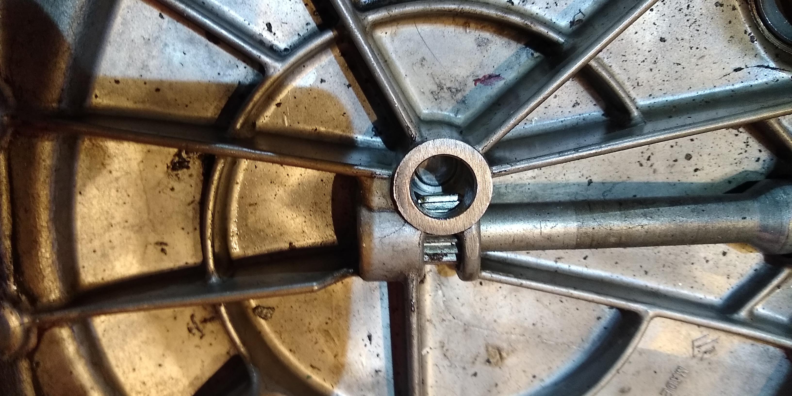

Inside the clutch cover. The Pinion bit of the Rack and Pinion. This is free to spin, and the first bit of setting up the clutch action is to remove the arm, turn the splined bit that the arm fits onto Anti-Clockwise (Counter Clockwise for Bikeazoid
), looking down from above, to take up any free play before re-fitting the arm as near to 90 degrees to the clutch cable as you can get. Ideally the main effort of the clutch will be with the cable at 90 degrees to the arm.

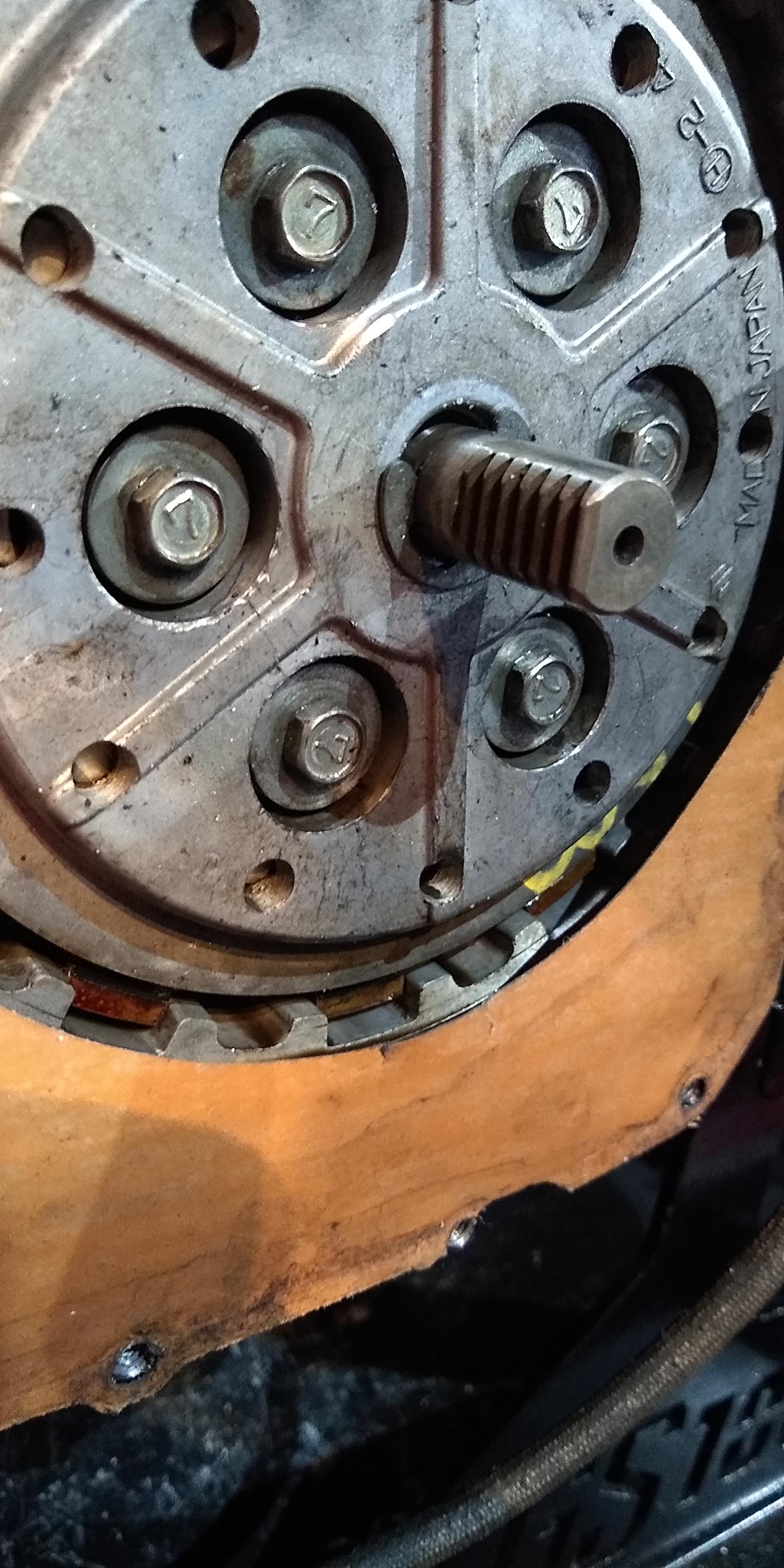

Rack bit of the Rack and Pinion sticking out of the clutch centre. This is where the free play is that you need to take up when setting the clutch actuator arm.
Behind the clutch centre the Rack bit pulls against a radial needle bearing lifting the clutch centre plate and compressing the springs. And so unloading the clutch pack.

Given that learning never stops. Today I have learned that my poor old 998cc Kat motor has been visited in the past by a “Silverback” armed with percussion tools and a tub of sticky gasket. It may well be that the Donkey goes back to aluminium silver rather than remaining black. Also that (FFS) there are a couple of threads for the clutch cover that need repaired
and a missing dowel.
