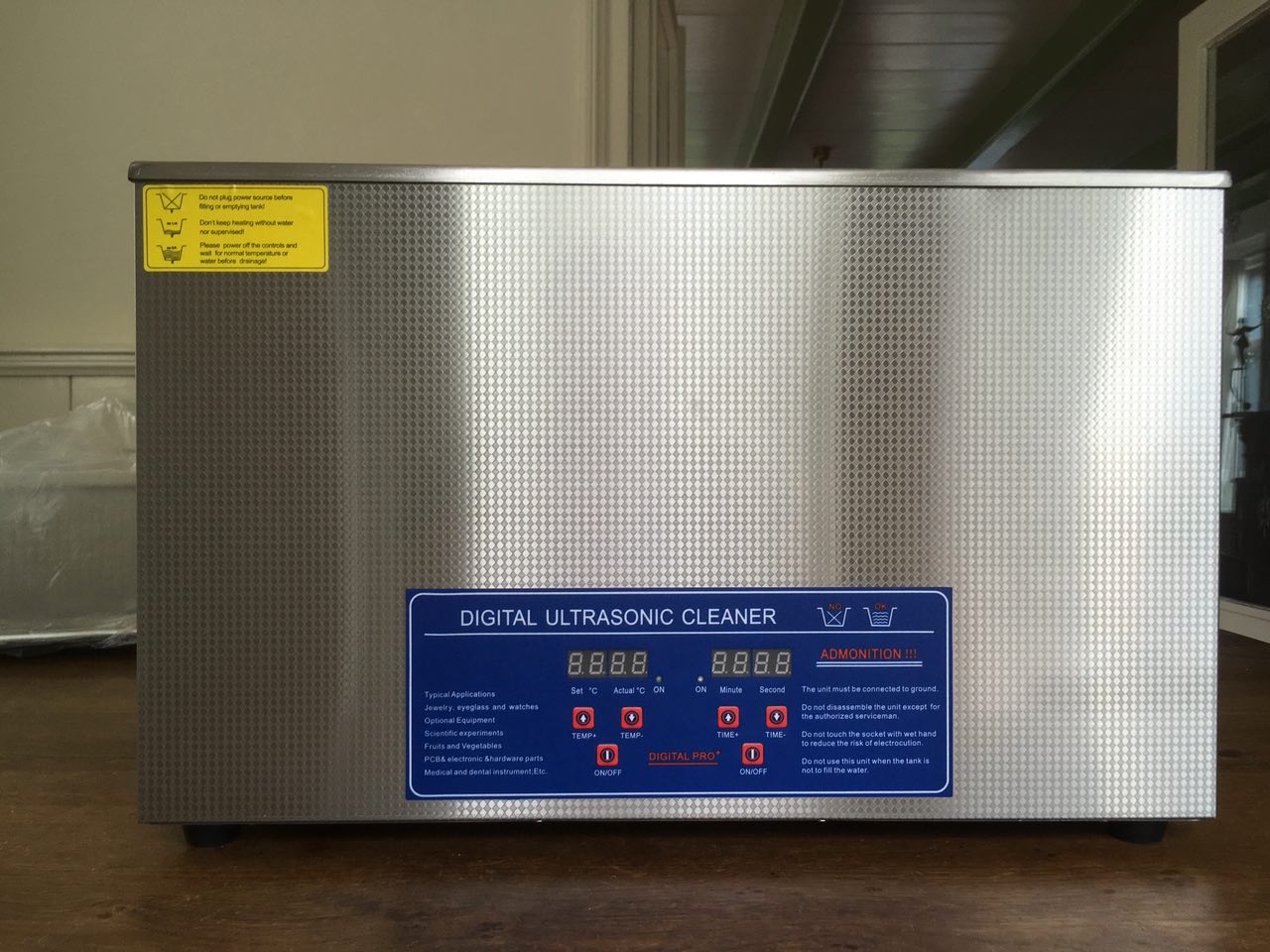

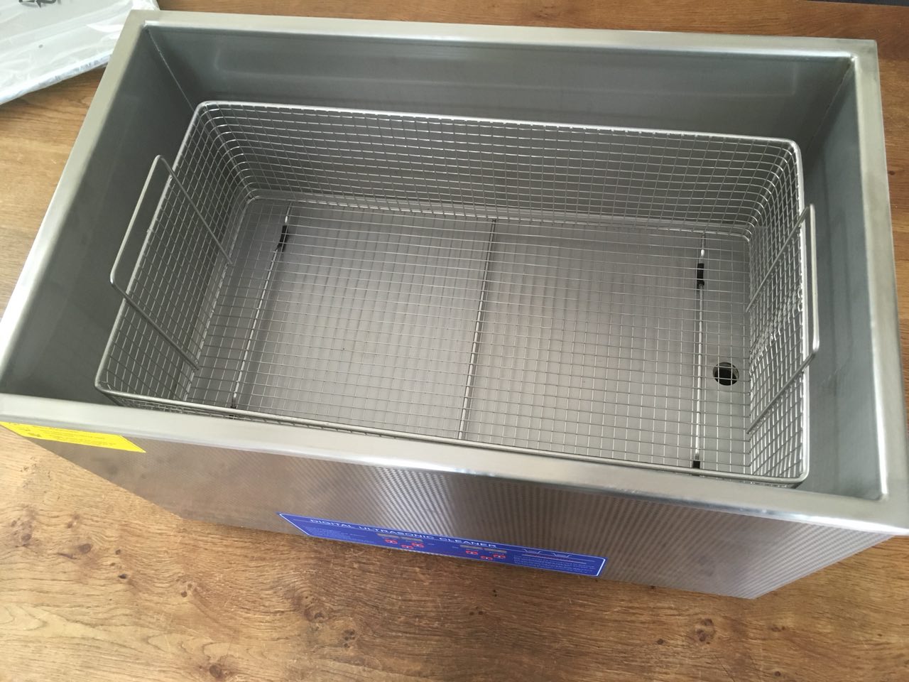

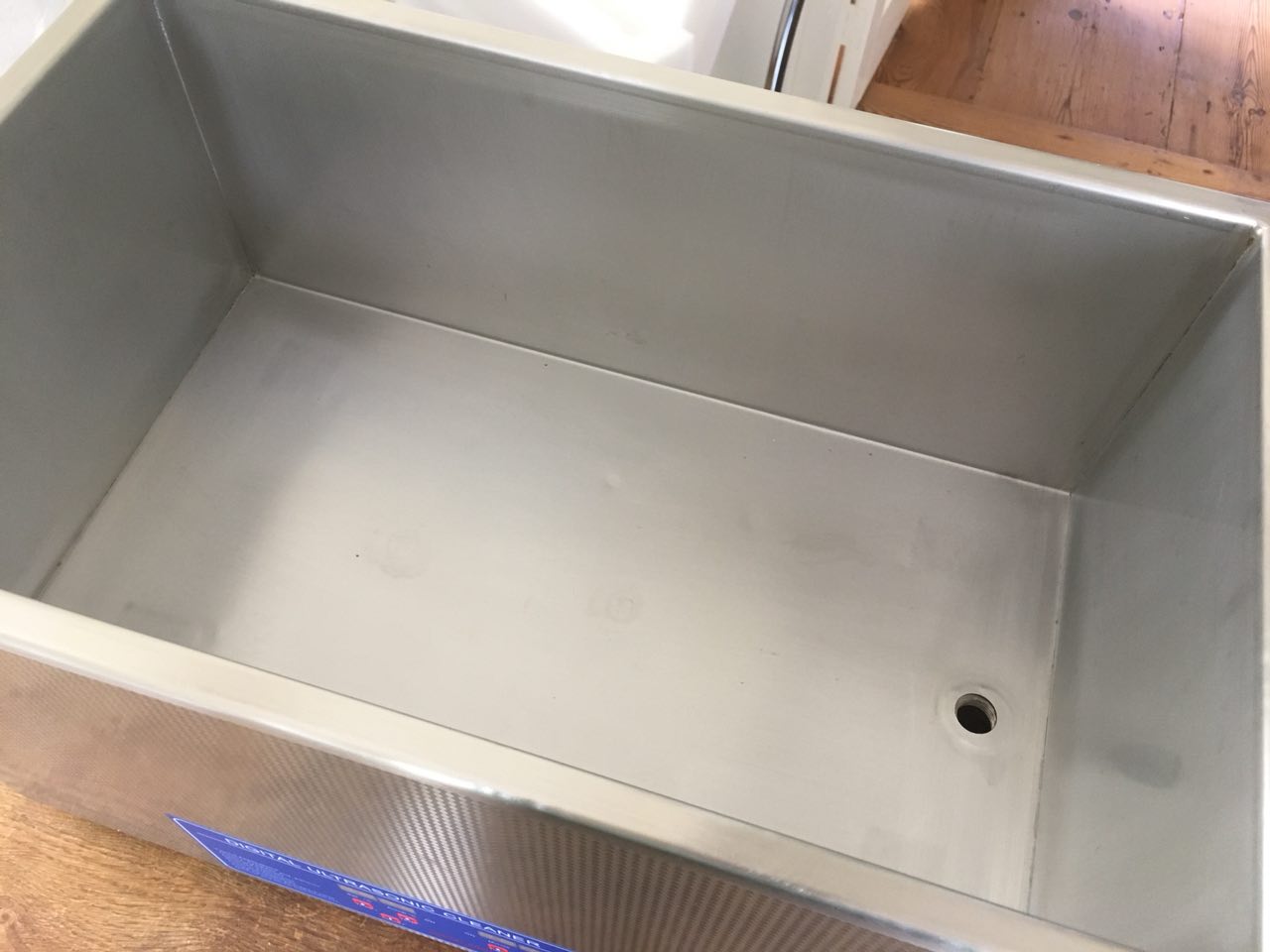

I do agree with Paul, bigger is better. I used to own this absolute chonker but it blew up within a year and I was SOL. Got a small very cheap one now that has lasted way longer and works fine. My next big one will be an ex laboratory EMAG but you're looking at upwards of 500 quid for one of those.
Could almost swim in that :lol:

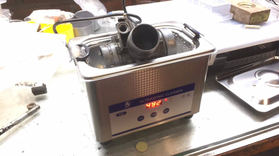

Post by Lexdba » Mon Sep 21, 2020 3:38 pm
I believe this is a 1L and fits half a carb. So I'd say a 3 should do the trick!
