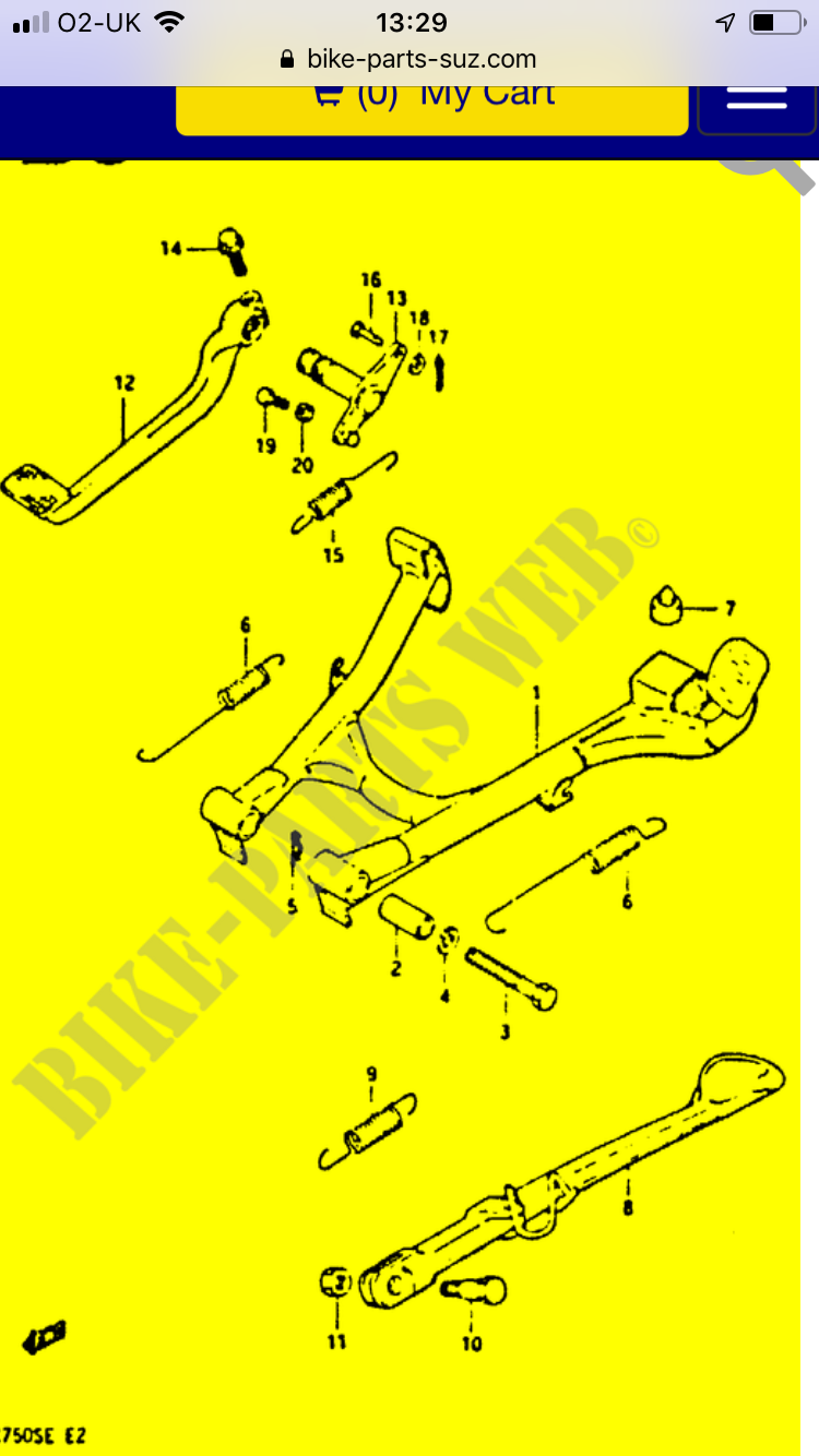

Okay I’ll be careful how I ask this question, where does item 7 go? :roll:

Post by Kryten » Sat Jun 06, 2020 1:48 pm
Must.......
Resist......
:D
Probably on the LH exhaust silencer
Stops the centre stand clanging against the silencer or coming into contact with the chain

Post by Berti44 » Sat Jun 06, 2020 2:16 pm
Hi Blix yep it’s a rubber bung, but no hole for location on the centre stand or swing arm, those were my thoughts too.
I think Kryten has probably solved my query but not got to the stage of fitting the exhaust which is motad Neta.
The centre stand at the moment does hit the chain. Thank you both for your reply’s 👍

Post by pop-up » Sat Jun 06, 2020 4:58 pm
It fits to the LH exhaust bracket. If you have the bracket you can fit it and stop the stand fouling.

Post by fossie » Sat Jun 06, 2020 7:49 pm
If you have a Motad system fitted the bung goes on the mounting bracket to stop the centre stand fouling.
If you have a Motad Neta system you will need to adjust the silencer just after the collector with a ball point hammer to accommodate rear brake lever travel!
