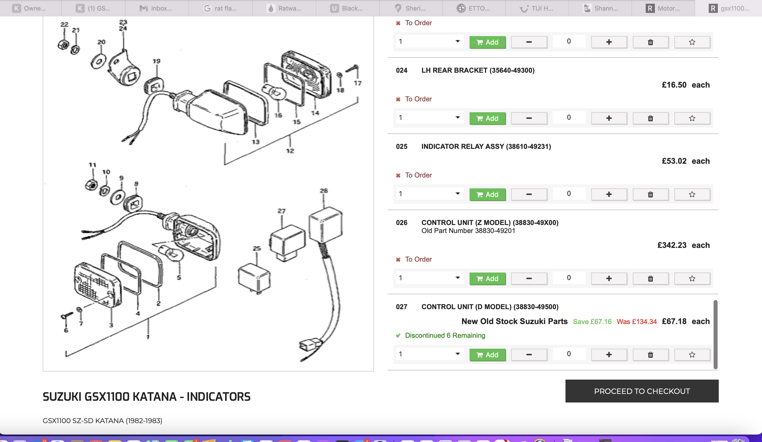

Robinsons still list them for the the SD at a discounted price....

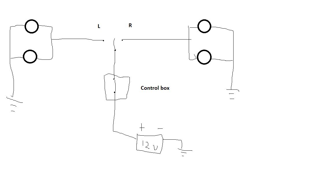

The control box is just a bi-metallic switch, when the load of the 2 bulbs pass through it, it heats up bends & breaks the contact, cools re makes the contact, the box should have some rating on it like 2 x 21w, so you need to ensure the correct wattage bulbs are in the indicators, otherwise odd things happen.
