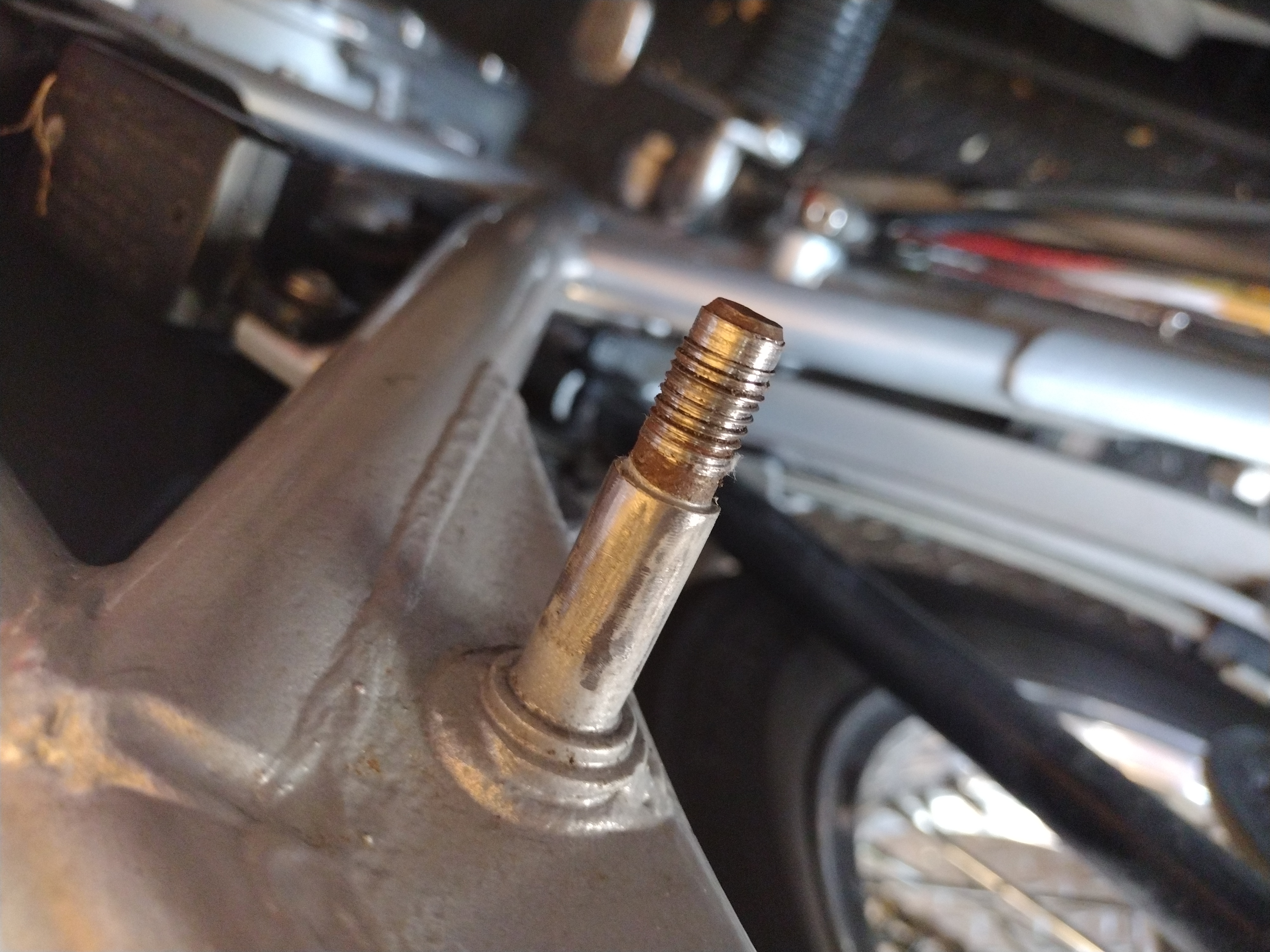

Was fitting the rack to the Kat when the thread on the upper suspension mounting gave up the ghost!
Prior to me getting the bike it had clearly been subjected to someone trying to fit M10 x 1.5 nuts to the mounting point.
Now trying to source a thread file to repair what’s left. There should be enough if I can get a hold of one.
If no joy then it’ll be the Speed Trip for me…

I do have a Ventura rack and bits. But I think Skruffy Kat's rear is slightly on the huh!* As when the thing is assembled the rack or the grab rail won't lift off.
I've borrowed a metric thread file off someone I've never met (the up side of social media!) So tomorrow I'll be spending a fair amount of time staring at the upper suspension mount before committing with the file
Think there's enough thread to recover. Won't be pretty, but should be strong enough. A proper repair will need a visit to an engineering shop...
*Norfolk for not quite square

Or whack a slightly different threaded nut on and keeping turning ....the fix of fucket approach .
- Posts: 1827
- Has thanked: 128 times
- Been thanked: 269 times
Re: There’s a chance……
That was the start of the problem I think!

Left it for a day. And using the borrowed thread restorer, got cleaned up and sorted!
Good to go now, but by God, it's hot and humid!
