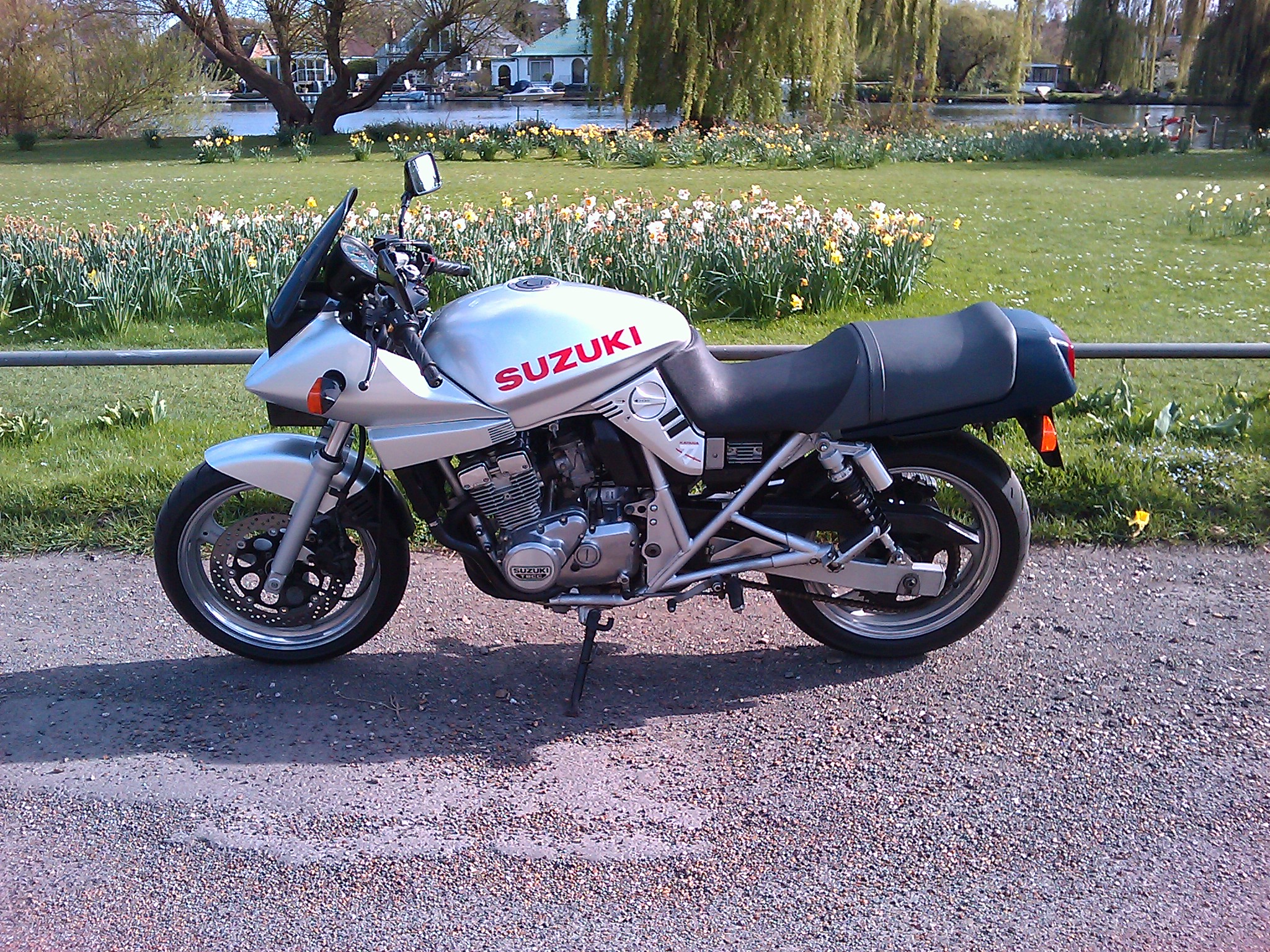

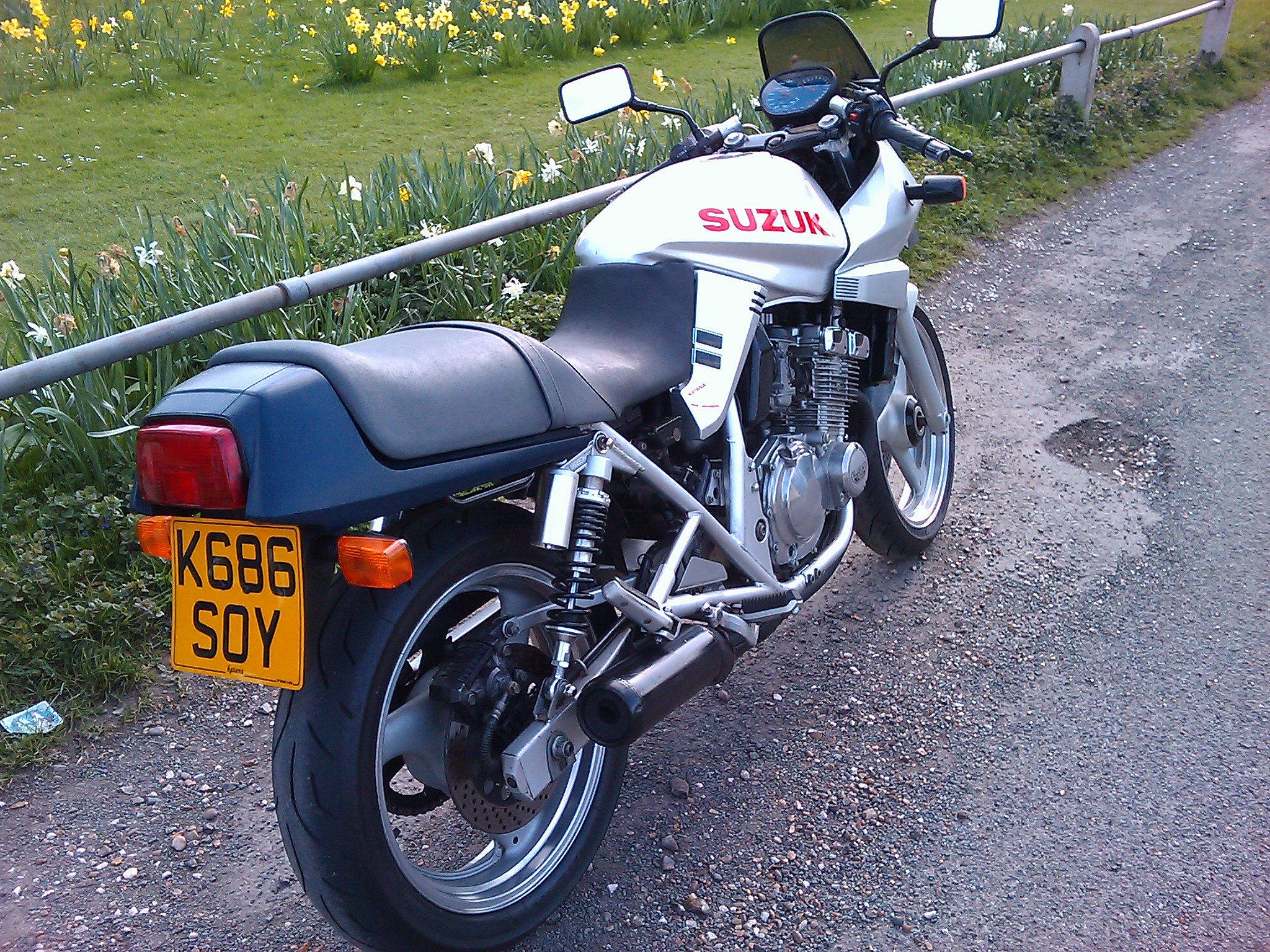

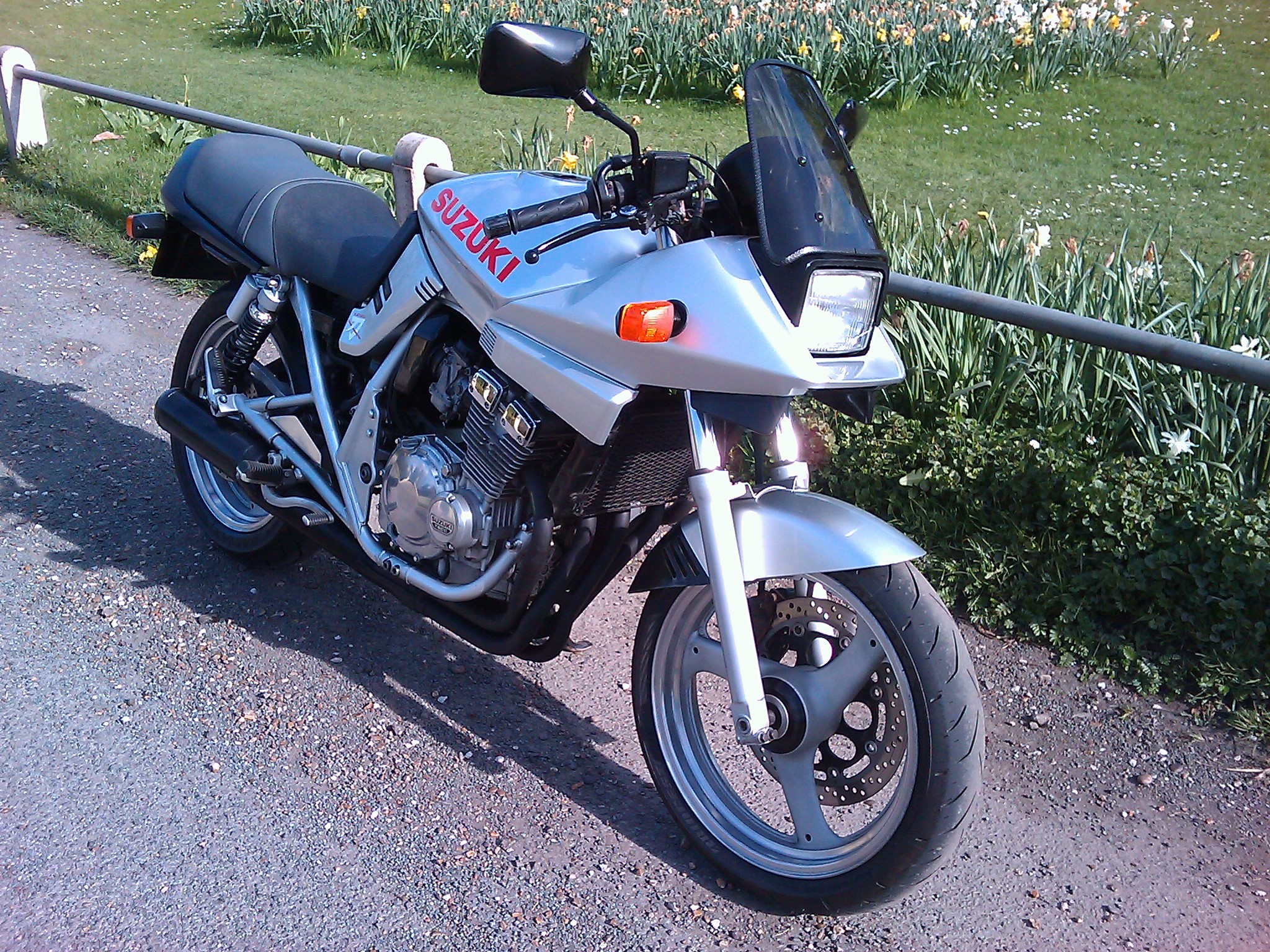

When I first got my 250 Kat it took an age to fire up, after it eventually started it was fine, the problem was a tiny hairline crack in the vacuum pipe letting air in, I also fitted NGK iridium spark plugs (code CR8EIX) after having the carbs ultrasonically cleaned and viton synthetic o-rings fitted, and I always use Esso supreme unleaded fuel as its supposed to have no ethanol in it if you buy it south of Watford, as I knew It was going to be a keeper I tried to future-proof it as much as I could, it still fires up and runs great over eight years later
Re: 250 fuel starvation
Pooks, you really are the exception and you are just lulling people into a false sense of security! Then you add insult to injury by adding a picture of your immaculate 250.

Think the iridium plugs last longer, which is great 'cos getting them out and back in again can be a chore (had to buy a very thin plug socket from e-bay) sorry Smallkat, don't mean to keep putting pictures of my bike on here but the only thing better than riding a 250 Kat is looking at one
