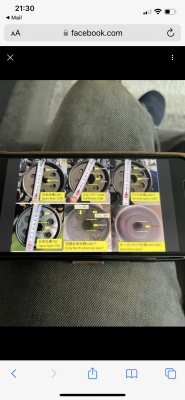

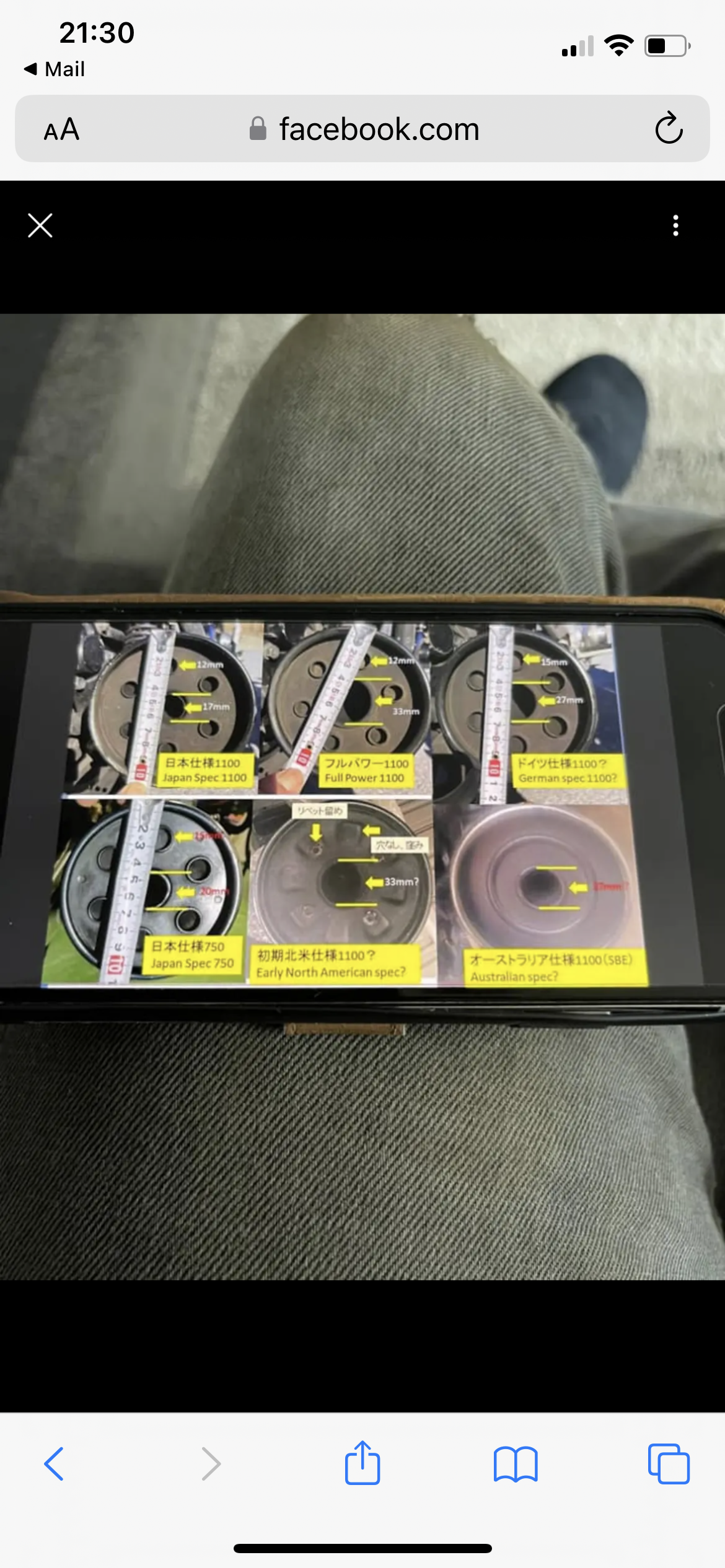

Lol great question. Sometimes folk advertise stuff wrongly, but provide photos.
Just trying to recognise from different areas of exhaust as to what is what. And can rule of what’s no good. Also info Like numbers etched on the end can four digits between asterisks x3132x etc

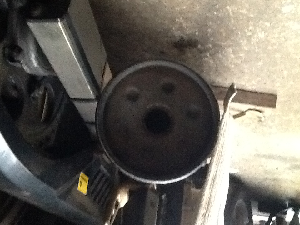

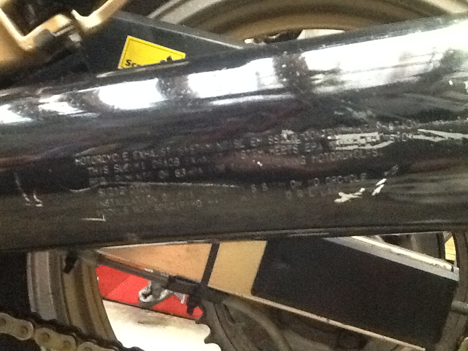

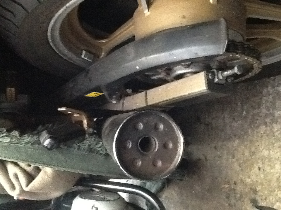

An extensive search in the Katcave ...basically I moved a 650 to gain access to the pop up exhaust , reveals their are NO id numbers on the original 750 SE ( pop up ) exhaust
I suggest because all ES derived models had the same system .
The photos show the end of both the original system and the system for the GS 700/750ES US market
Fitted to my pop up.
