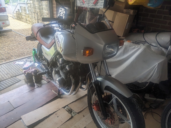

with a new to me GS650G Katana.
Bought cheaply off ebay, with a known starting issue, it has new fork stanchions, rear shocks, tyres, battery, starter solenoid and brake pads. And some dubious looking silencers.
On inspection, the starter motor was goosed, much as I expected.
£174 later, it's replacement in situ.
only problem is that the battery terminal mounting post is slightly longer than the original and touches the starter motor cover - I spaced the cover ever so slightly to clear it. Motor now spins sweetly on the button.
As the carbs had to come off, I took the opportunity to send them to my mate for stripping / cleaning / rebuilding - still awaiting their return.

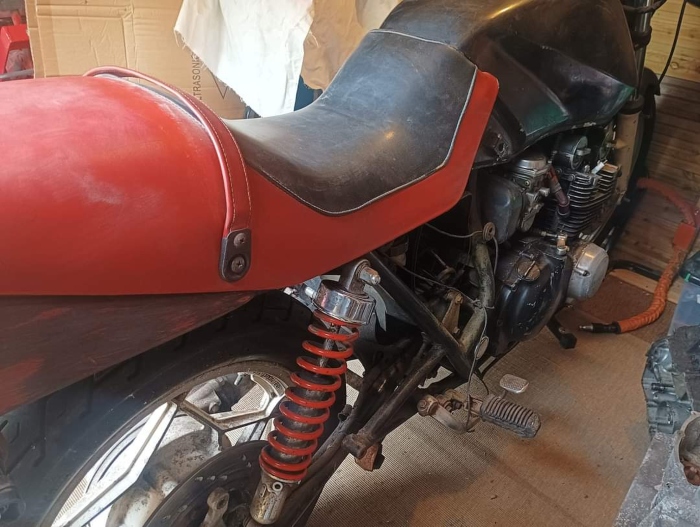

I have also acquired a second 650 - it appeared on Facebook and the price was right so I bought it. It came with 8 boxes of used spares + wheels, swing arms and even a decent 4-1 exhaust! Not sure what to do with this one - I am tempted to restore it to as near as standard as possible - to which end I am snaffling any low-priced new parts that appear for sale.
