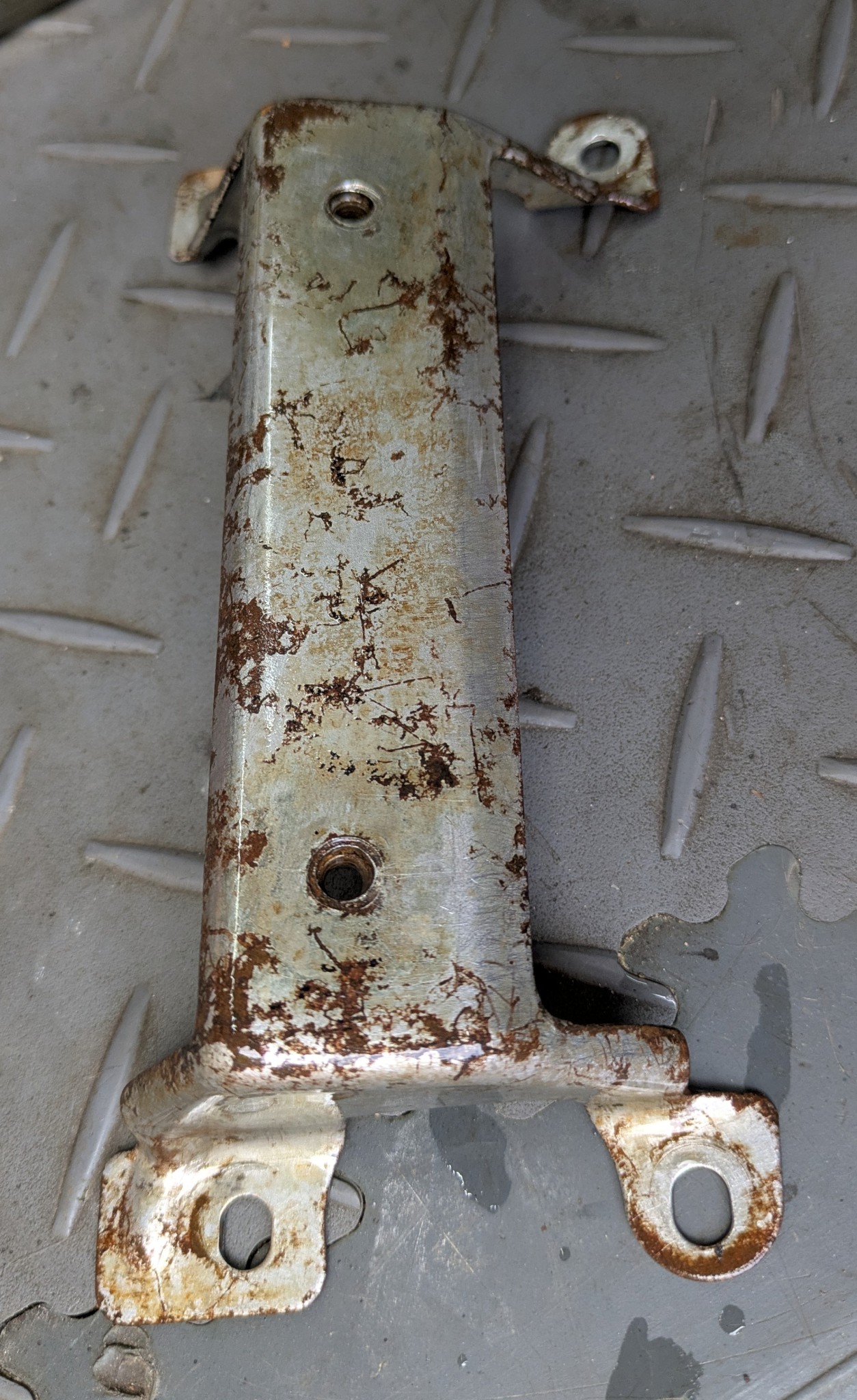

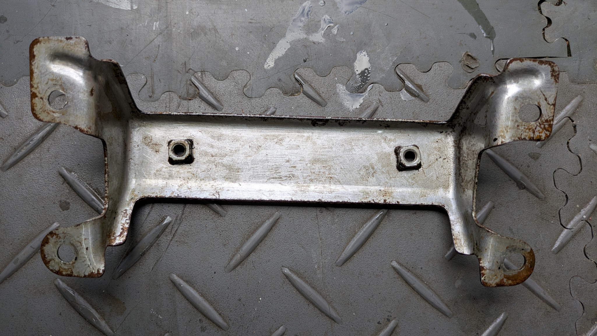

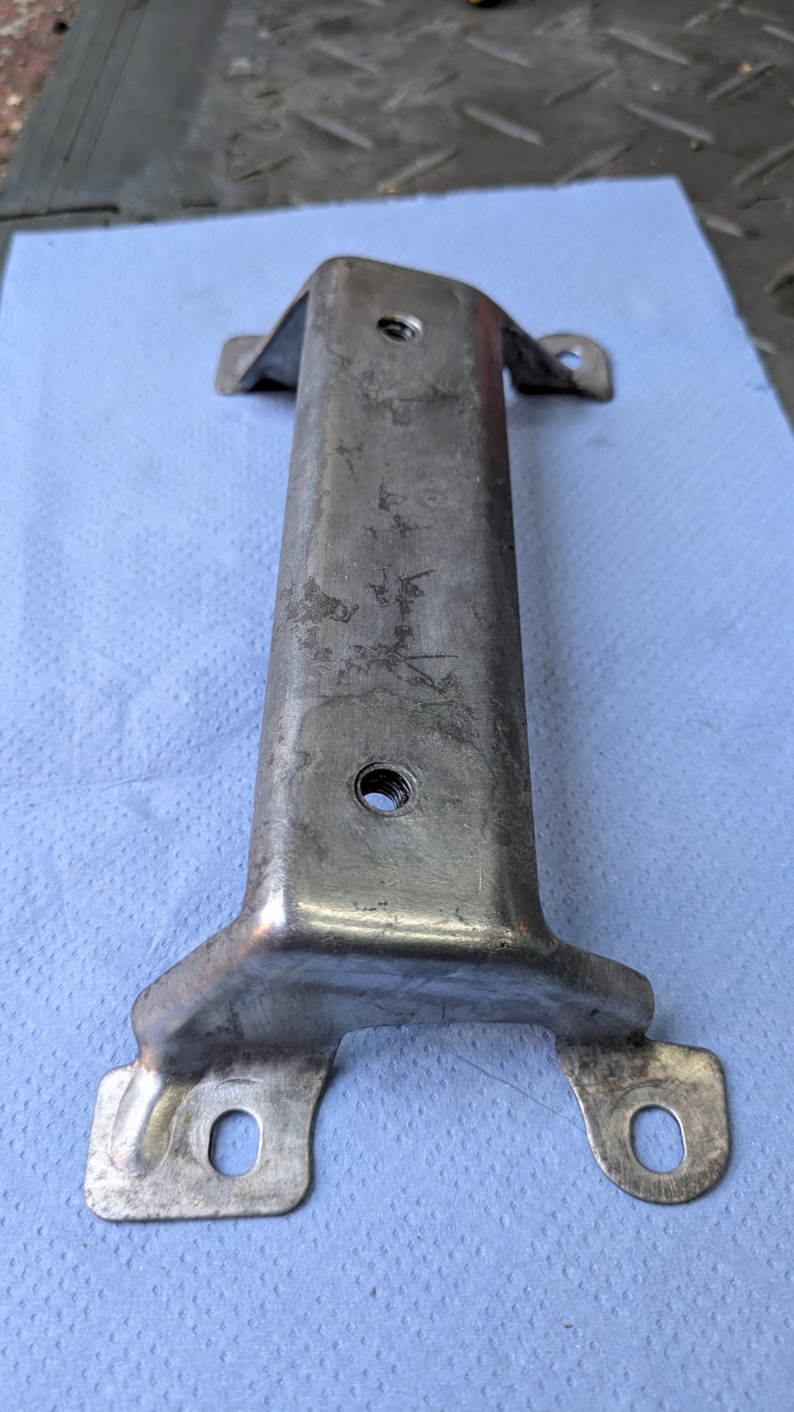

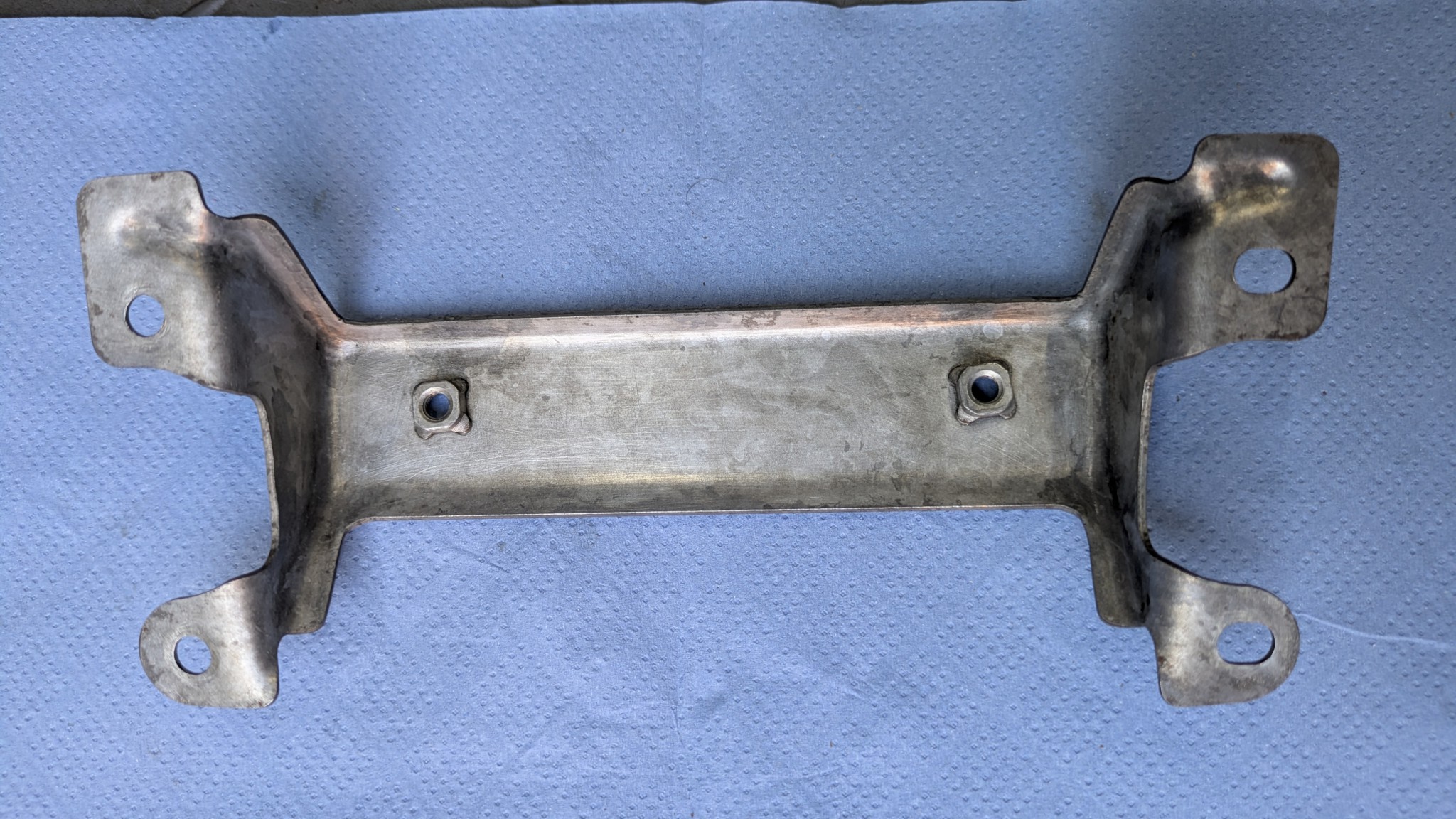

I have paid for rust remover but watch this video - https://www.youtube.com/watch?v=fVYZmeReKKY, the guy does guns and compares his own formula (which he gives you) to Evaporust very thoroughly indeed, even weighing test pieces to compare metal loss, it really is worth watching and you'll never buy de-rusting solution again and this is so cheap to make! I used his formula on some of my 250 parts, see images.
You might have to give it a little hand with a wire brush every now and then if quite rusty, but I thought it worked really well. I did these before painting and also some other parts, like nuts and bolts before zinc plating (also fairly easy if you are happy with a duller finish then the bright zinc which an industrial plater would do).
