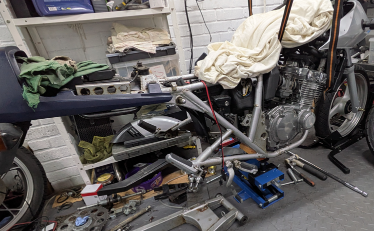

The swing arm is off the 250 so I couldn't use the Abba stand, so I used the lift under the back engine mount, with a piece of wood to give some protection. Also as a precaution I used a ratchet strap around the frame and up over the rafters. Are you taking the forks apart? That's always a joy! I do have the Suzuki tool to help with that, I can send a pic if you like.

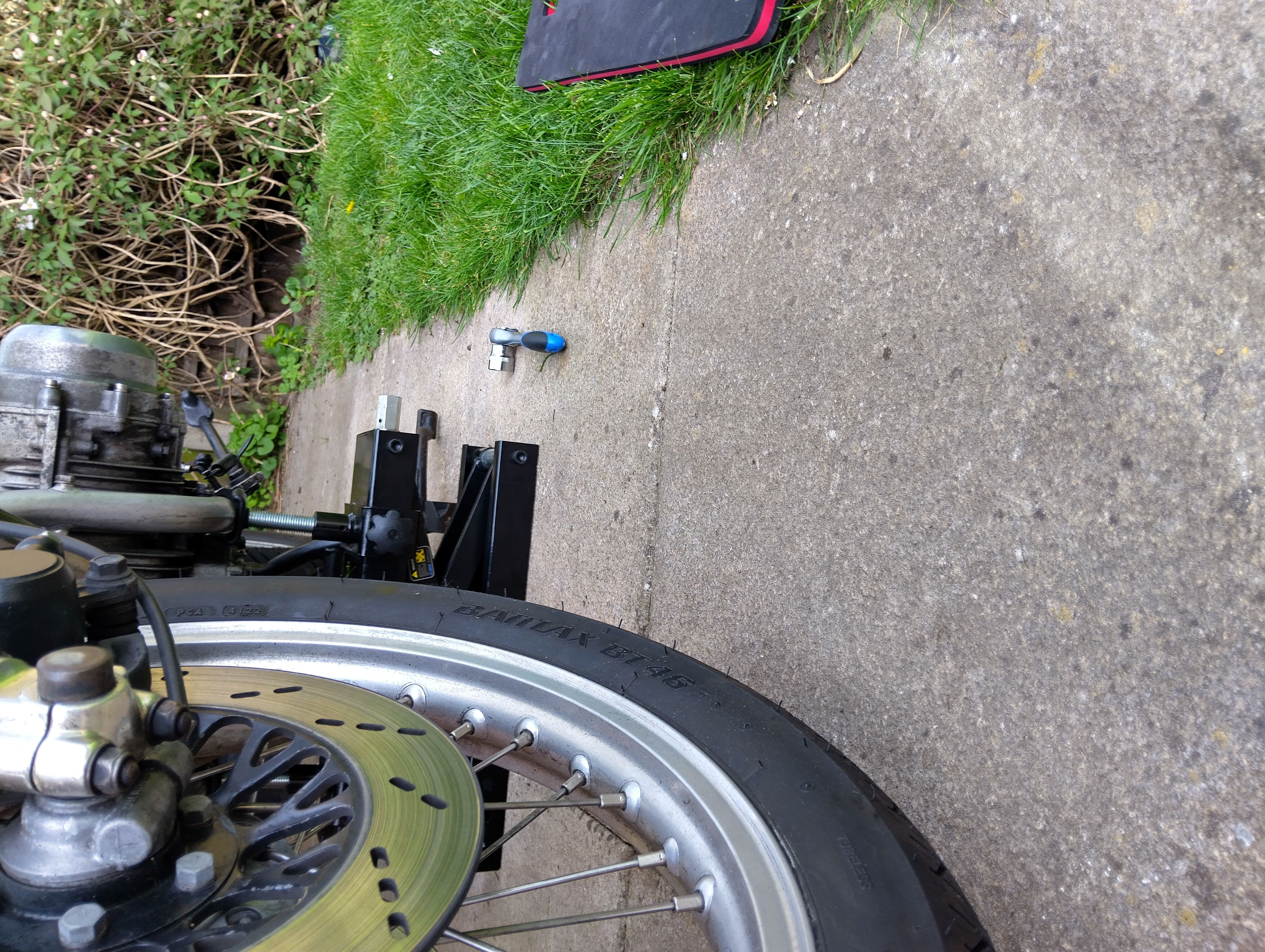

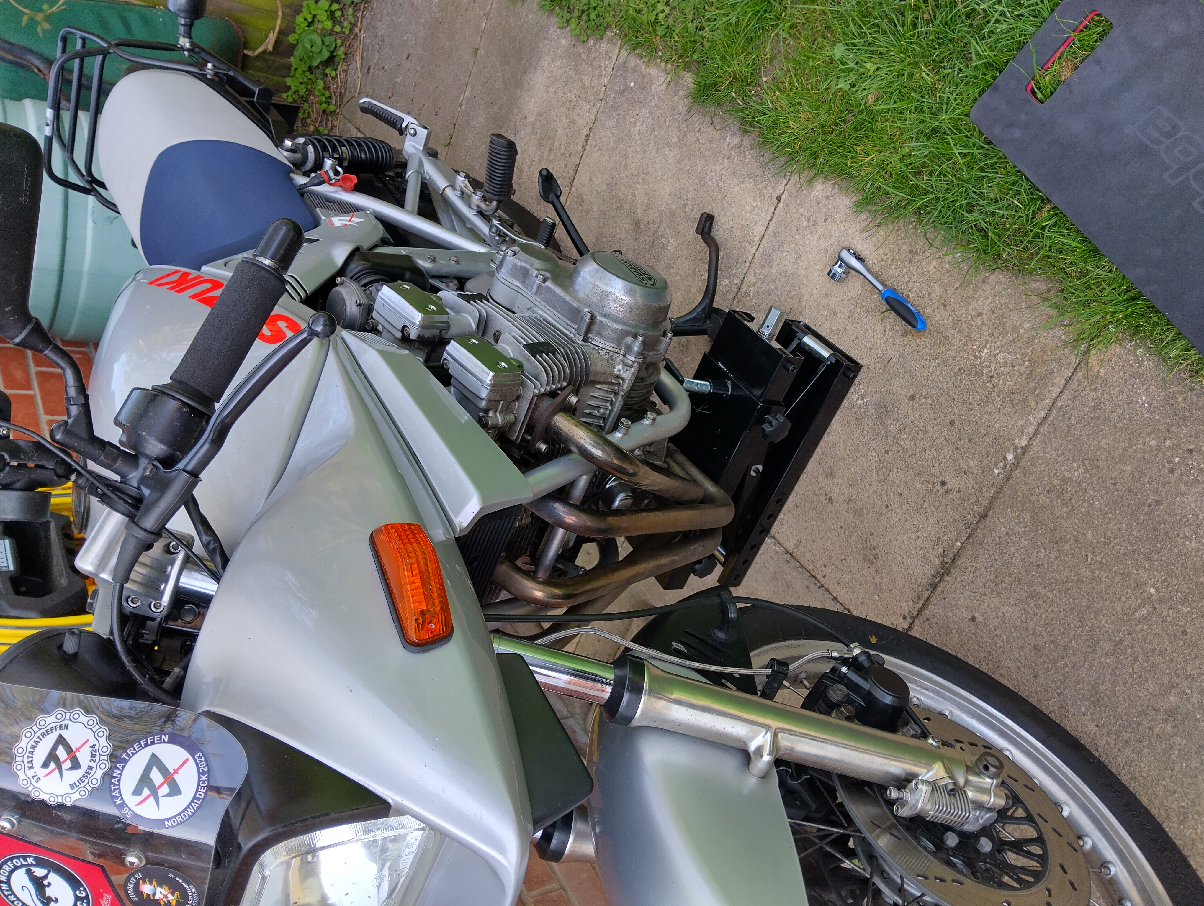

Kat on centre stand and scissor jack
Jack placed just forward of the lower engine mounts
If you’re juggling about with front end, I’d put a block of wood under the rear wheel just to stop it from rocking backwards as you’re heaving on the forks.

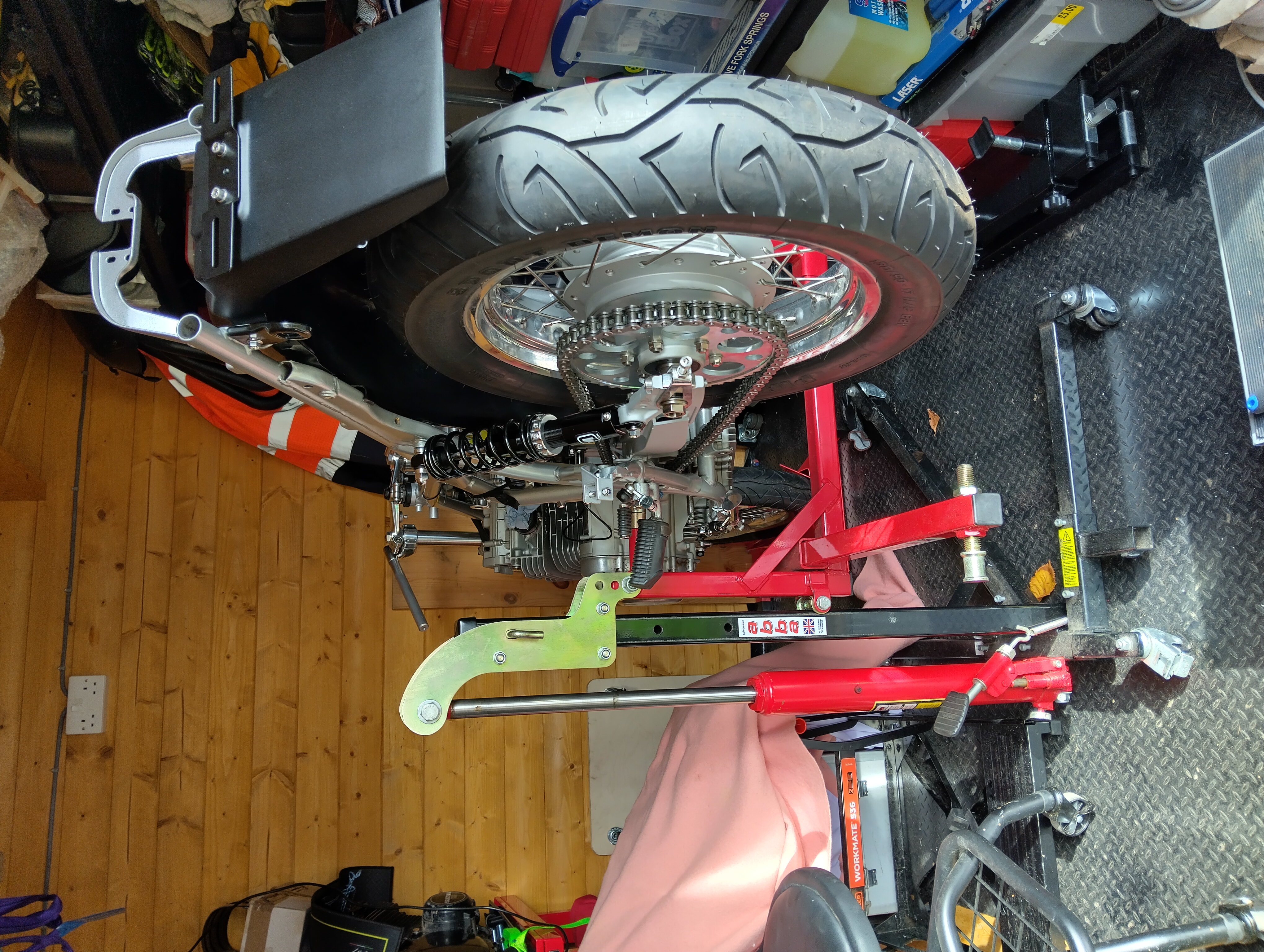

Kat on the Skylift, lifting the back end up to allow the new chain to be fitted
