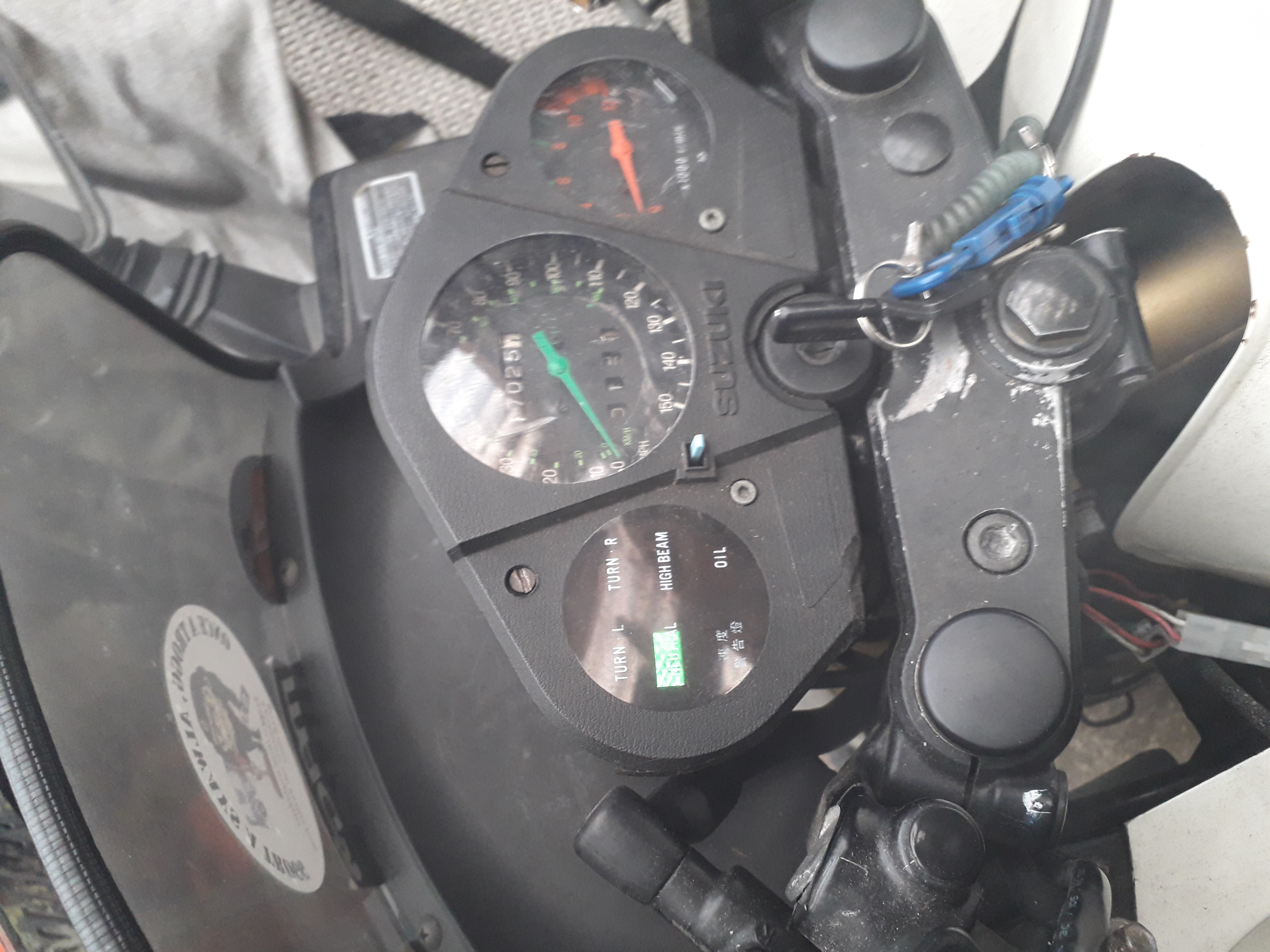

To celebrate the new classification of Historic :D I attatched a battery, turned on the prime position .. prodded the starter a few times to get some oil up top .. waited a few minutes and
it's away a little reluctant but not worrying so . 1 minute on choke and te picture shows the idle 8-)

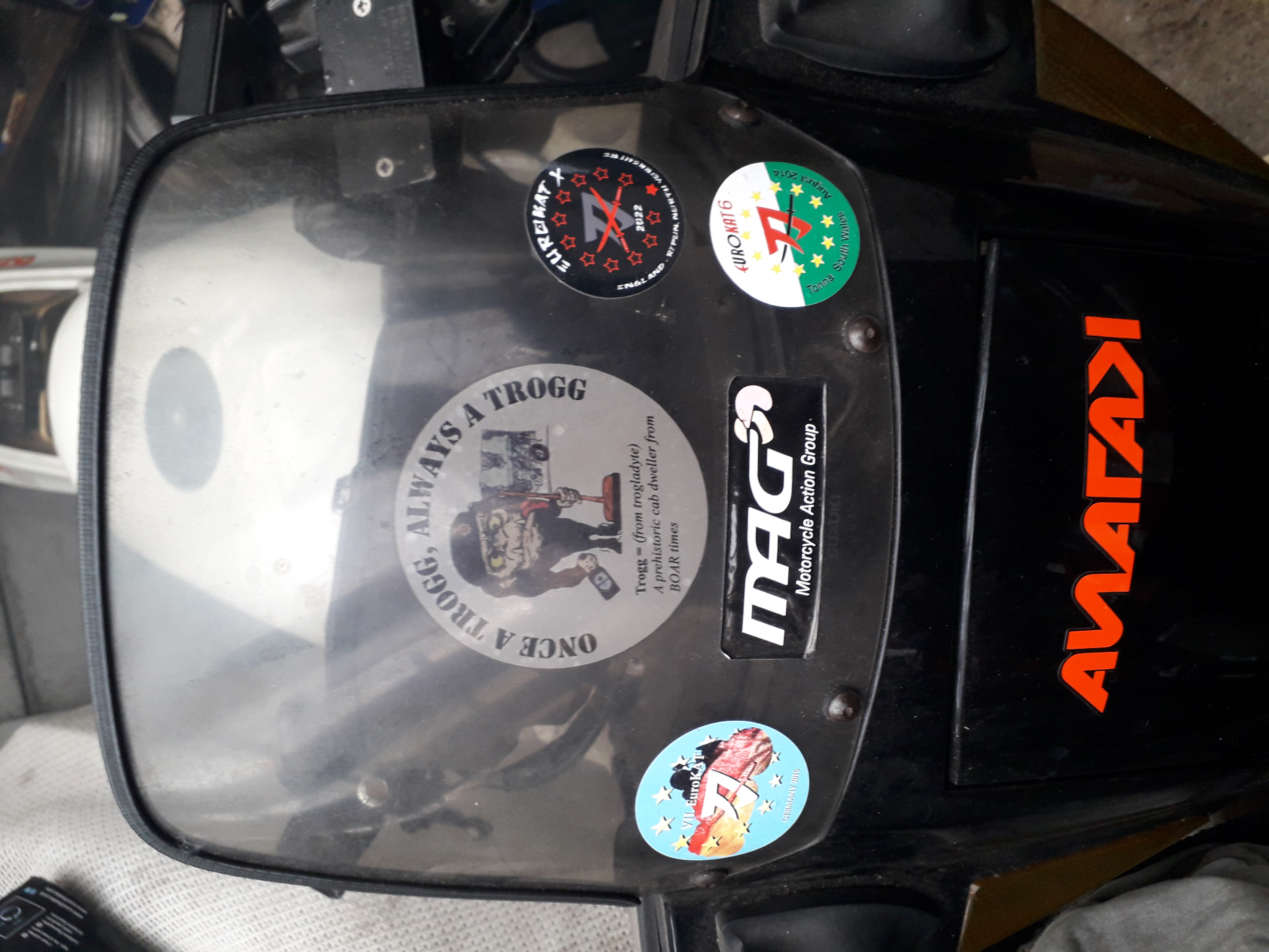

The EK sticker from Ripon shows the last time out ..
