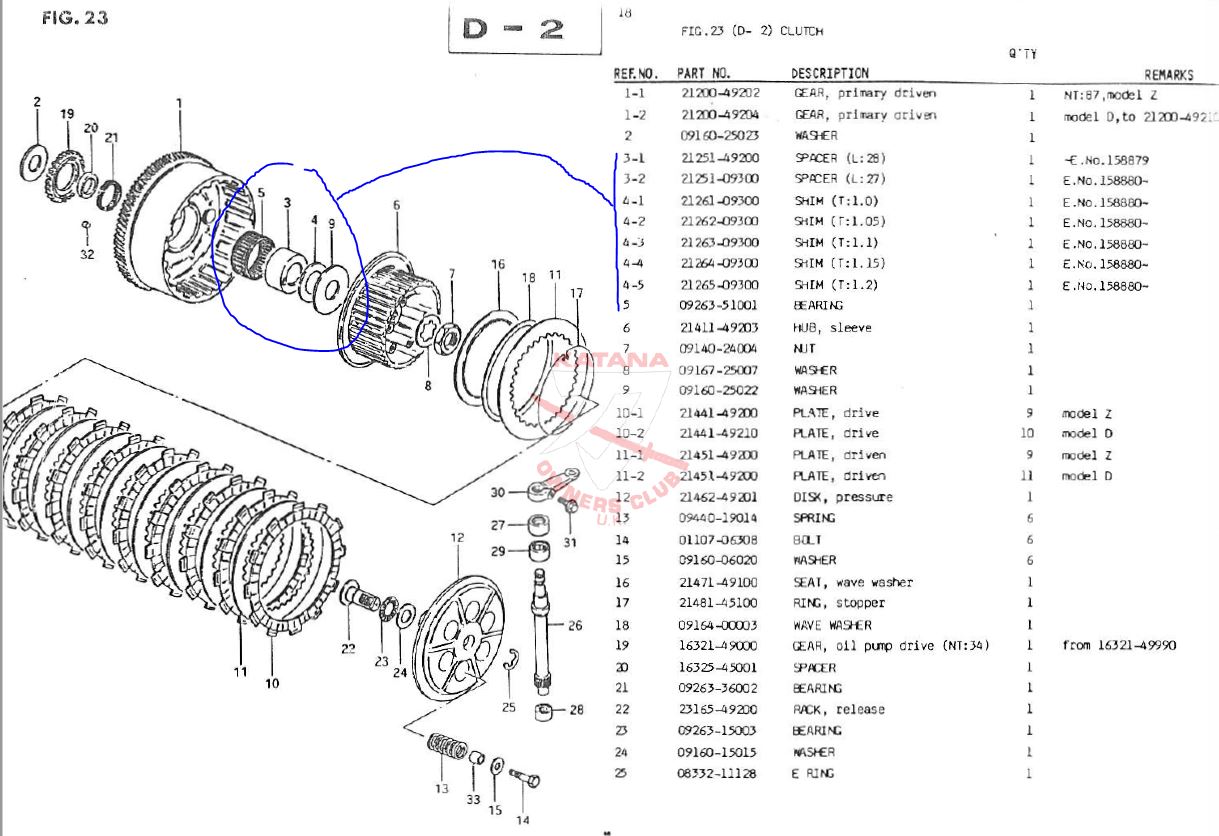

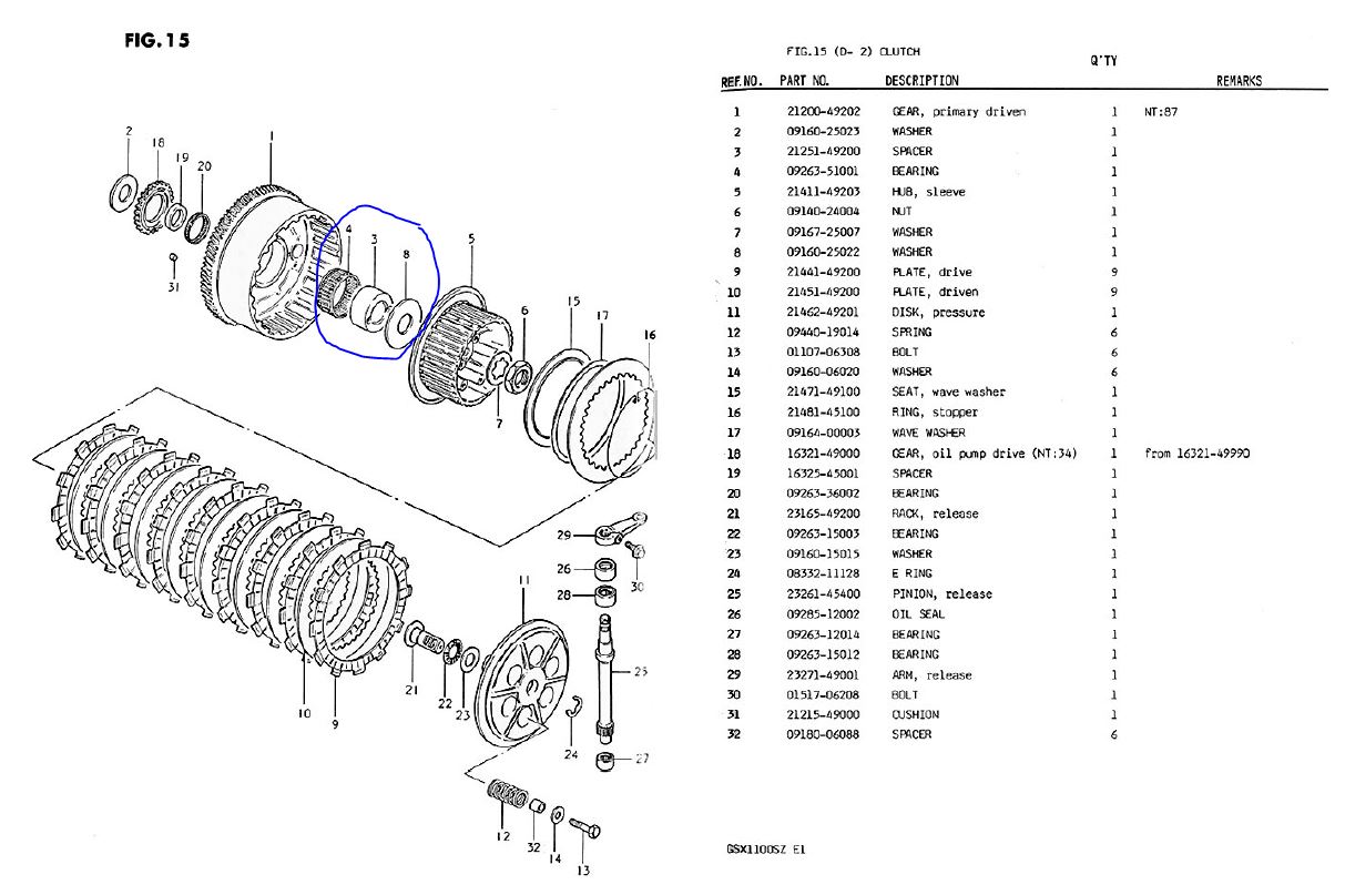

I have 2 parts lists for the 1100 (and early version and later with revised parts as well) which show the clutch differently depending on the engine number:
This is the earlier parts list with only upto engine number 158879 parts shown
and this is the later parts list that shows both options - up to engine number 158879 and after.
In the second you can see part 3 varies depending on which engine you have and that was John's issue - he had the wrong one in for his engine number. You can also see that the later engine number needs shims (item 4) that need to be calculated as well.
Reading your initial post it is possible in a rebuild someone has mixed and matched the clutch parts and hence why you have this issue. I hope so as then you are on the road to having it fixed.
