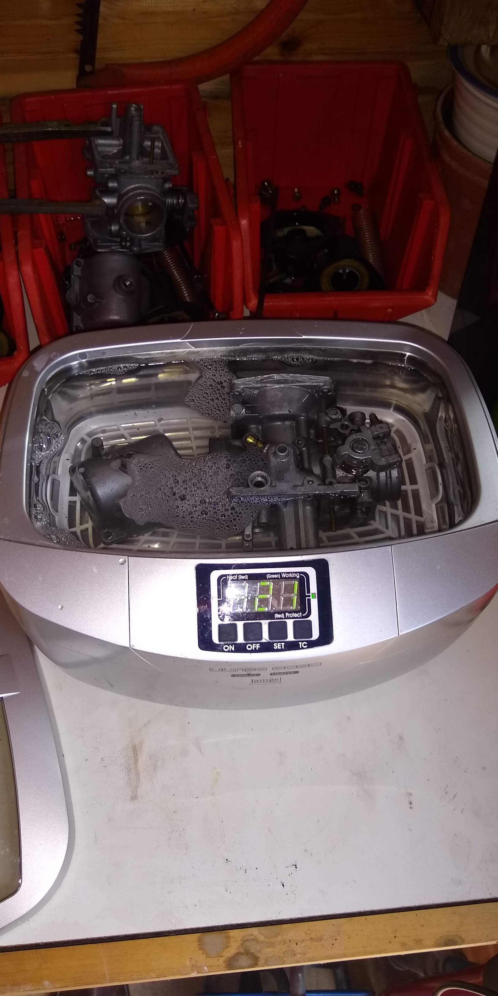

Used this to clean Fred61’s Pop Up carbs earlier this year.
Think it’s a 2500ml version. Got it from Maplin’s a few years ago.

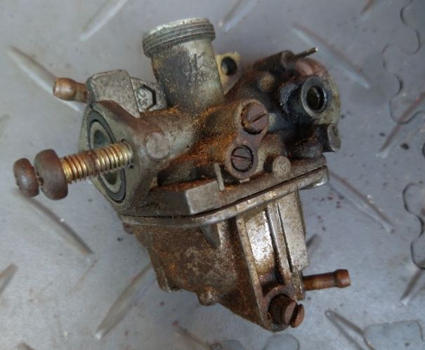

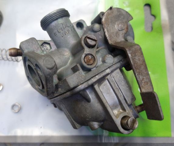

After trying various cleaners some fairly expensive, after a post by Kryten regarding this, I went back to using just washing up liquid and PaulD pitched in with also adding a squirt of lemon juice (not sure if it makes a different but there's some in the fridge and it's a long time to pancake day so why not
I don't tend to use the supplied plastic tray (can see that in Kryten's one above) as it does state this can reduce the cleaning, I just throw everything in and fish out with my hands! I do use a rubber bung in the drain hole at the bottom so nothing goes down there.
Here's a PC50 carb i recently did with just those, before and after - mine does have a heater and I think it was at about 45C. I haven't found anything that makes them shiny or as good on the outside as vapour blasting, but I'm happy with that.
All the jets were fine as well, I do a full stripdown and once done a quick blast with some brake cleaner (see below) then blow out with the airline.
Another thing I have found as a pre-clean if there is residue fuel / gum / varnish) in the carb etc is CRC Gasket Remover (had some for actual gasket removal but gave it a try and it worked well
