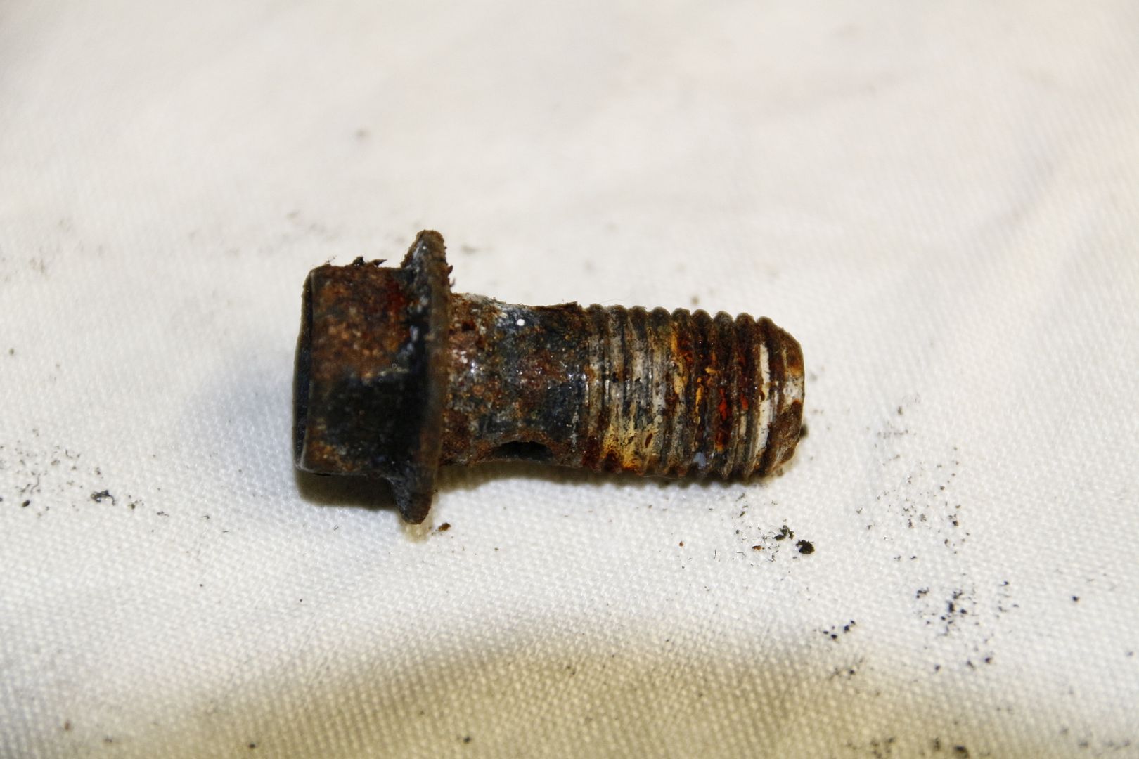

I've done a test with a old very rusty banjo bolt and here are some pics.
Before

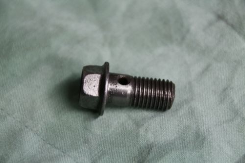

Post by wraith » Sun Nov 08, 2015 5:15 pm
After

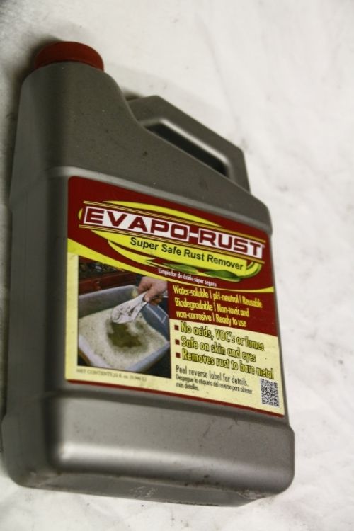

The bottle:
