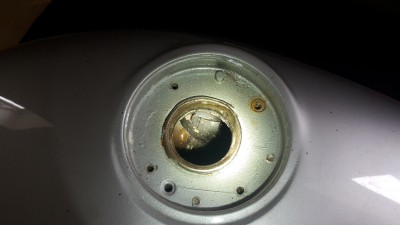

Heinz in Germany went into his garage a few weeks ago, thought he could smell petrol .....on closer inspection there was a pool around his 250.... :? :cry:
The tank was rotten and had failed. It has been repaired and sealed before...a few times to be honest.
We searched yahoo Japan and found a few. But they won't post.....I tried to contact Drew but no response....last I heard he was in hospital.
So there we have it we need a tank and carbs for a 250 SSN. Or someone who has contact with someone in Japan who will arrange postage to my address if it is easier.
For info this was the 250 we built at the Stafford show some years ago from bits. :)
One off the repairs was extreme ....done in Japan we believe
:shock:
The sealer in the tank had just crumbled :roll:

No it really can't be repaired, the repair on the bottom was because the sides were caved in from an accident. Consequently it was sealed with a petrol tank sealant, this reacted with newer petrol and it melted, it was cleaned out as much as possible and a new sealer installed, the tank then rusted at a low point on the seam and the both sealers reacted and turned to a jellified substance.
The tank is on a bike in Germany were Heinz is a welder fabricator for Volkswagen group , he reckons it BLR , ( beyond local repair.)
But if you wish to have ago Harris it can be arranged I'm sure.
