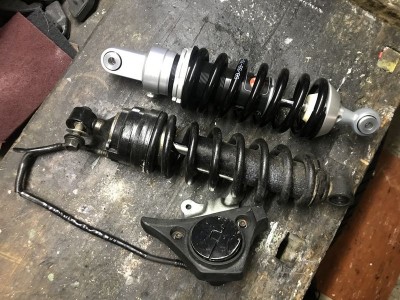

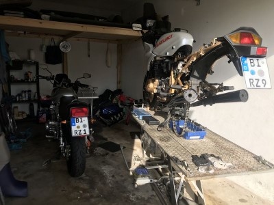

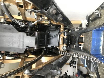

I have started with the disassembly of the old suspension this week. Now the swingarm and some other parts are in my workshop for cleaning and checking ... maybe I will replace some bearing, but we´ll see.
Old vs. New
The adjusting lever will be remounted only for decoration on the bike :D
