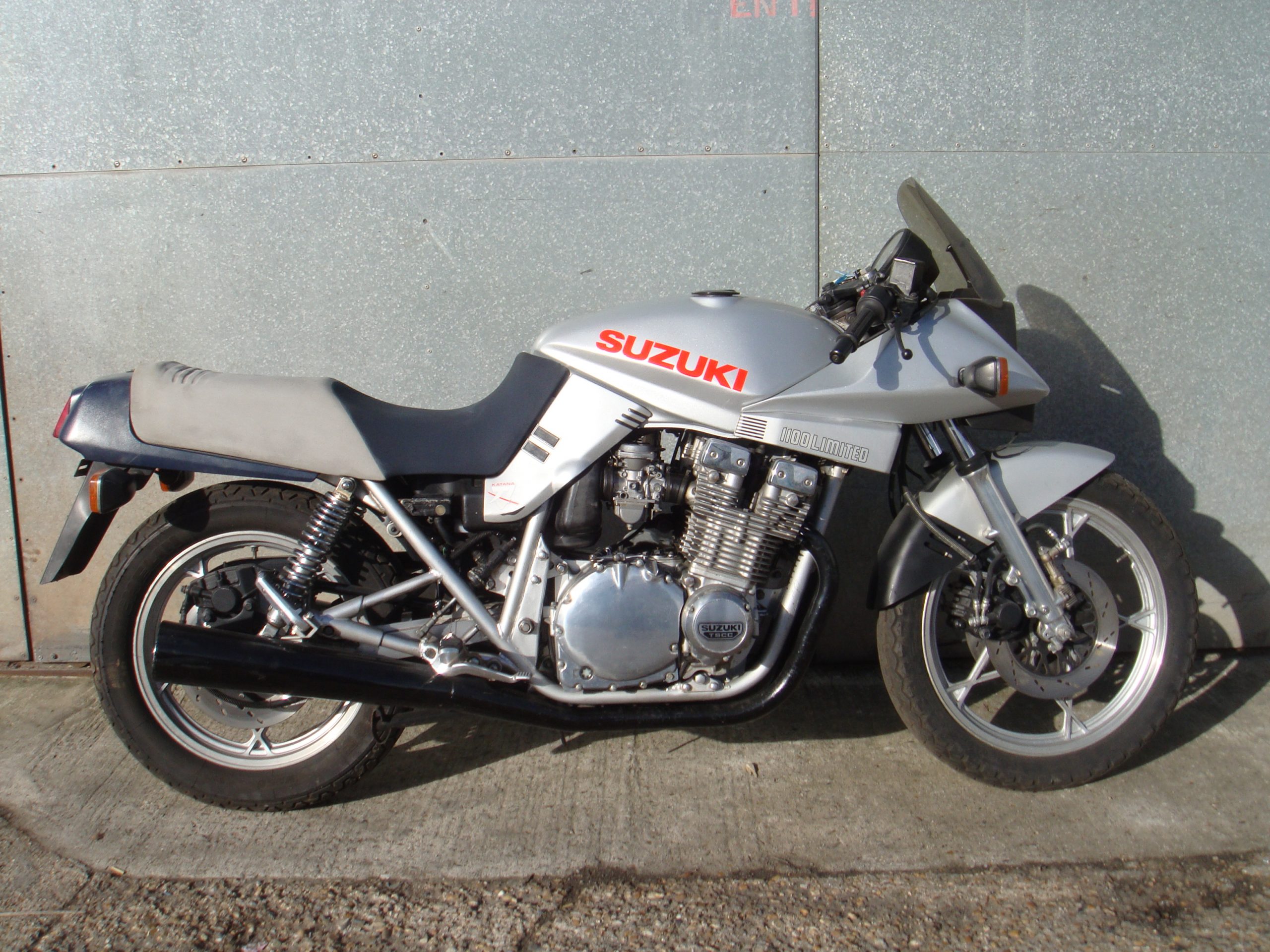

Hi guys - been going round in circles a bit with trying to date my 1100 and establishing the model.
I purchased the bike from a dealer in the UK who had imported it from France. They said it was a 1982 bike but once I looked at the frame and engine numbers (matching the vin plate) I cam to the conclusion that it was an SAE model from 1987 (exactly the same as the SZ 1982 bike apart from black top yoke). I believe this model may have been a Japan only model and it sold in very limited numbers (the French Kat owners club website shows the vin numbers as an SAE). I have been told by the VJMC that after 1980 the bike should have a 17 digit VIN number but mine only has 12 (GS110X-1014**) - the engine also has 12 (GS110X-1742**).
I'm pretty confident it's a 1987 SAE but wondered if anyone can throw some light on the numbers. The bike is all original as far as I can tell and the numbers have definitely not been messed with.
Pictures show bike as I purchased it and before restoration.
