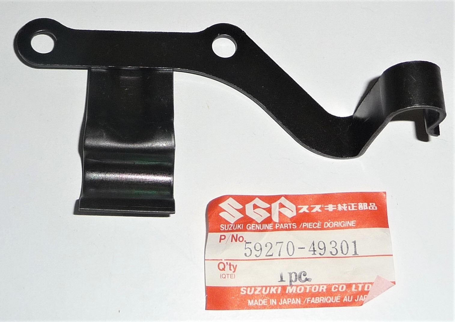

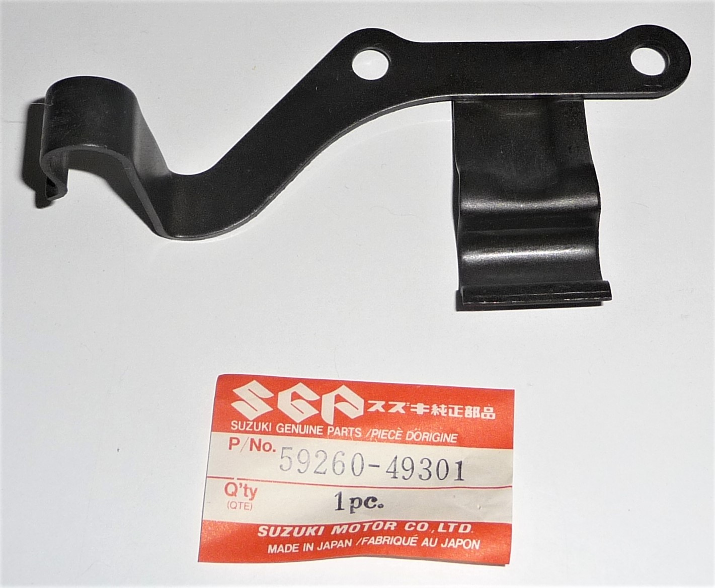

Jonty,
I have those brackets, but I can't find your post that asked for them!
Here's some photo's:

Smallkat wrote:
Sat Sep 24, 2022 10:43 am
Jonty,
They look good, what's your number?
