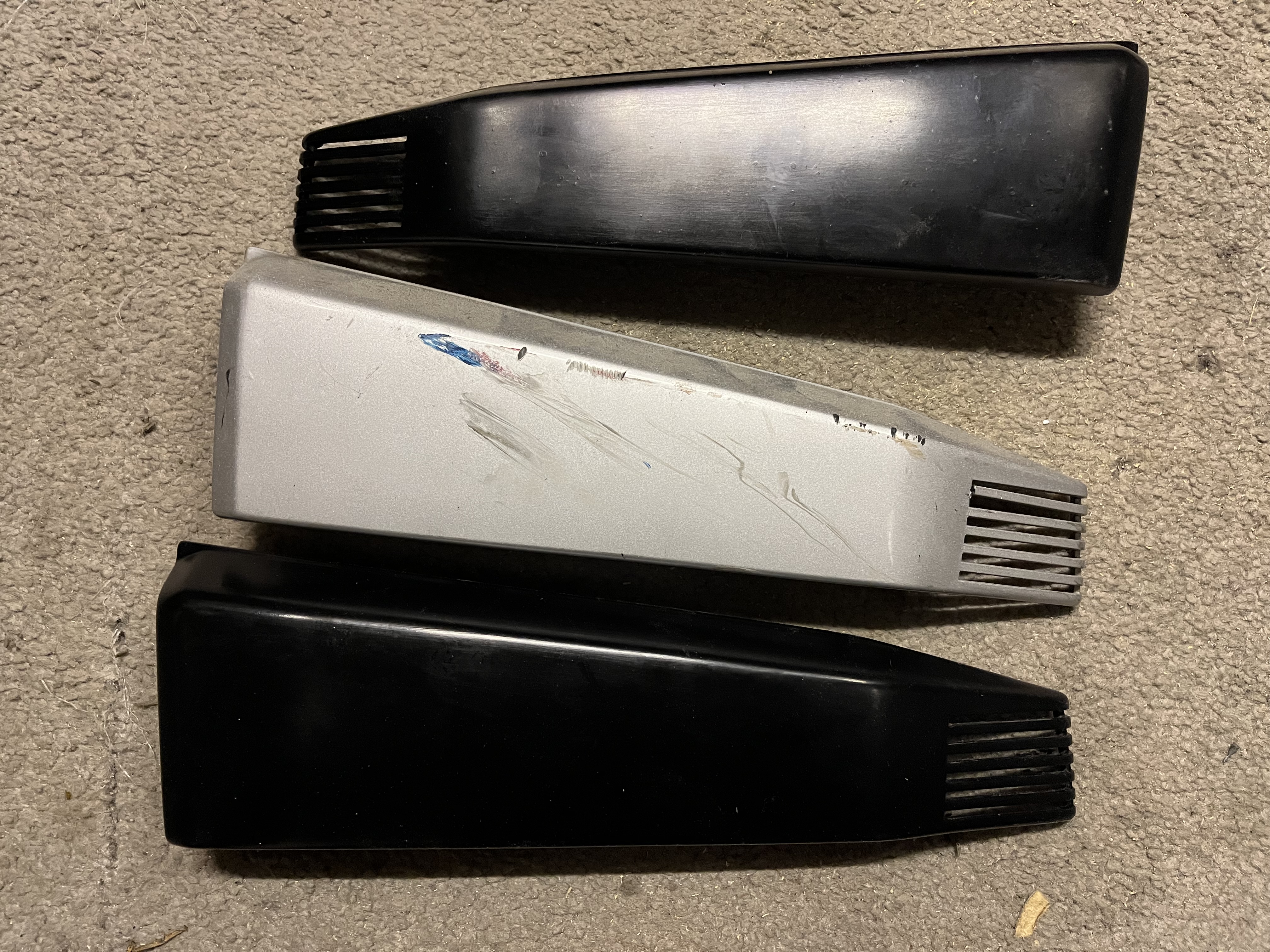

Finally on the bench!! This bike has suffered a damaged rear frame somehow complete with three shattered footrests and plenty more damaged stuff. Oh it’s rough all right!
Re: side lower fairing panels
As I had a smashed RHS fairing lower panel and a scruffy LHS one I spotted on eBay some copied panels from a business seller but wasn’t quite clear for which Katana model. I took a chance as there wasn’t any other available and bought the pair as I think they were just freshly made. If they weren’t the right ones I’d have remake them but today they came and unbelievably they are the perfect size and fit!! The quality is middle of the road as expected but it’s a good base for me to finish them off.

Re: Fixing time!
One of the few parts interchangable between 400/250/1100/750 are these fairing lowers ...The Shark fins also .

Re: Fixing time!
I didn't know that!
You can still get those new from Suzuki then I think (if you are prepared to pay but they will come painted ready in 13L though!)
