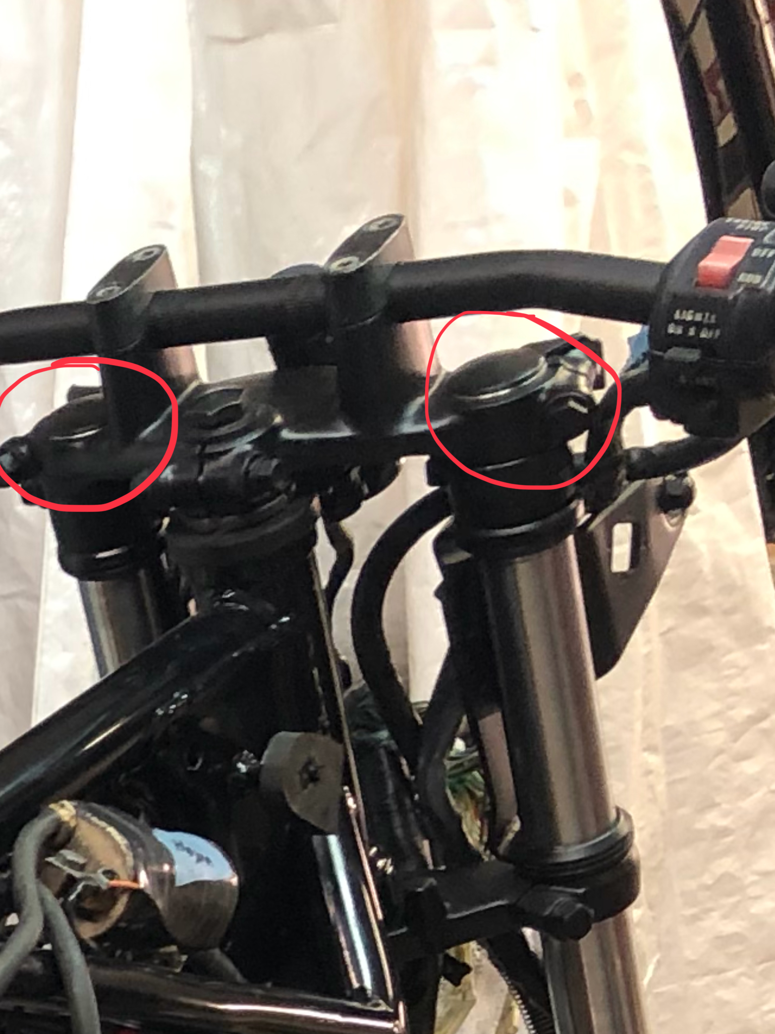

Hi. Does anyone know how i can fil oil on front forks for this bike? :?:

It has no bolt/cap on the top of each fork. :roll:

Thanks a lot. I have to check again.

Post by fossie » Fri Apr 12, 2019 7:55 pm
You have a black rubber top, pop that off, under that is a 19 MM cap , .makes sure you have the adjuster in the middle wound out when putting it back on, it's just easier.

I have this book. And the fork is different on katana. It is no nut under the black plastic cap at the top.

Thanks for replay. It no 19 mm cap under the rubber top :roll:

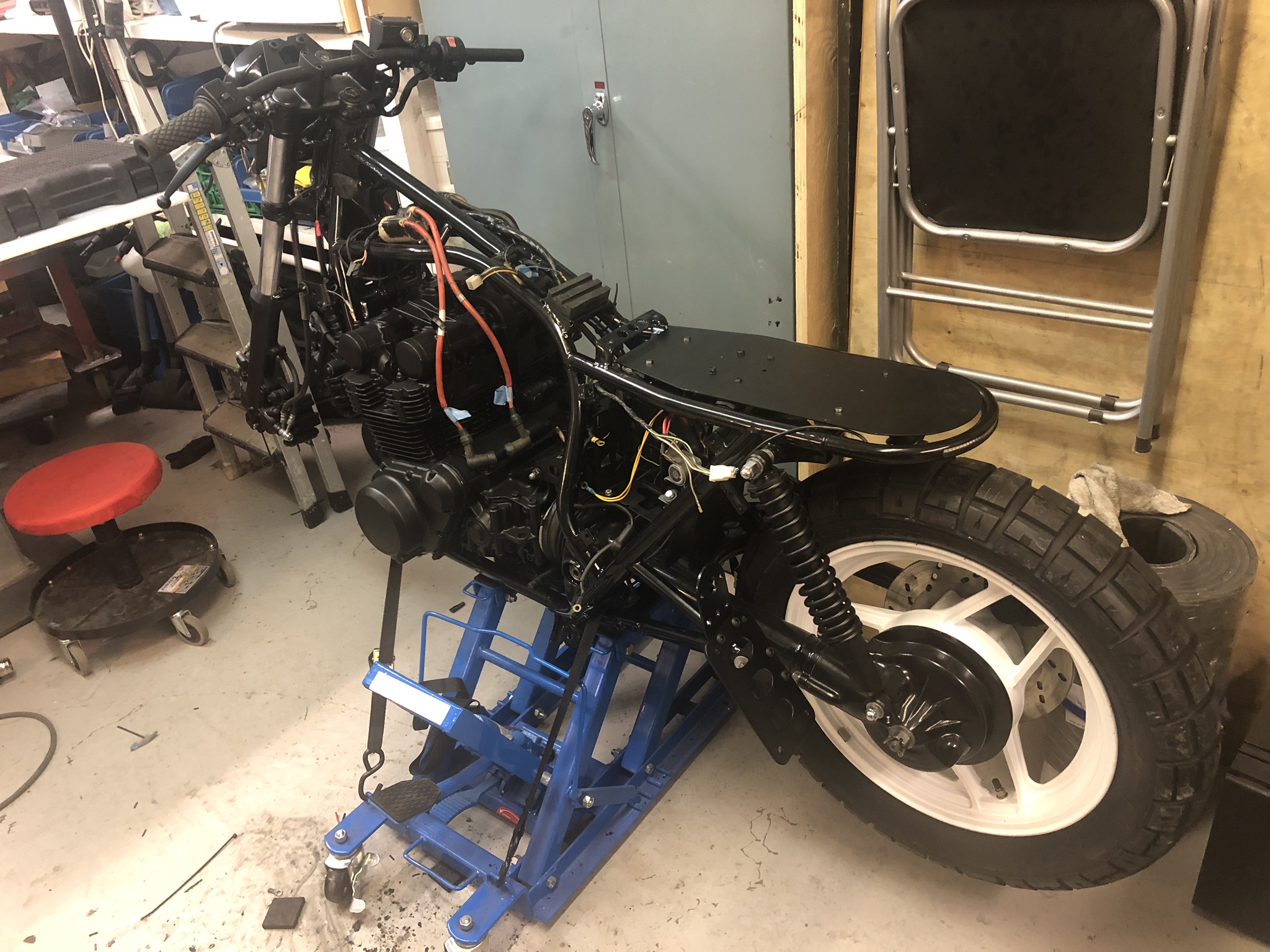

Post by Geiros » Sat Apr 13, 2019 9:19 am
Top front fork
Top front fork
Cafe racer build
Cafe racer build

Post by fossie » Sat Apr 13, 2019 9:45 am
Not sure what these forks are off , they are from a 1983 Suzuki GSX , but the top cap is from an earlier model, but if you undo the clamp next to the top of the fork top, it looks like a cover cap which just prises off. As for amount of oil well that'll be a guesstimating exercise, as like said may not be 650 forks, but the top adjuster is changed.
