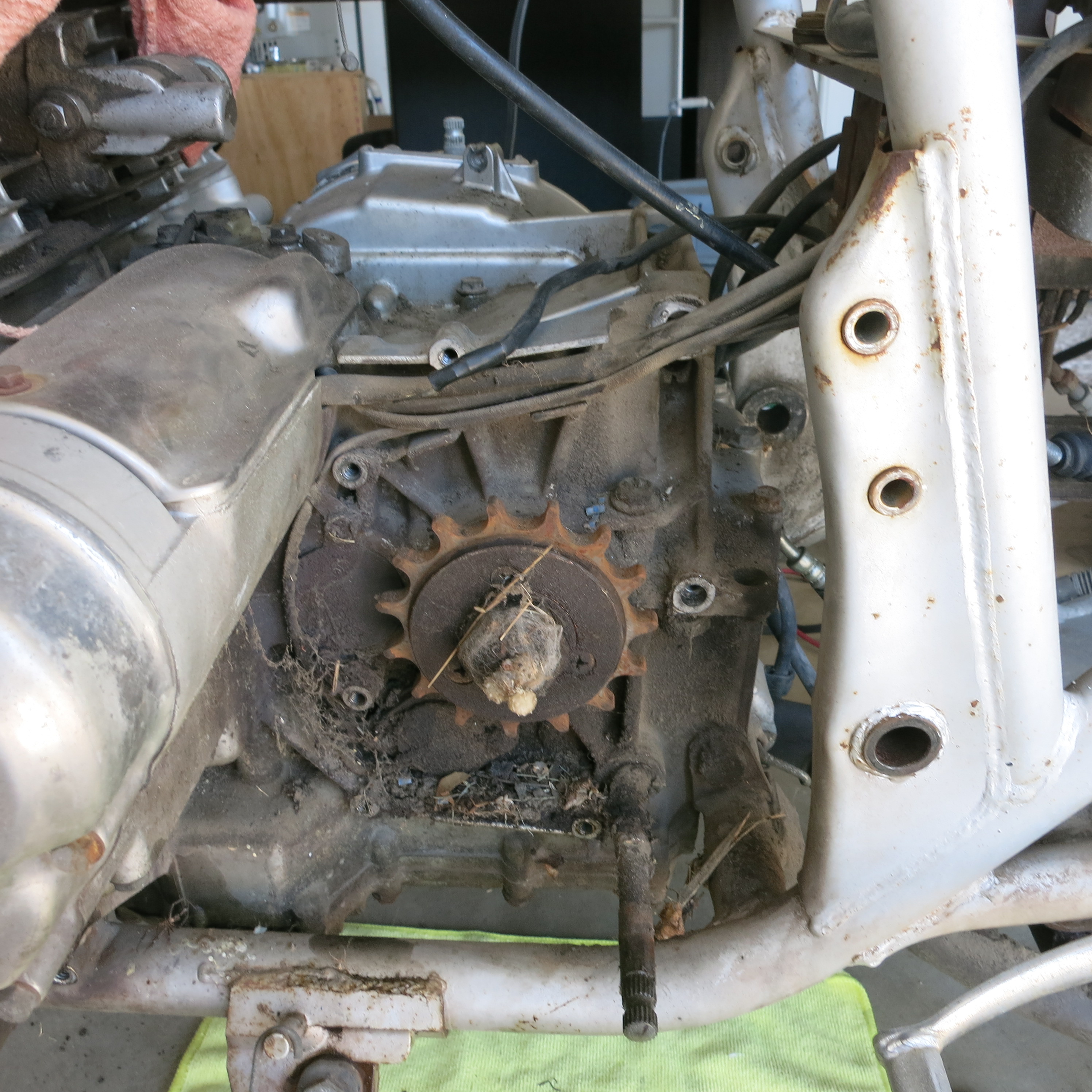

My Kat has 52k (miles) and I'm getting the feeling the pevious owner wasn't much into maintaining this thing.

I doubt it Blix, it's got 50k Miles on the clock. When I took off the chain it had that old clip on master link too.

Post by fossie » Tue Oct 13, 2020 9:03 pm
If not original then a genuine Suzuki replacement.
